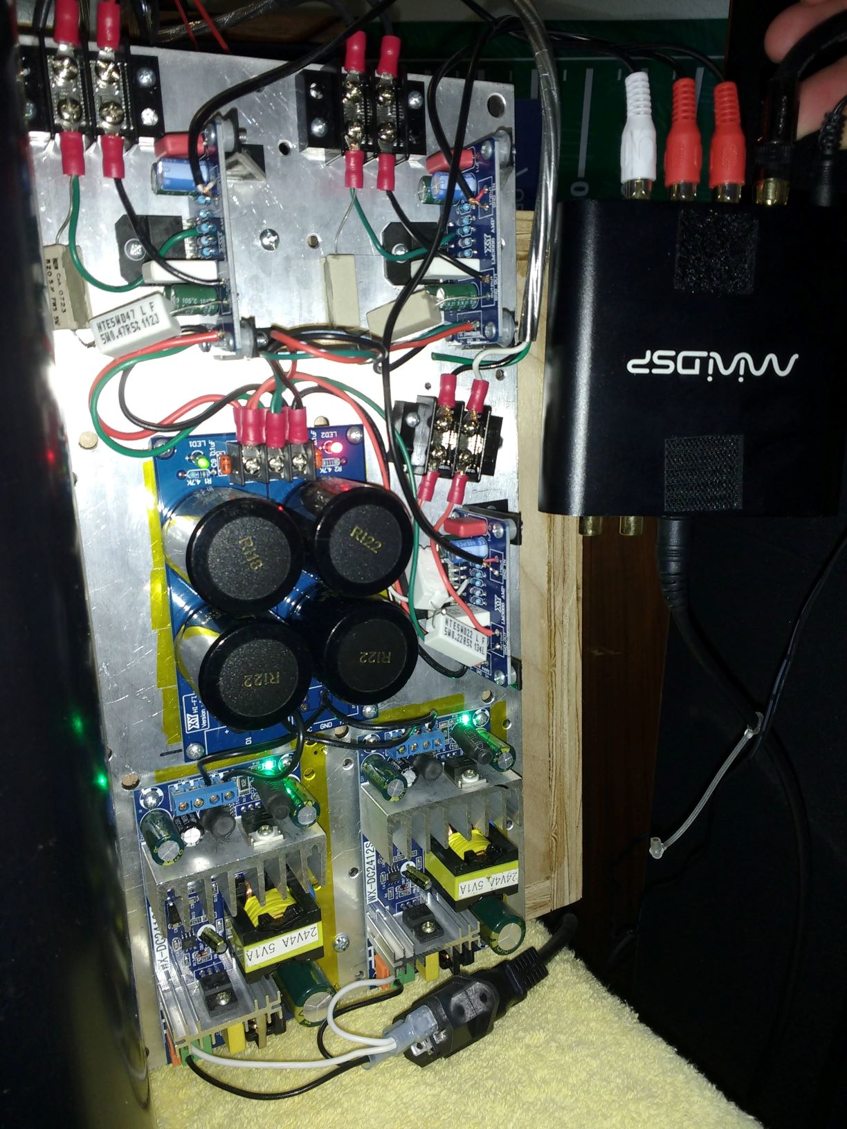

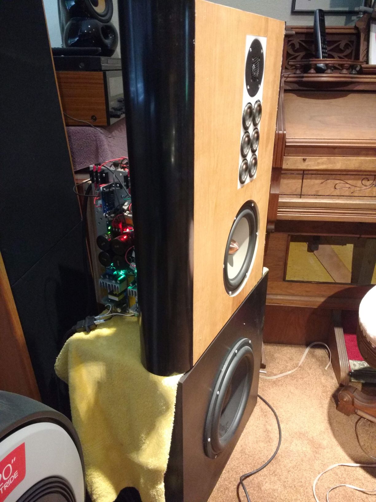

I used two miniDSP 2x4hd boxes for my 4 way speakers. I run optical cable to them. A simple optical 1 in 2 out box was needed. If the amplifier gains are managed properly, there is no noise.
I wanted the amps with the speakers, so I assembled my own plate amps using LM3886 boards and switching power supplies from eBay.
