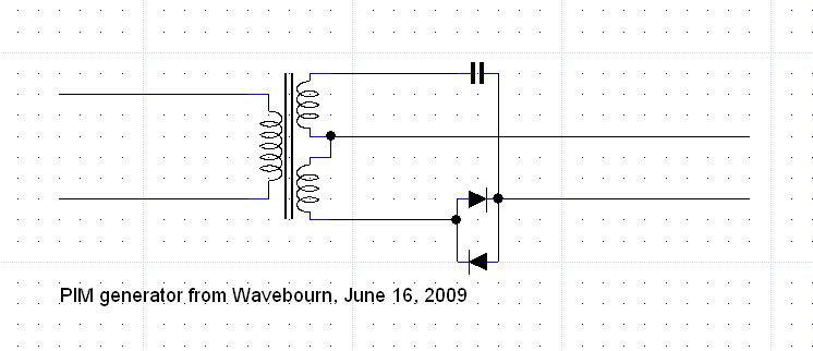

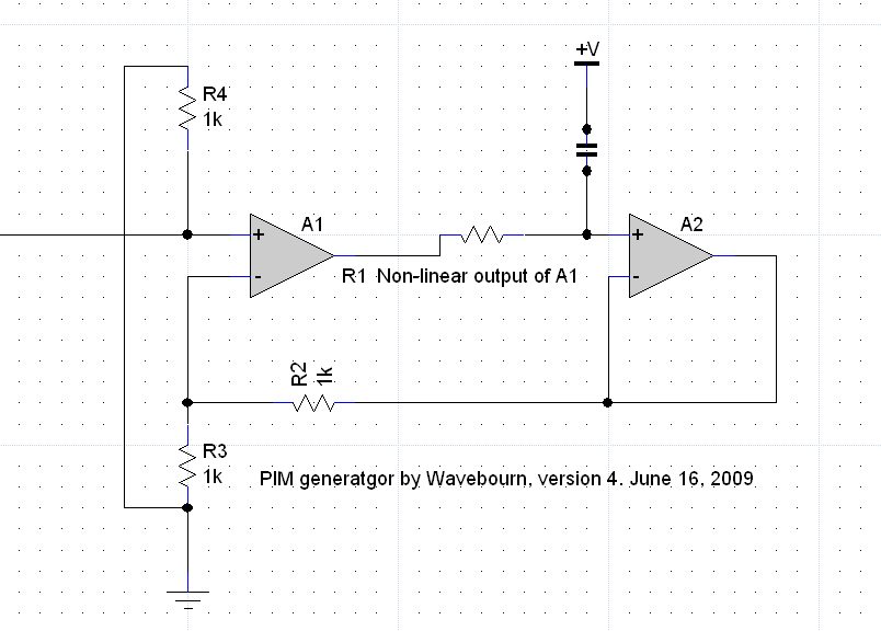

This one is more interesting: very low THD, but very nasty sound.
LOL Great illustration!

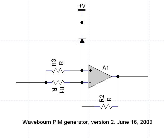

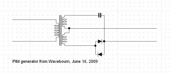

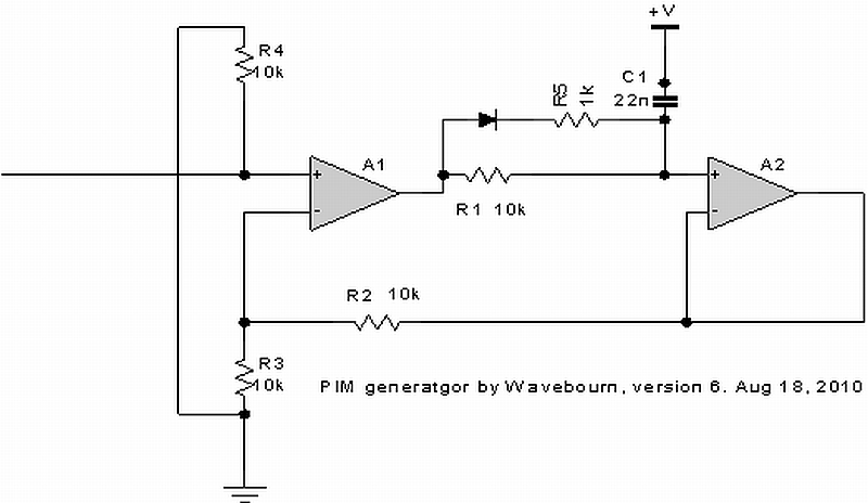

Any time you introduce slew limiting, or more evil, asymmetric slew limiting, inside a feedback loop, of course there is a problem.
The open loop gain bandwidth of the amplifier needs to be greater than the signal bandwidth.
What is the THD near the open loop corner frequency?
It is just an illustration of what happens on more subtle level.
What is bandwidth? It is like a waist line on a dress. You can put it higher, you can put it lower, but if the person does not have a real waist due to body structure it may be anywhere you wish. And you know, no amp has a real waist, only imaginable one! You can set some imaginable limit if your tool allows more precise measurements, or you can say that what your tool can't measure does not matter. Like, does not matter if we hear below noise floor: everything below noise floor according to standard measurement practice does not matter. Even when it is perceivable by human hearing!
So, how to find if the dress has higher waist line that the human that supposed to wear it, if neither dress, nor human being have one? How do you put a waist... sorry, a bandwidth to the signal? And how do you put it on the amp?
So, it illustrates what happens to an amp that has in-band phase shift, and some non-linearity. And it has, you know! Linearizing the amp with feedback you turn linear phase shift to non-linear one, modulated by the signal. Now you can measure say -180 decibel of total sum of harmonics, but the amp will sound nasty...
...and people who like to read smart literature in order to get smarter would have a very simple explanation: "You guys don't like clean non-distorted sound! You like sound of your tubes because they add euphoric distortions!" 😀
I guess by people you mean me, as I'm people 😉 I meant that it goes round and round.
It must go round and round because it's fed back, in a loop. The output is fed back (hence the term feedback!) into the input. If you can detect that feedback is in use then it must be changing the output, which in turn gets fed back to the input. From there it works its way through that amp to the output and gets fed back to the input. And round and round it goes.
OK you say, but each time around the feedback artifacts get much quieter so it doesn't travel round and round for long. Well yes and no, it will travel round until you hit the noise floor deep enough to be dissipated. How audible it is on say the 3rd time around will depend on factors of course.
In theory I guess it doesn't go round and round. But in that theory I think you also have a linear amplifier with zero time delay. As soon as you look at a real non-linear amp with a time delay between the input and the output that theory becomes junk.
The non-linearities will give you the multiplication of harmonics, the time delay will give you phase shifts that vary with frequency. Negative feedback is all about correcting the input signal by comparing it to the output signal. When the output signal is for instance travelling through the amp you cannot compare it properly because it is delayed in time.

I'd like to see some measurements and scope shots of the feedback error cycling through a well designed amplifier under normal operating conditions and decaying out over tens of microseconds.
This whole take on feedback assumes that the propagation delay is significant in the audio band and this is only true IME for amplifiers which are band-limited relative to the signals they pass.
TIM distortion is real, as I have known since the early 1980s when I discussed the matter with Susumu Takahashi, a Sansui engineer who characterized the problem in terms of slew limiting. But it is not induced solely by feedback. It is caused by trying to use feedback to correct a bandlimited amplifier.
Wavebourne's circuits illustrate the problem. However, if the flat-gain passband of the amplifier in open loop is some small multiple of the band-limited audio passing through it, the delay-induced IM distortion should not be a problem.
I guess I take exception to the notion that delay is always a problem and all feedback is bad. If the amplifier has enough bandwidth, the feedback signal will keep up because the audio signal from the program source can only slew so fast. Please read the literature on TIM distortion from Otala and Takahashi for a rigorous treatment.
I also allow that an OPT with a group delay longer than a few microseconds would likely be a candidate for causing TIM problems inside a NFB loop.
The harmonic multiplication effect is also real but another matter with different effects.

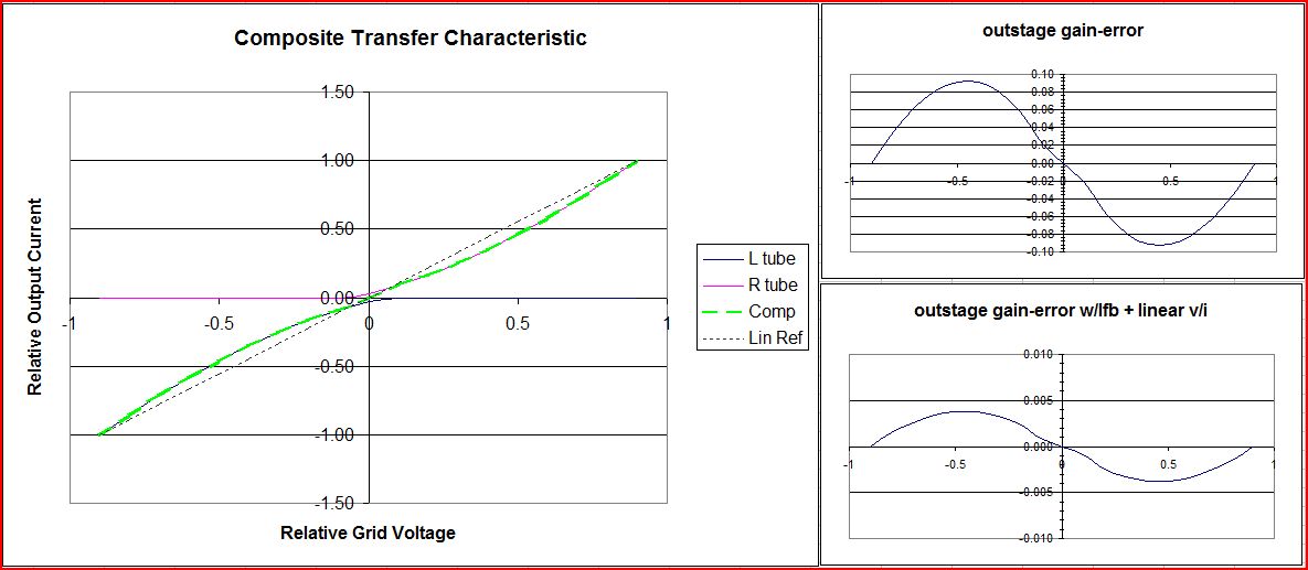

The gain curves I've seen published show a wiggly line - there is no perfect cross-over with typical active devices. There was a design that did achieve a remarkable level of matching between the two P-P devices, I can't remember where it was but it was something to do with operating MOSFETs with a square-law transfer curve.
Kean - do you know about this ?
You are right that there is no perfect crossover, but there are optimal ways to do it.
I haven't messed with MOSFETs. I've heard the SPICE models don't simulate them correctly, so I'm reluctant to simulate. I have heard however that some FET-type device gets better crossover than BJT's.
- keantoken

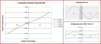

To study crossover distortion, I made a simple spreadsheet model using 3/2 power curves to build a composite curve.
I believe the desired gm behavior is: at crossover the composite gm should be the same as one device just as the opposite device cuts off. Obviously this is true for class B.
I couldn't find a spot in AB with a smooth composite curve. Luckily, real tubes don't follow this exactly and some seem to match better through the crossover curve. It's hard to get the wiggles out...
But, it's a really simple model just to play with. I wouldn't even trust SPICE VT models to be good enough to nail this. I was simply hoping to gain some more insight.
PS Note that the error curves are referenced to the "ends" of the fransfer function i.e. the error is relative to a straight line connecting the full signal endpoints and bisecting the idle point.
