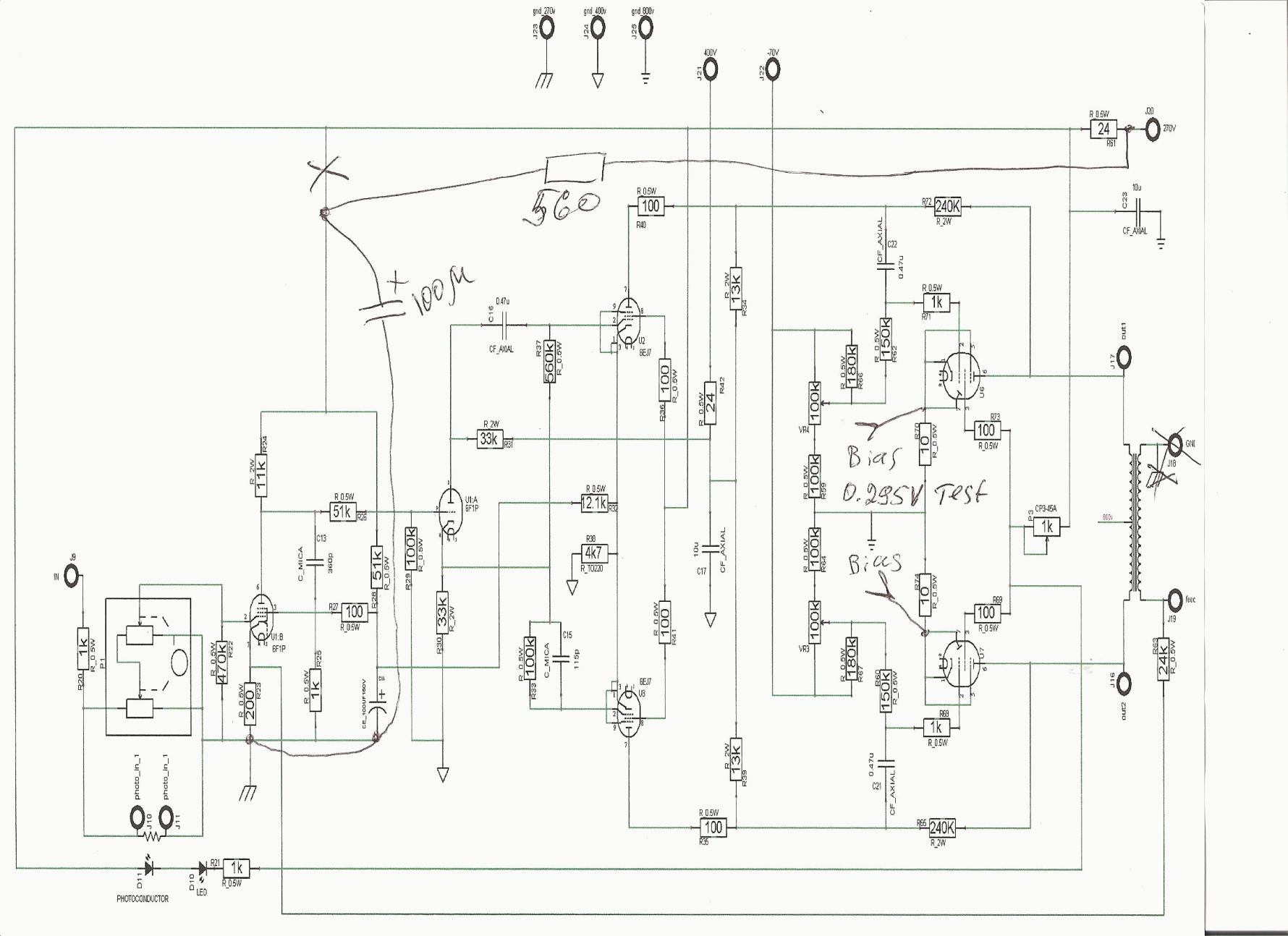

Here is an output stage:
http://wavebourn.com/forum/download.php?id=462&f=7
and here is a driver, global feedback goes to cathode of the 1'st pentode through 24K resistor from 8 Ohm output:
http://wavebourn.com/forum/download.php?id=460&f=7

To Wavebourn: Can you clarify the output stage diagram a bit? You have feedback going back to the top and bottom inputs, both of which are labeled Input 1, and both of which I assume are hot, not ground. Is that a typo?
And in the driver schematic, where is the 8 ohm output that the feedback originates from?
Thanks; it is a typo: I just copied and pasted. Of course, inputs of the power output stage are connected to outputs (between anode stopper and anode load resistors) of driver tubes.
Output tubes are ГУ-50
8 ohm output originates, of course, from transformer secondary!

Are the driver stage and output stage schematics part of the same amplifier? If so, I am trying to figure out where they are connected together.
Right 2 tubes are called driver tubes, they drive output stage. Top horizontal plates in that tubes on the picture are called anodes. Vertical bricks that are right above them are anode stoppers. Above anode stoppers are bricks that are called anode load resistors.
Got it?
