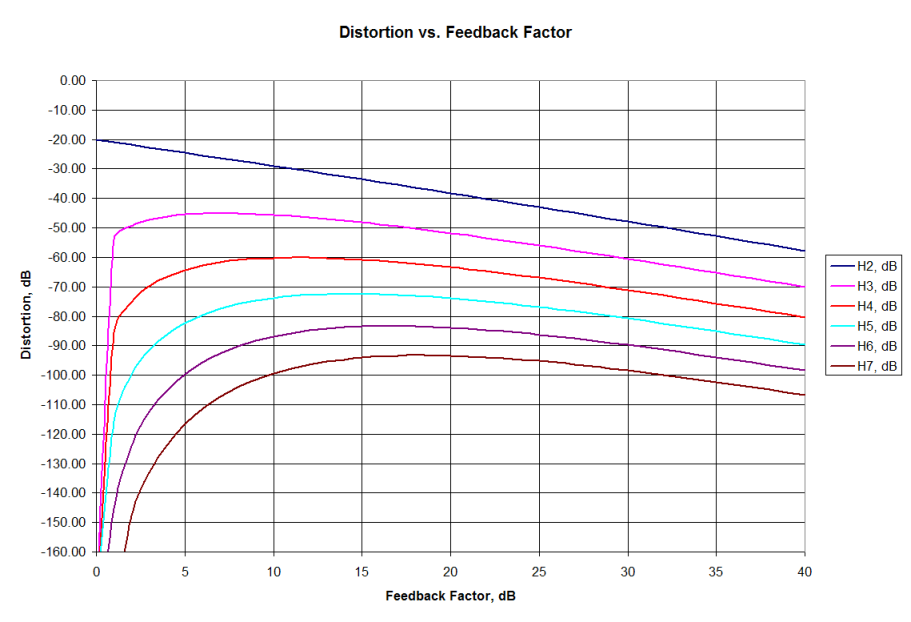

Here you go: this graph was posted here on the forum; I saved it just in case, to show in conversation: sometimes it is better to see once than calculate many times.
The graph shows what happen when you correct 10% of 2'nd order only error by feedback.
What kind of circuit is that graph from?

This graph is from an ideal circuit from some rose reality that has no other artifacts than 10% of 2'nd order harmonic. The real life is much dirtier, of course!
Do you have the model?
I don't see how a circuit producing only even harmonics can produce odd harmonics when given feedback.

The feedback contains both fundamental and 2nd harmonic. The second-order distortion in the amplifier forward path then creates some 3rd by combining 1st and 2nd, etc, etc, etc. You get an infinite number of products!
For those into maths (a minority, I know!) this is related to the infinite series:
1/(1+x) = 1 -x +x^2 -x^3 +x^4 . . .
Something like this appears if you put an amplifier with some second-order distortion in the normal formula for gain with feedback.
As Wavebourn's graph shows, if you are going to add any feedback you need to add enough to depress the products you have just created. In reality its not quite as bad as that, as the devices will already have some high-order products anyway. How come we can make any amp sound reasonable? Two things on our side:
1. for small signals the inherent distortion is much less than 10%, so the extra distortion is much less too and it gets better with higher order. If you can halve your 2nd-order by better design, then the 3rd will be down to a quarter etc.
2. triodes have unusual feedback, because in an ideal triode the feedback has the same distortion as the forward path so it exactly cancels. Unfortunately you can't buy an ideal triode but some are quite good when used with a high impedance load.

Out= K1(In+(In^2)/K2) -- it is obvious!
with no feedback.
