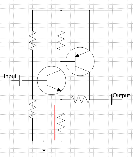

Here is the completed diagram, local negative feedback, solid-state circuit.
Actually, it is both local and global; 2 feedbacks, strictly speaking. One is formed by a resistor in emitter, and second is formed by a voltage divider that is at the same time load of an output transistor.
It is slightly more complicated than that. The local feedback comes from the parallel arrangement of 'emitter resistor' with the 'feedback resistor' in series with whatever the load is. This lets you calculate the open loop gain (i.e. just with local feedback), then you can add the global feedback from the second transistor. I suppose what is 'local' and 'global' depends on what you mean by 'stage'.
Well, could it be said that the red lines indicate the local feedback portion of the circuit? And is there a way you could download my diagram and add, say, green lines to show the global portion of the feedback?
It is slightly even more complicated, if to consider internal properties of transistors. 🙂
Local means within a single active device; global means around a whole amplifier that contains more than one active device.
Adding extra coloured lines to a circuit could create confusion. In this case the red and green lines would have to be in the same place! Both 'local' and 'global' feedback involve both resistors. Strictly speaking, as Wavebourn has said, you have to include the internal impedances of the transistors too.
If you find the lines helpful, fine, but there is a danger that you could end up misleading yourself.

Wavebourn et al,
I find it confusing with all this talk about current feedback. For me, it makes things more confusing than I think they should be. Perhaps it would be nice if beginners could avoid learning this way ??
Active devices (transistors, tubes) are Voltage controlled devices. You apply a voltage between their control terminals (base-emitter, grid-cathode) in order to modulate the current flowing through them (collector-emitter, plate-cathode). Feedback and the Signal are both voltages. You can use a resistor to convert current flow (including current flowing through the amplifier load) into a voltage and in this manner I'd agree that the feedback signal is a measure of the current, but what is being fed-back is a voltage signal. When you think this way, you are careful to ensure you know what you are feeding back and why.

If it senses output current, feedback signal will be proportional to output current. If it senses output voltage, it will be proportional to output voltage.
There are no voltage or current devices, only impedance devices. The former approach works for block diagrams, but for actual circuits high performance depends on the details. All real amplifiers are impedance drive, just more voltage than current or vice versa.

This is OT for this thread but I'll finish my thought here: when you think of a transistor as current controlled from a high source impedance you are simply bringing into the equation the resistance (external to the device) through which the current must flow in order to generate the control voltage. It's still a voltage that is controlling the active device (heck, just look at the math)
So back to global negative feedback. In my logic, the signal controls the current flow through the output devices of the amplifier and since it must flow in loops we notice that it flows through the output devices (including any cathode resistor bypass caps on tubes), the psu (mostly the caps) and the load. With a low impedance psu there should hopefully be negligible voltage drop across the psu and so it is the voltage drop across the load that determines the voltage signal at the output of the amplifier. This is the signal that is fed back to the input to achieve global negative feedback. If the load is non-linear (e.g. reactive voice-coil) then the feedback will include the effects of the load and this is a whole 'nother topic. You can put a resistor into the circuit to sense the output current, but this still results in a voltage being fed back. Signals are always a voltage, currents always flow in loops.
No, yes. The second part of your statement is guaranteed by conservation of charge, which is fundamental physics. The first part of your statement is simply untrue. Signals are sometimes voltages, sometimes currents, sometimes power, sometimes fields. Don't forget that potential (i.e. voltage) is strictly only defined for situations in which there are no changing magnetic fields, so it is less fundamental than current. Engineers, and audiophiles, ought to learn more about Maxwell's equations.Signals are always a voltage, currents always flow in loops.
Whether the signal controls the current or voltage at the output depends primarily on the type of output stage. The feedback signal which is sent back is often a voltage, but it could be a current. The inverting opamp circuit senses the output voltage, and then sends a feedback current. Internally, a triode senses the anode voltage but feeds this back as an electric field - neither current or voltage! The Miller effect is caused by current fed back through the grid-anode capacitance.
