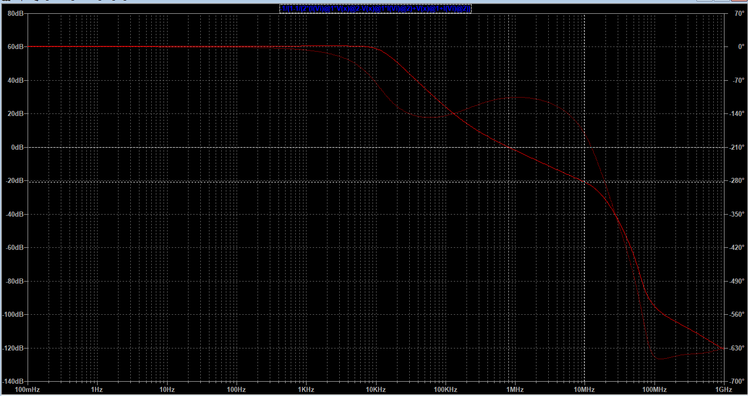

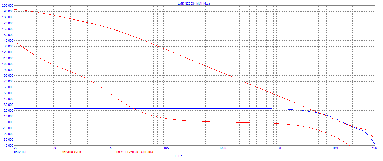

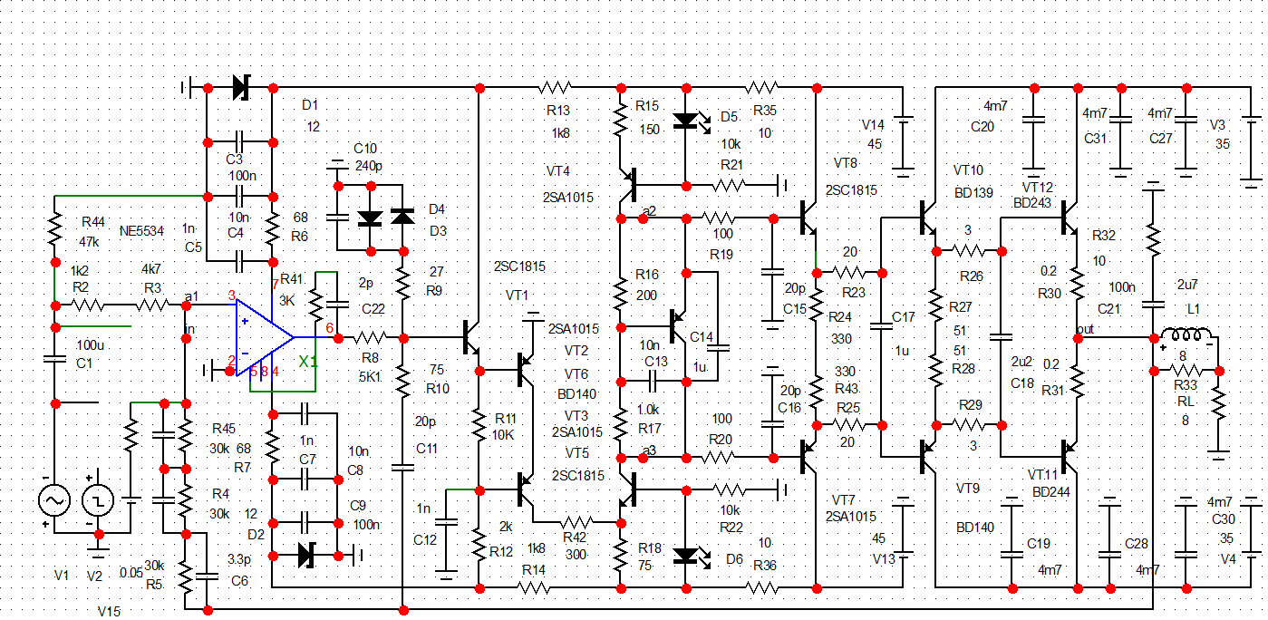

And how much you need to strengthen with the help of an open General OOS . 80 dB? 100 dB or 130 dB at a frequency of 20 kHz ?so good or little gain ?

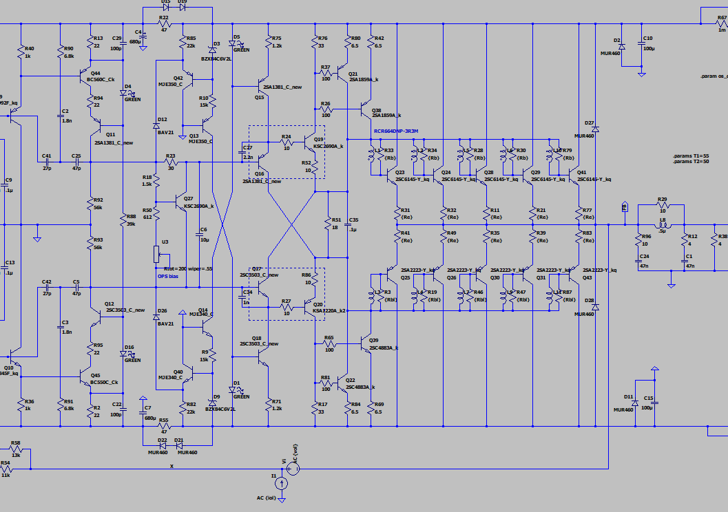

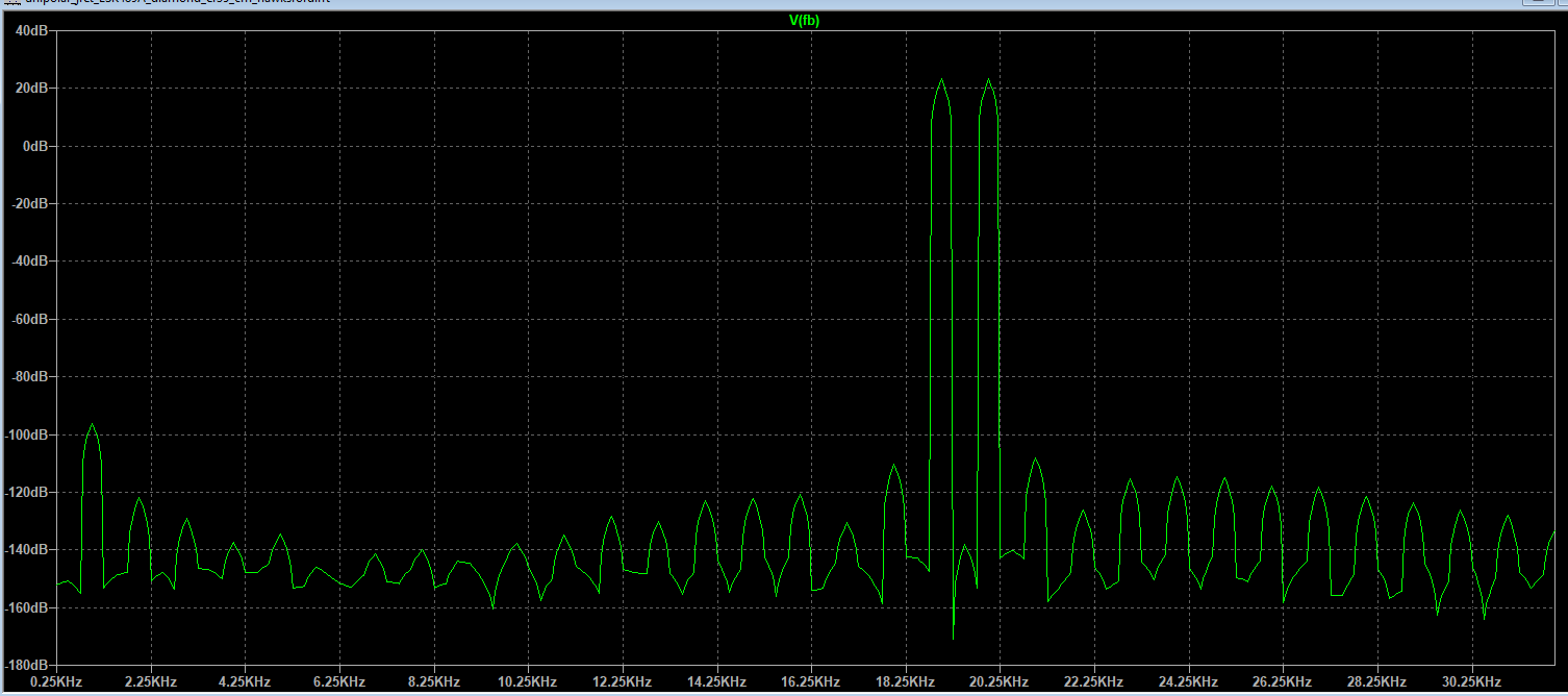

I think that will depend on the design. If you are using a diamond quad (and can make it work) you can probably get away with 50 dB loop gain or so at 20 kHz and still have distortion under 0.001% at 20 kHz. Both the IPS and VAS can be built with local feedback in which case you won't need a huge amount of loop gain, 50 to 60 dB will suffice. With triple output, you're looking at a 20 dB increase in output stage switching distortion, at least in my sims.
Here is the CCIF 19+20k IMD at 80 Vpp into 4 ohms, and loop gain plot. I cut off the IPS from the amp image since it is based on Figure 7.13 in Bob Cordell's book, not sure if I'm allowed to post it here.
