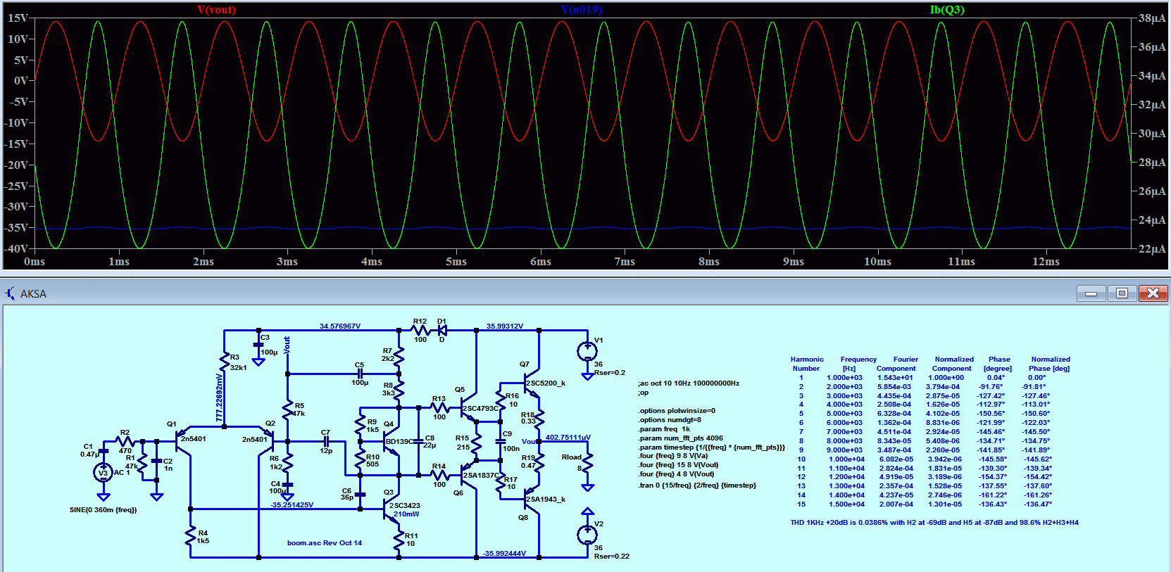

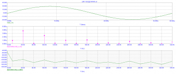

I ran some sims on a conventional, Self AB and found that with a power supply of 36V, 1KHz input of 360mVp and 14.14Vp output into 8R there were some interesting results.
With a video transistor as VAS (C3423) and usual common emitter configuration the drive is a combination of both voltage and current, see attached.

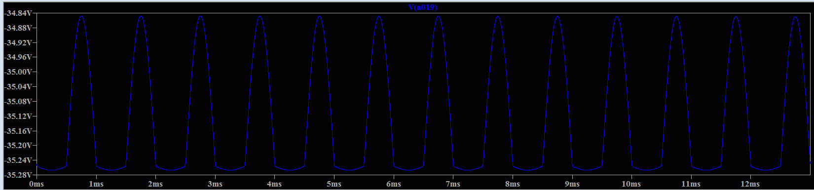

Red is the output voltage waveform (+20dB into 8R 1KHz), green is the current variation at the base of the VAS, and dark blue which is the voltage variation at the base of the VAS and very small, as you suggest. I have attached that waveform for the VAS voltage and it is far from linear; it is clear the negative feedback is working well to make this amp pretty linear.
If you examine the current range at this output it is 22uA to 38uA - VERY small, and the voltage changes are 425mV - from -35.268V to -34.846V.
With such drive voltages and currents, reflecting the complex math of the base/collector transfer, you would expect noise. The only way to improve these results and BTW improve speed by reducing parasitics, would be to drive the VAS at the emitter in grounded base. But that is very low impedance, high drive, and not always easy to arrange.

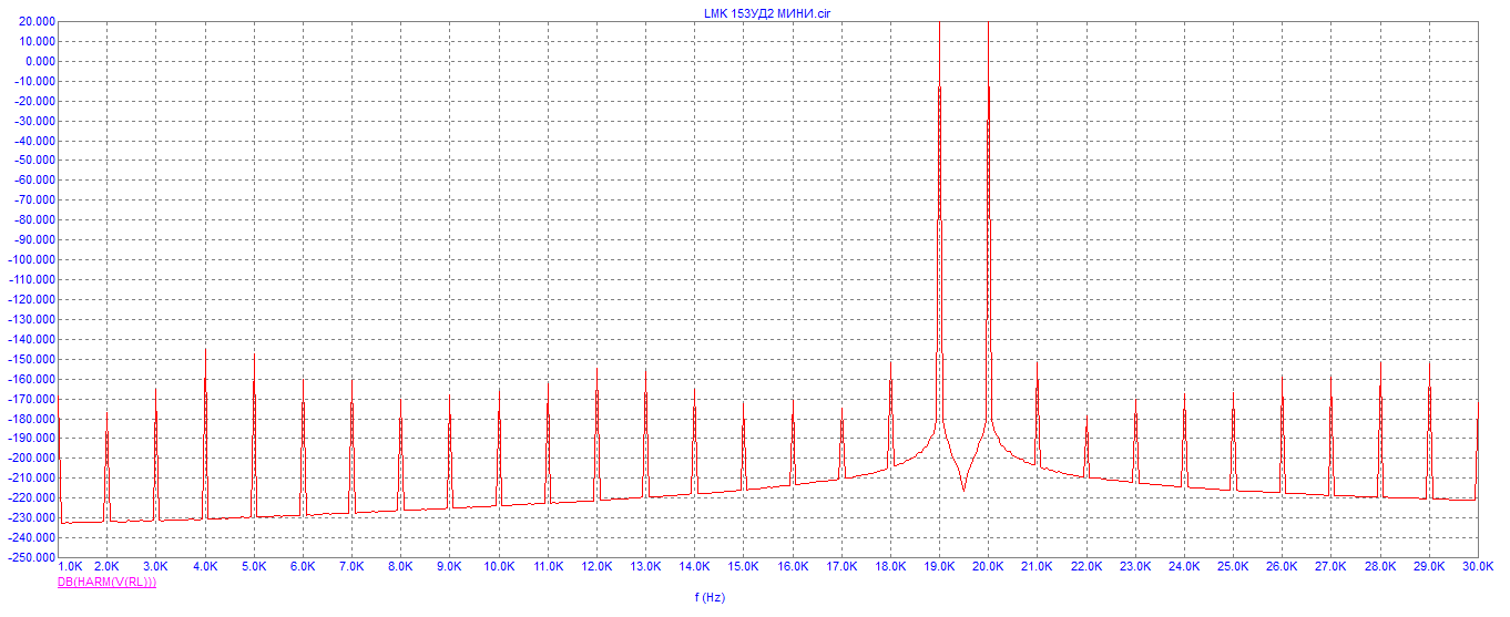

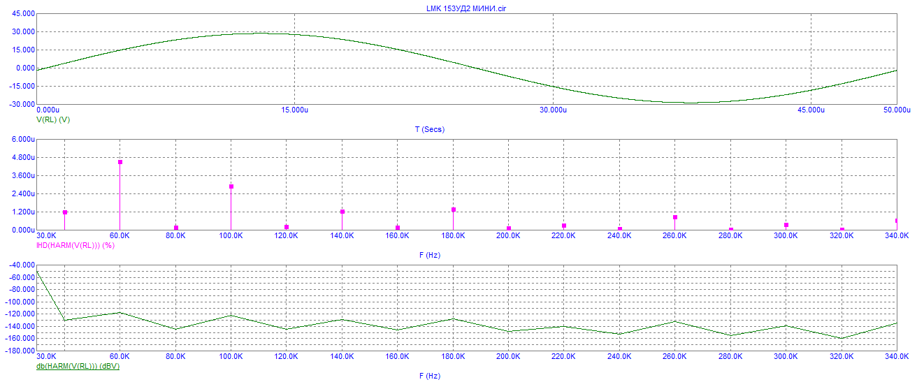

19/20 kHz IMD .Instead of the ne5534 should LM101/153UD2. Broken-chain OOS gain 100 dB at 20 kHz
At over 10 MHz unity loop gain that's going to be a challenging layout.
Also you want to simulate loop gain with different DC offsets. Pick a DC offset that causes the output stage to conduct around 1 to 2 amps into the load. Then do a loop gain plot and check gain margin.

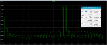

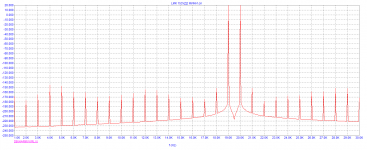

Here is the CCIF 19+20k IMD at 80 Vpp into 4 ohms, and loop gain plot. I cut off the IPS from the amp image since it is based on Figure 7.13 in Bob Cordell's book, not sure if I'm allowed to post it here.
I can't see the 1kHz difference spur, which normally is the whole point of the 19+20kH.
Jan
Jan
Looks like the frequency axis labeling got messed up, it's there at -96 dB (-119 dB below 19 kHz component).
Attached is the fixed chart.
