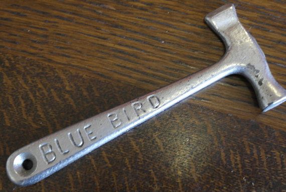

It was an English thing. You used to get bars of Toffee under the bluebird brand that were impossible to eat without breaking them up. The xmas presentation packs that Grannies always bought to rot their grandchildrens teeth came with a special hammer for the job.

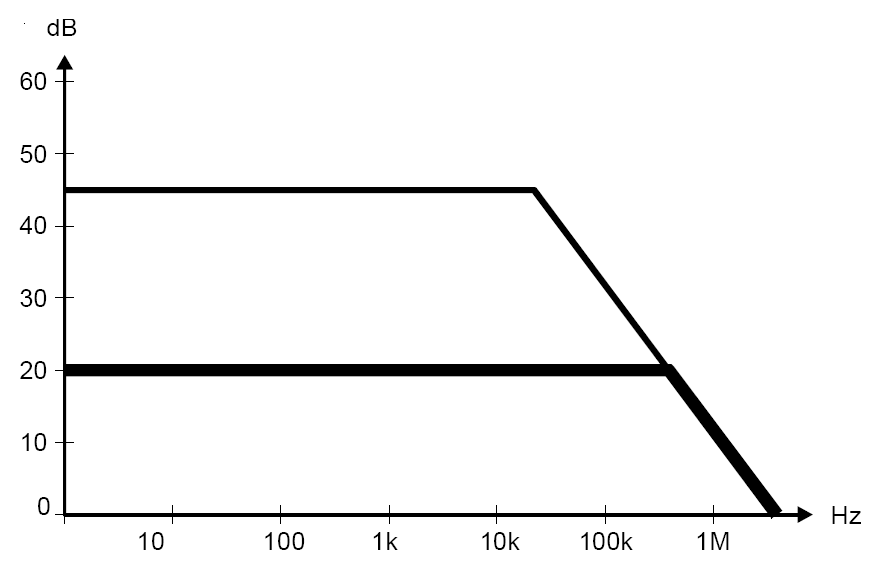

You're right. 10 to the third is 1 kHz. Some op amps are 100 Hz or even 10 Hz.
In itself that doesn't mean a lot. If you start higher and roll off earlier, you might still have the same open loop gain at, say, 20kHz. And that is what counts for distortion reduction.
If two opamps have the same open loop gain at 20kHz, the one that has more at say 20Hz has a lower distortion in the audio band, for the same closed loop gain.
Jan

But, just in case: the attached illustrates the situation. Just disregard the frequency and magnitude scale numbers, I couldn't find a better one, but it is about the shapes.
These are the open loop gains of two amplifiers, that are used to get a certain closed loop by wrapping a feedback loop around them.
The top one (thin line) clearly has the smallest OL bandwidth.
Yet, for all frequencies below the turnover frequency of the (lower) wide-band amp, it clearly has more distortion reduction that the bottom (thick line) one with the wider bandwidth.
In fact, in this example, the top one, smaller OL bandwidth amp, has either more or the same distortion reduction than the lower, wide bandwidth one.
Jan

So one would think. It's an argument I've seen used. Why do people say HD measurement has less value than IMD when the mechanisms that cause them are the same? Does IMD directly correlate to HD?
Gotta agree there. What gets forgotten in all these conversation is that HD and IMD are the names of tests, not program material playback errors. They're ways to measure nonlinearity. They aren't directly the things we might hear with music. Might hear effects of the nonlinearity, but not simple harmonic distortion or two-tone IMDs or even equal-level multitone distortion. There's not 0.1% distortion when you listen to an amp that measures 0.1% at its rated power or even at other powers. Just like when you have a speaker that measures -3dB down at 20kHz, it doesn't mean that the energy at 20kHz is just half of what is playing at 1kHz when you're playing Bach!
