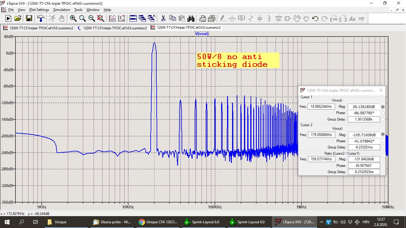

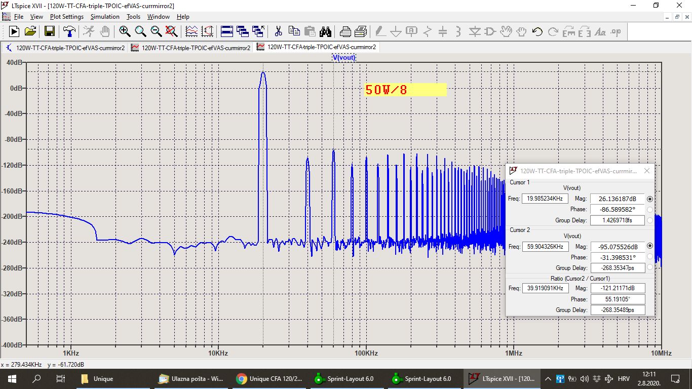

OK...where's that -120db THD at 20khz graph as advertized by your friend?This is my simplest CFA with laterals ans timios real measurement are starting from here: https://www.diyaudio.com/forums/solid-state/338814-lateral-cfa-120w-bsa-29.html#post5837939
If real measurement that will be, probably, the amp with lowest THD20k ever built.
Here is simulated 20k FFT at 50W/8ohm of this amp here: https://www.diyaudio.com/forums/solid-state/253039-unique-cfa-120-230w-amp-25.html#post4665073, but I don't thik it will be so low in real amp.
First FFT was with antisticking diodes connected between VAS output to the VAS enhancement transistor base. Second one is with no diodes.
So...you didn't even built it and people aready swear on your -120db thd at 20khz... true angineering precision...
