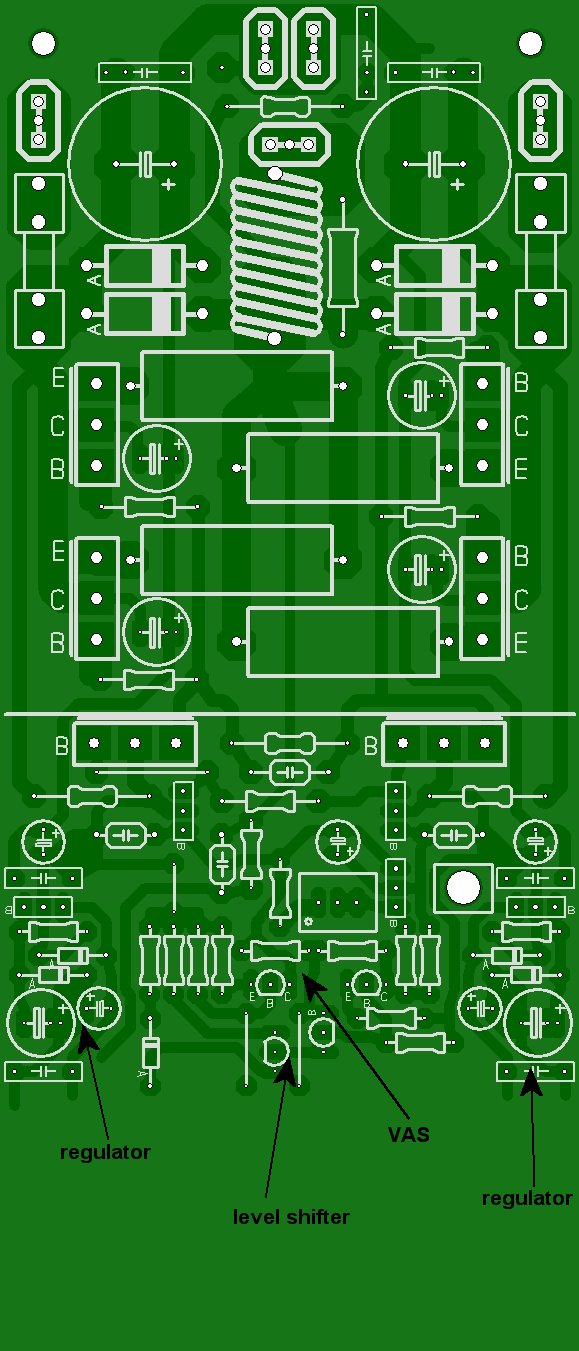

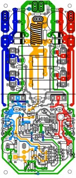

I've been "bouncing" around the forum , looking for EVERY leach and triple OP
thread , the present course I've set is the best.
(Attachment 1) is my progress (perfection can't be rushed 😀)
Red= V+ Blue= V-
Green=ground
yellow=output signal/nfb
dark blue/brown= driver signal returns.
Each section of the amp is boxed in and has it's own separate area.
I'm down to just the small signal section so I can really make things small
and tight.
It still looks like 76 X 153mm will be sufficient for 2 pair OP.
Output stage can be scaled with 25mm extra PCB per output pair. Make
the whole PCB 250mm and you have a 6 pair "big" amp.
Or , split the board at the main njw0302/0281 drivers -
the same design can be modified in any configuration.
I'll have the "front end" done tomorrow.
PS - small signal section will have optional separate PS's AND it's
own separate "quiet" ground that terminates to the main star.
OS

Andrew , You see in my last layout attachment I added the PS diodes. I also
have reverse diodes on the regulators.
A few cheap diodes are worth it.
I'm at the the "final stretch".. now.

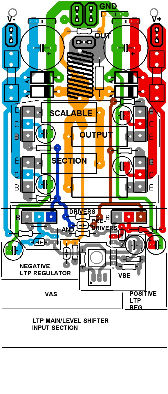

I'm down to the 2 differentials - I'll do them "face to face" ,
for thermal stability.
This amp has way more components than the honey badger , luckily ..
they are smaller ones. 😎 Way cool - diya works again....
OS

Are those rail diodes 1n540x size (3A)?
I use 1n4002/3/4 and they have plenty peak current capability for both duties.
I have reverse connected a PSU twice. Once without protection (=blown chipamp) and once on a protected Leach clone (=no damage).

By andrewT -Are those rail diodes 1n540x size (3A)?
MUR460-E3/54 Vishay Semiconductors | Mouser
Use these for OP flyback + rail apps. - always available/reasonably priced....
Dan , the 10R groundlift is the 0V reference for BOTH the inverting and non-inverting
inputs. The 5-10R + double diode is "standard fare" for DIYA solid state amps.
Look around !
This amp is so good at negotiating DC offset , you could even use a mismatch mje350/
KSA992 as the input pair and STILL have <10mv DC ! (no offset trimmer needed - below 1)
The GLA is totally different than a "blameless" or leach.
I will be using a 220u @35V NP for the DC cap , BTW.
PS - assume you did have a "less than perfect" ground at the input with
the differential referenced to either side of the 10R.
A .1V "bad ground" would equate to over 3V DC at the output.

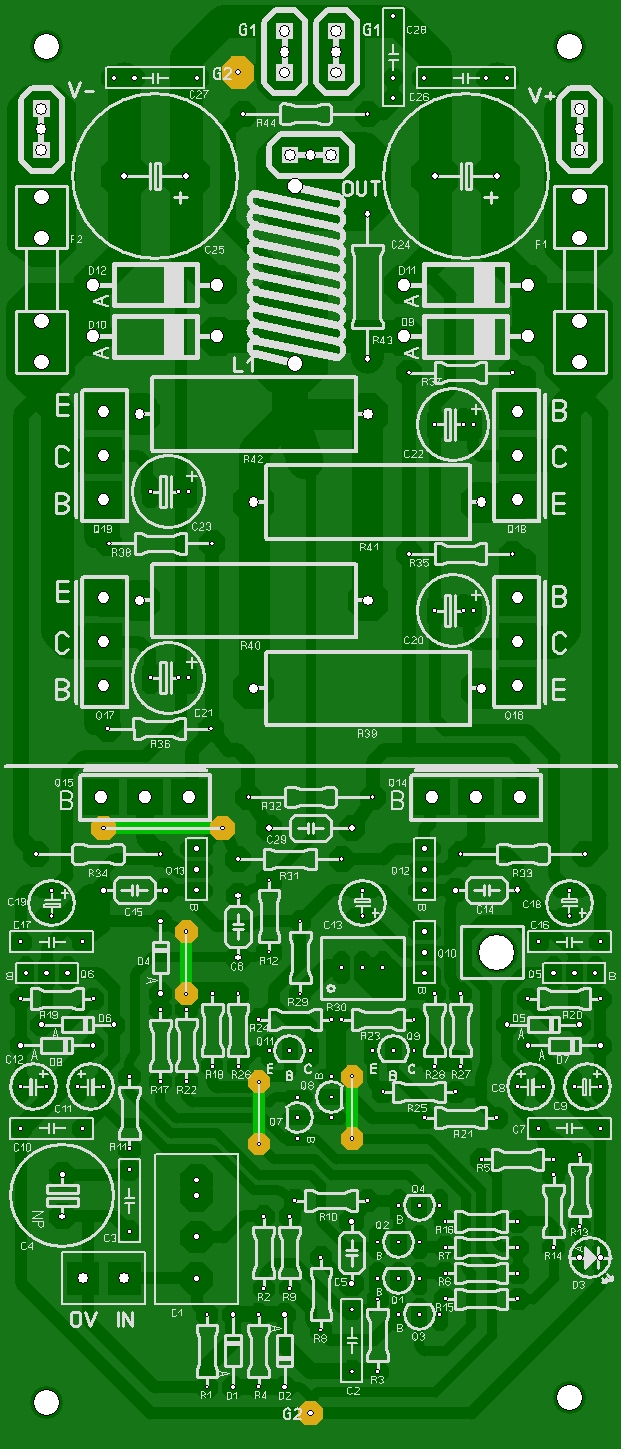

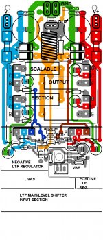

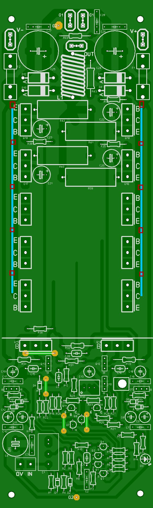

It's done !
1. - Is the board finished.
2. - Is the signal/power in color - blue =V- red=V+ green=ground(s) yellow=
signal....
3. Is the schema that corresponds to the layout (hopefully -99% ?).
HD pcb bitmap (2100x900) is in the Zip file attached. It should scale to
76mm X 178mm.
OS
signal....
76mm X 178mm.
OS
GLA SURVIVOR
Hi Ostripper
greetings thanks for sharing your pcb design in the final schematic
whats the max supply voltage is 80 volts dc +/- ok for 10 pair output stage
warm regards
andrew lebon😉
Hi Ostripper
warm regards
andrew lebon😉

LOOK below!!!
If you can source the MG6330/MG9410 outputs , a 5 pair amp (I'm making it now- below), can
match at least 8 or more pairs of MJL21193/4's.
Andrewlebon , you must tell me what offset you measure so I can decide
whether a offset trimmer is worthwhile to include on the level shifter
circuit. My original amp (Sansui) only has 6mv offset , but it uses a DC servo.
I was just looking at some moon audio/Classe' power amps , they look just
like the amp below. Use 14ga copper wire on top of the output rails with
a wire jumper between each output like below. Classe' used a GOLD plated
bus bar - oh boy ... copper will do 😛 .
EDIT- 80V is just fine - amp (front end) is regulated - all devices are good to 120V (or much more) !

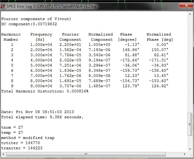

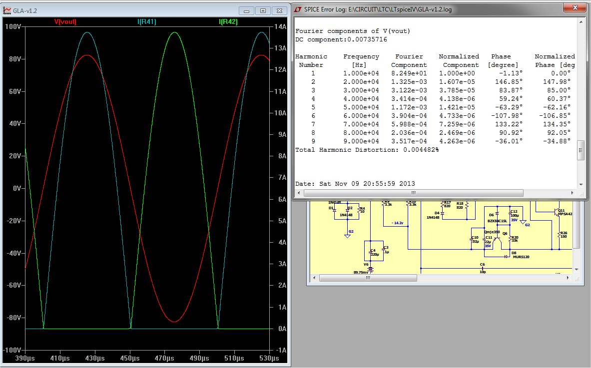

90V rails with 5 pair.
Amp is supply voltage independent.
Distortion is .004%/.008% -10/20K at the levels below.
You might either need a preamp or increase the amps global gain factor.
If you do THIS , you might need to recalculate the lag compensation
(R8 and C5) and run a loop gain analysis to check the phase margin.
I needed almost 4V input to get that 160V p-p waveform.Amp clipped at 85.5V
peaks... 😱
OS
