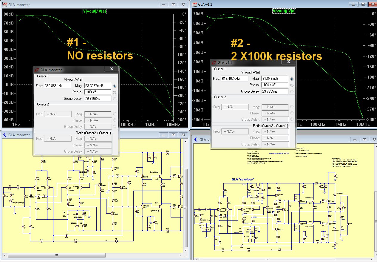

Could instead of connecting R25 and R26 to ground, two other resistors be placed between VAS base and collector (local feedback) or two resistors from VAS out to the LTP inverting input?
Why have choosen for this VAS loading?
Cheers
VAS loading -
Look at the comparison below:
Amp #1 - has no loading. LF gain is 78db. it's bandwidth (UG-unity gain) is 390Khz , and the lead
compensation (C6) had to be increased to 15pF to keep -103 degrees margin.
Less than 1db extra gain at 20K available for feedback. This combined with
the extra distortion of a larger C6 adds up to .01% THD20.
Amp #2 - Loaded by the 2- 100K resistors .LF gain is only 66db, the margin goes out to 618K
the gain at 20k is 32db! 32- the 26 of the amp leaves 6db extra.
Besides at much better .002% THD20 , C6 can be reduced to 10p to give the same -103 degree margin.
H3 also decreases with the loading.
Conclusion - loading sacrifices gain at lower frequencies for more gain at
the higher ones. 1/5th the THD at 20K is the result. TMC does the same
work in a typical "blameless" topology.
This is also why you see the THD plots of most amps " reach skyward"
at 25 to 30k - no extra gain above 20K !
PS-this is why Sansui used the loading resistor.

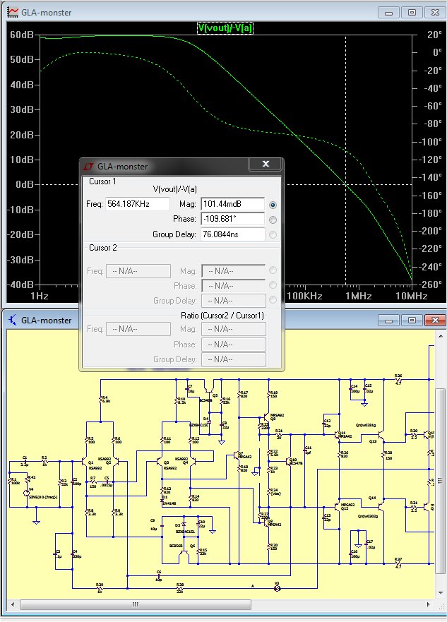

You mean C-B on the VAS devices. If that is what you mean....
(below) ONLY 54db LF gain (100k - 60db+ w/ 330k) , UG rises to 550+khz , Margin remains the same.
FFT remains the same (as with no loading). ?
Tried 330k as well ....
This seems to lower gain globally , instead of "shifting" it from LF to HF.
" no way to treat a VAS" ... ha ha ! It is treated far worse from the standard EF2 (load + capacitance).

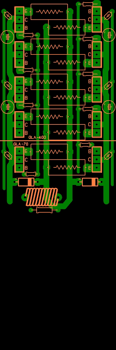

Wow, very nice map OS! The "Frankenstein" version is going to be my next project.
By the way, the name 'Survivor" reminds me of the 80s band that did the theme song "Eye of the Tiger" for Rocky III, a fitting name for a simple, rugged & quality amp.
Combined the 2 PCB's into one. Just print 1/2 the board for 70W , all of it for
"frankenstien" (400W).
76mm X 228mm , option to use TO-220 or TO-3p drivers (both pads).
You can mount the TO-3P on the main heatsink or use "bare" TO-220's above board (a little pcb heatsink ?)
Vbe will be a little TO-92 device face down under the board.
Break the board off (or don not print/transfer it) at the GLA70/GLA400 line
you have the original 70W Z5900 sansui.
OS

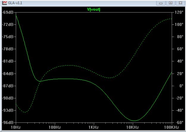

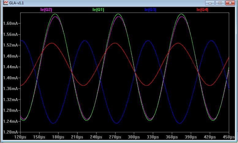

I'm listening - I like...
The amp this project is reverse engineered from is indeed musical. The badger
has a little more bass ... but the GLA can have a bigger input cap.

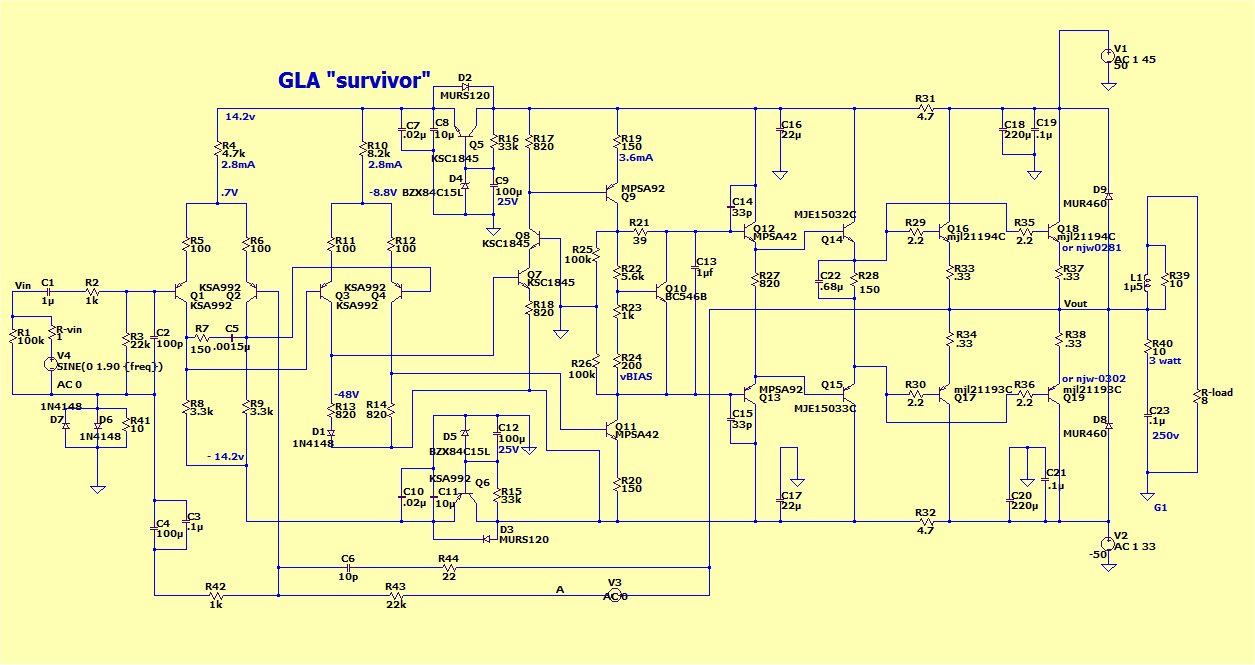

As far as the circuit , a few improvements while preserving the "vintage" aspects.
#1 - level shifter has a added cascode (Q8)..can use KSA1845 safely here now.
#2 - C22 output "suckout" cap. The tiny switching distortion "pulse" is gone
from the stages.

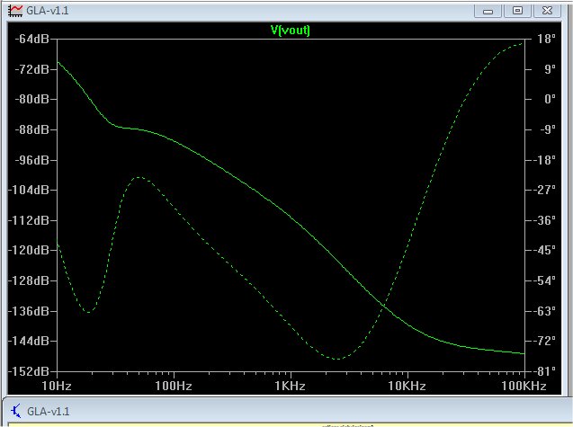

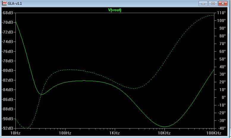

#3 - C9 and C12 at 100uF. This brings PSRR (photo 1) to -82db , and even below
-90db at the high end (10Khz).
#4 - Reverse diode protection for the zener regulators (D2/3).
#5 - balanced the currents for Q1-4 , all are at 1.4mA (photo 2).
The final V1.2 schema (photo 3). .003% full power 20Khz at 2R !
OS

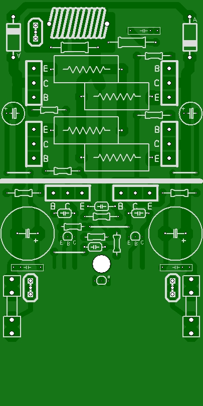

The boards will be done (below). This is a 200W/4R with only 2 pair 21193/4
50V rails .... perfect Sub amp .
The outputs will be driven by NJW0302/0281 (smaller outputs ! ).
This is the most stable triple OPS I've simulated ... PLUS , I have the real amp
for reference. I can't lose.
OS

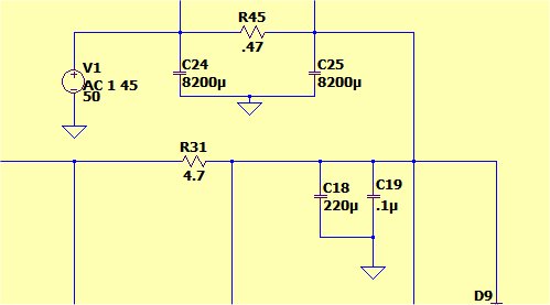

Dan , if you use 2 bridges with 2 separate capacitor banks you essentially have
each amp "isolated" by diode (like your schema).
Both on my two Badger's and when I do two of these amps , I will use 25A
bridges for EACH channel and 4 X 8200uf caps for each.
The GLA already has very good psrr (below 1). I wondered how it could even
play music at low volumes with total capacitor failure !
Add a simple CRC (8200uf -.47R/10W-8200uf - below 2) , and this amp is
effectively a dual mono (spec wise - BELOW 3 !)
2- 10W/1R for R in parallel would most likely handle a 100-200W amp.

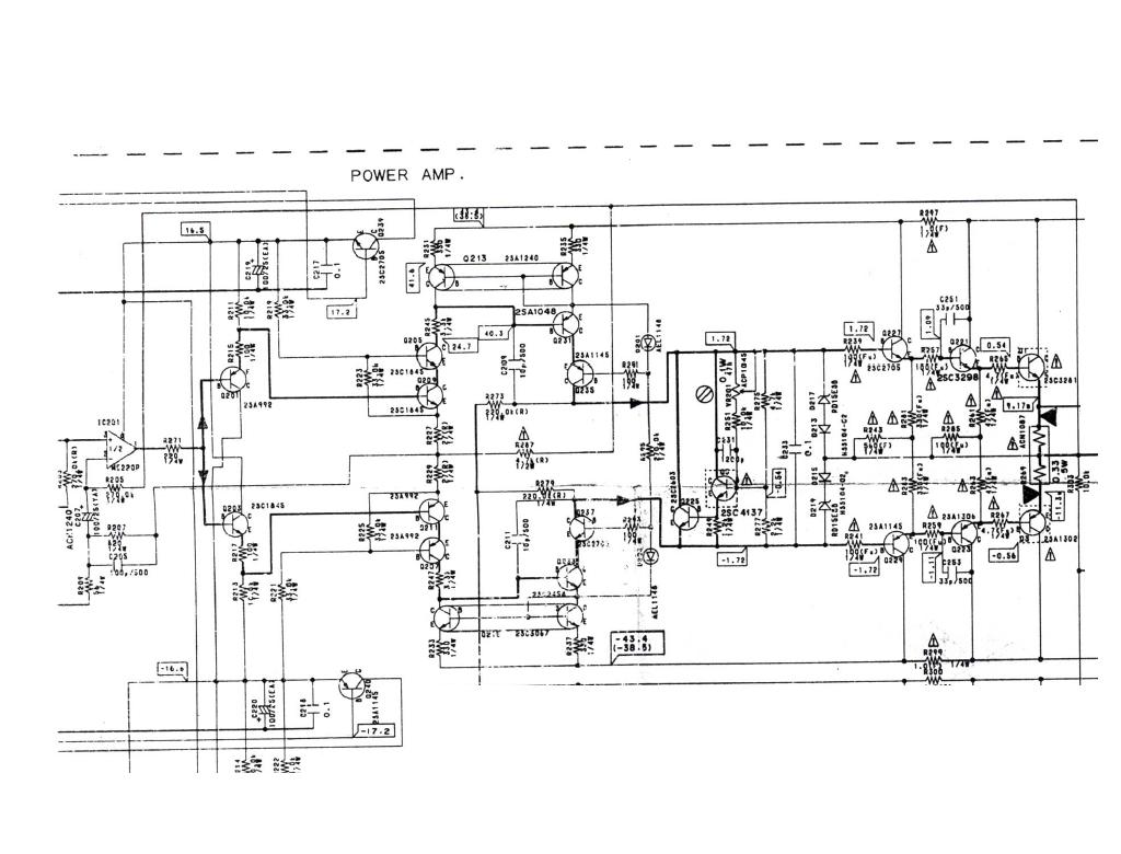

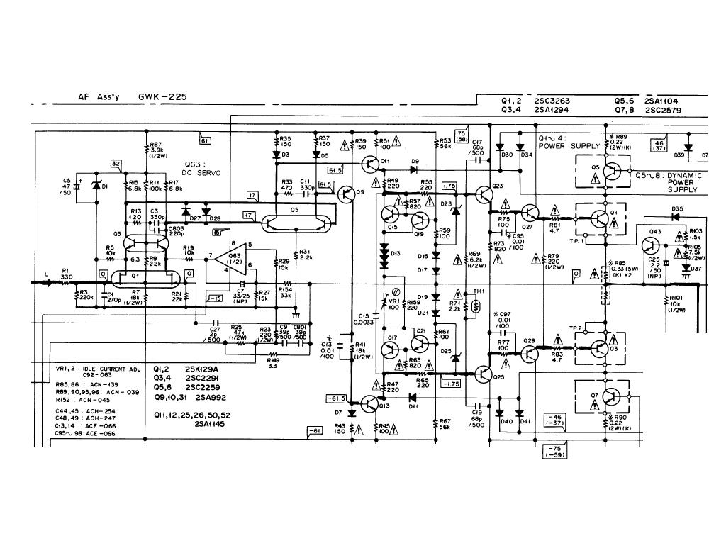

Nice amp, this is my favorite old amp Pioneer A70.
All new Marantz amps are clone of old Pioneer amps, symetrical CFA are clone of Pioneer A400.
Regards
The A-70 is indeed interesting ... is it "stepped" (dynamic power supply) ?
The VAS is different , too ! Must simulate it ...
OS
OS
It's 'stepped' and there is 'non switcing' circuit

2SA970 would be a good substitute. This device is used in many a vintage amp
such as this.
Q1-4 on this amp form a extreme high gain quad differential , best to keep the
Hfe 200-300 (970 grade- ? - "GR"). I have only simulated a Zetex high gain pair for
Q1-4 (1200Hfe) - no issue.
The Q5 and 6 regulators should be high voltage to-126 devices , R15-16 should be
47K for 70V rails. ABSOLUTELY use output devices for the drivers and
even a more robust device for predrivers (mje340/350 or 2sa1381/sc3503).
.asc (below) for 70V rails - all is good !!
EDIT - Bob Cordell once advised to keep the drivers as the highest Ft devices for the ultimate
stability in a triple. mje340/350 - Ft 10mhz , NJW0281/0302 - Ft 30mhz , and a "slow" output pair MJL21193/4 - 4 mhz ....
OS
- GLA (good little amp) "survivor"
