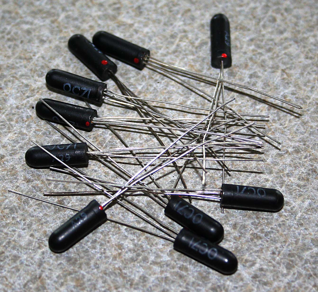

My OC71's haven't arrived yet but I'm keeping an eye out for them - not sure what to do with them yet but Mooly's amp will be the inspiration 🙂

They haven't arrived because I forgot to update my address on eBay - the package was returned to sender. I may never see them now....

Ahhh, the old red spot transistors... rf devices had a white spot for the collector you know.

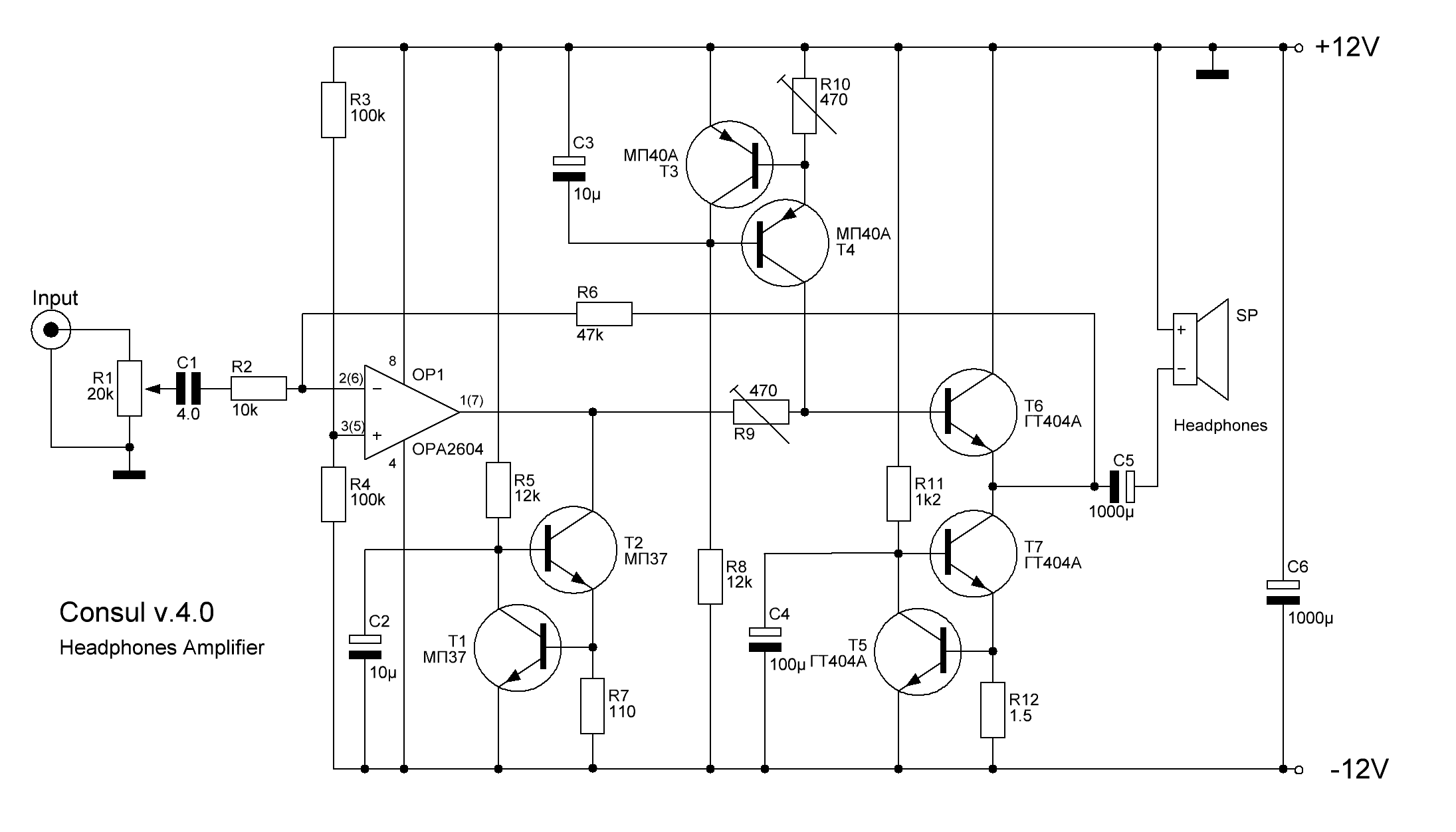

Finally etched a PCB (amp only). I found some old russian germanium NPN transistors, MP37b and MP38a, will try them for Q6.
High end germanium headphone amplifier.

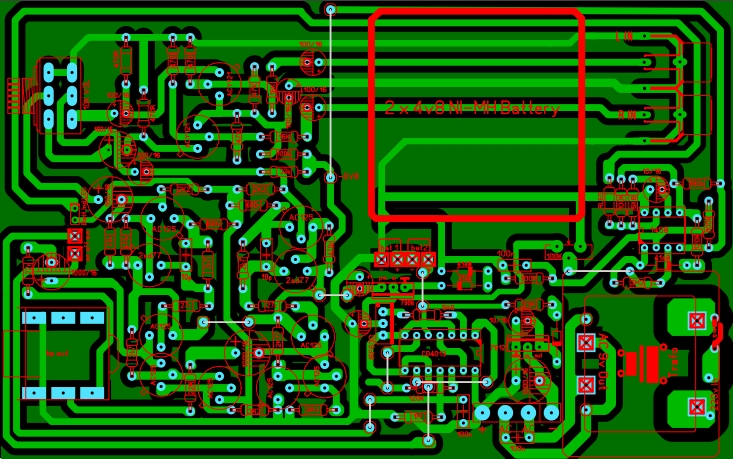

A more clear pcb?
Dear friends,
I am writing from Turkey. I have gone over the PCB file proposed and did minor changes (namely less wire links.), and writing the component values on the parts so it would be easier to place them.. and has a more professional look 😉. I added Sprint Layout file for this PCB. I use Sprint Layout to replicate proposed pcb files in jpg format 😉 It is kind of cheating but when you are desperate...
Attached file contains both the layout file and XPS files for toner transfer. If you wish you can change the tracks etc if you can design it better.
Did I test it? NO. (I just followed the schematics for part values so CHECK them if you'll use this PCB)
Do I even have required germaniums? NO
I did it just for the sake of old times and people who are lucky enough to have these Germaniums.
Please check this and return if any errors you find and /or mods you want.

Nice work 🙂
