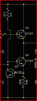

Hey Mooly,
I tried recreating the circuit a second time, from the output stage backwards, and it did the exact same thing as the first time: the top PNP transistor of the output is dissipating a lot of heat! It sounded okay, but I could definitely hear some clipping and distortion.
I also made an NPN version of the circuit, and yet again, it did the exact same thing (transistor gets really hot). However, it sounds very good.
I think my problem is gain mismatching. Could you give me an idea of the gains of the transistors? Obviously not all AC125s (or in my case some other PNP transistor) have the same gain. I think most of my PNP transistors had an Hfe between 40 and 70.
Thanks!

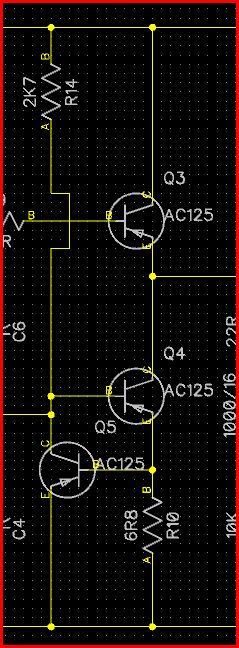

Hi Kyle,
Here's the output section... so lets run through how it works, and how to check it.
You can use PNP or NPN to "prove" this (just swap the supply for NPN), and forget the caps.
So first we connect Q3 and Q4 as shown, together with R10 and nothing else.
In that condition no current flows apart from leakage if using germanium, with silicon it's zero. The volt drop across the 6.8 ohm will be zero... check it.
If that's OK fit Q5 so that the base emitter junction is across R10, and connect it's collector to Q4 base. At this point the current flow is still zero.
[The two transistors Q4 and Q5 form a constant current source limiting the current working as follows.
As the current increases in Q3 and Q4 (which are in "series") the volt drop across R10 must increase.
When it reaches the critical Vbe value (0.17 Ge or 0.7 Si) then Q5 begins to turn on shunting base current away from Q4 so turning it "off" and reducing the current flow.]
So far so good...
so now connect the resistor R14 that supplies base bias to the constant current stage.
At this point the stage should still be drawing no significant current as Q3 base is not supplies with current.
So now to test, connect a 10k or so resistor from Q3 base to the supply.
What should happen is that the current flow should be steady and at a value determined by R10.
Measure the voltage across R10... it will be 0.17 for Ge and around 0.65 for Si. Using ohms law calculate the current. Using 6.8 ohms as shown it will be around 25 milliamp for Ge and if you used Si for Q5 it will be nearly 100 ma... which is to high and will overheat the transistors.
To keep it at 25ma with Si you need to swap R10 for 0.65/0.025 which is 26 ohm or so.

Hey Mooly!
Alright, it's working much better now! I used a 22R instead of a 27R, so it's still biased a bit high. But now my LM317 isn't getting hot enough to cook an egg and it could be good enough to build on a PCB now!
Thanks so much for your help! By the way, what do you call the output stage?

If you mean R14 ? then that's 2K7 (2700ohms) 🙂
The output stage is single ended Class A running into a constant current sink which increases the efficiency to 25% over using just a resistor (12.5%).
Oh no, I meant the 6R8. I thought that would change the bias on it too. Was I supposed to have changed R14 instead of R10? Remember, I am using silicon now. But I'm about to try some germaniums I got today.
