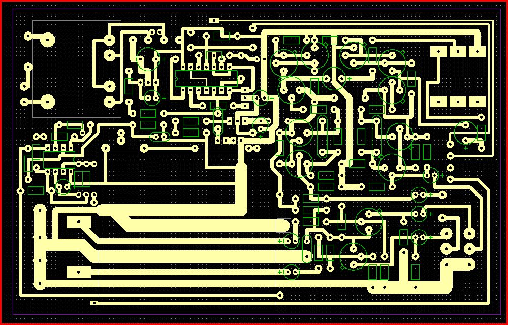

Still playing around with the layout... exceeded the 250 pin limit on Diptrace lol... but you can still place pads one at a time... yea 🙂
This is looking like the final design. Need to check that the sockets, pot and switch etc will all position perfectly to allow the PCB to slot into the rather nice case.
It all works, and sound quality is outstanding.

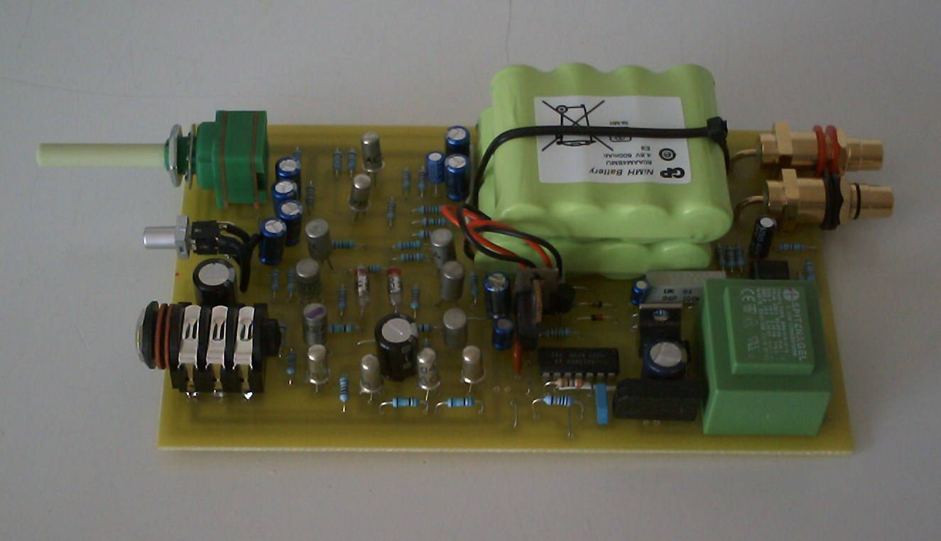

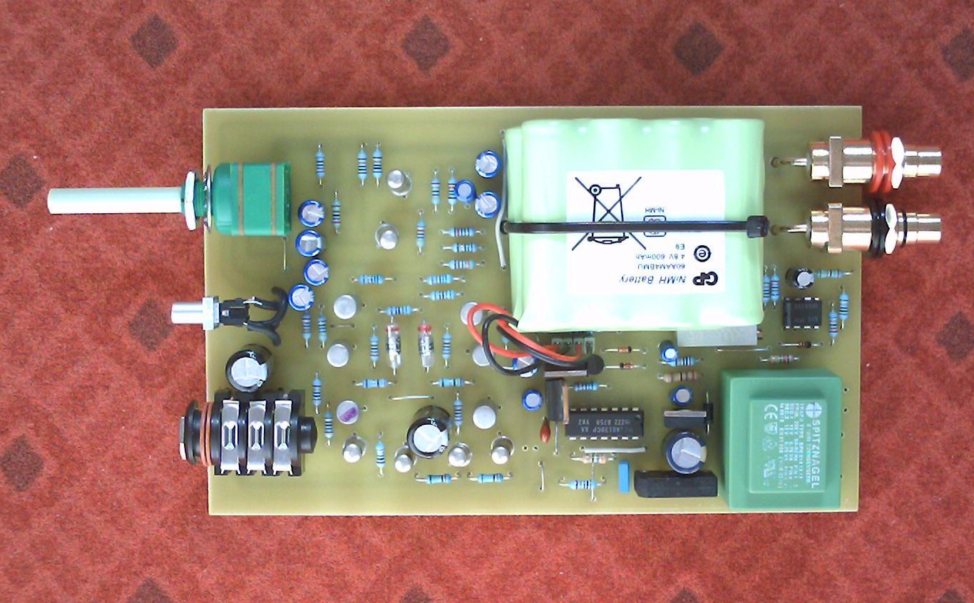

PCB assembled... all worked first time... yea.
Just gave it a quick listen... wow 😉 this is good. And it's so quiet too.
Next will be the case etc... that's the bit I don't like doing.
The mutiturn pot (between the battery and transformer) allows the low battery warning to be set accurately. The small push tact switch is illuminated (Red L.E.D.) and this begins to flash when the battery pack needs charging. You will see why I settled on red rather than blue hopefully in the next installment.
It's getting there slowly...

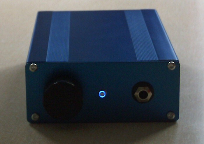

Finished... what was that about a red LED ?
Hmmm... I mangled the switch a bit playing around with fitting it. Pity as the red looked rather good. Should have realised that mounting it on the PCB was no good as the slightest movement would cause it to bind and stick. In the end made two brackets from PCB and drilled the front, but not deeply, to provide a good key to epoxy these in place. The switch is then soldered to this... perfect alignment that won't shift.
Listening tests again confirm how right this sounds, and as mentioned how quiet it is. Even when running on mains (charging) it's totally silent, not a trace at all of mains hum/buzz etc which is just as it should be.
So there we go... job done 🙂
