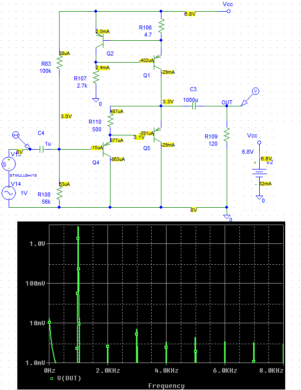

...input impedance will be pretty low...Much depends on the germanium device used and how much gain it has and so consequently how low in value the bias network will have to be.
Which can be designed-away at the cost of one more transistor. Darlington is certainly in the family. Zin is 30k all over the audio band. Bandwidth as shown is 5cps up (I don't trust my model at RF, but an emitter follower will be OK past 20KC).
Random changes:
I drew it plus-up so I did not have to think on my head. It can work either way of course. Plus-up *may* be convenient to share power with other loads.
The 40mA(?) is over 100mW which seems hot for many GE devices. And 3V/40mA seems good to under 100 Ohms, better than the 600r load shown promises. I split-difference at 30mA and 120r.
THD at 120 load and 2.7V peak is 0.36% and clipped; all harmonics showing. At 2.4V peak the idiot figures 0.2% and a nice fall of high harmonics.

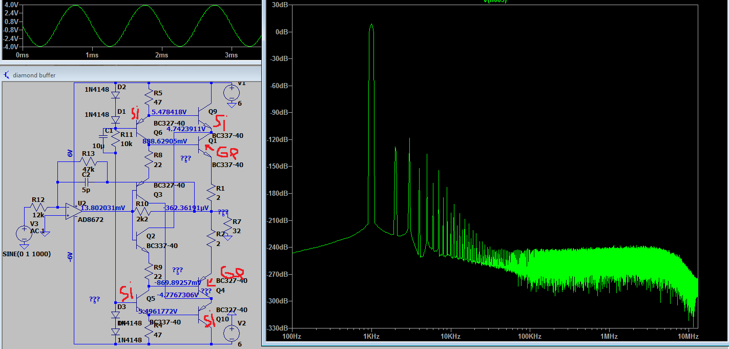

I use a complementary feedback pair in mine, with both Ge and Si. The Ge is the input transistor and the Si is the output transistor running at 100mA, with a single Si constant current source for bias. The Ge transistor dominates the sonics as the silicon BD139 is within its feedback loop. I’ve not measured the distortion yet but it should be lower than a darlington emitter follower.
Why use germanium? Because although they are outperformed by silicon transistors in many ways, I enjoy their sonics. Yes, they are acting as tone enhancers. Too many of them in the signal path can be excessive though.
All too often a circuit has been designed with the lowest distortion possible, and I’ve designed some very low distortion circuits over the years. But haven’t these circuits lost sight of the sonics as entertainment? Hifi is for entertainment after all, isn’t it?

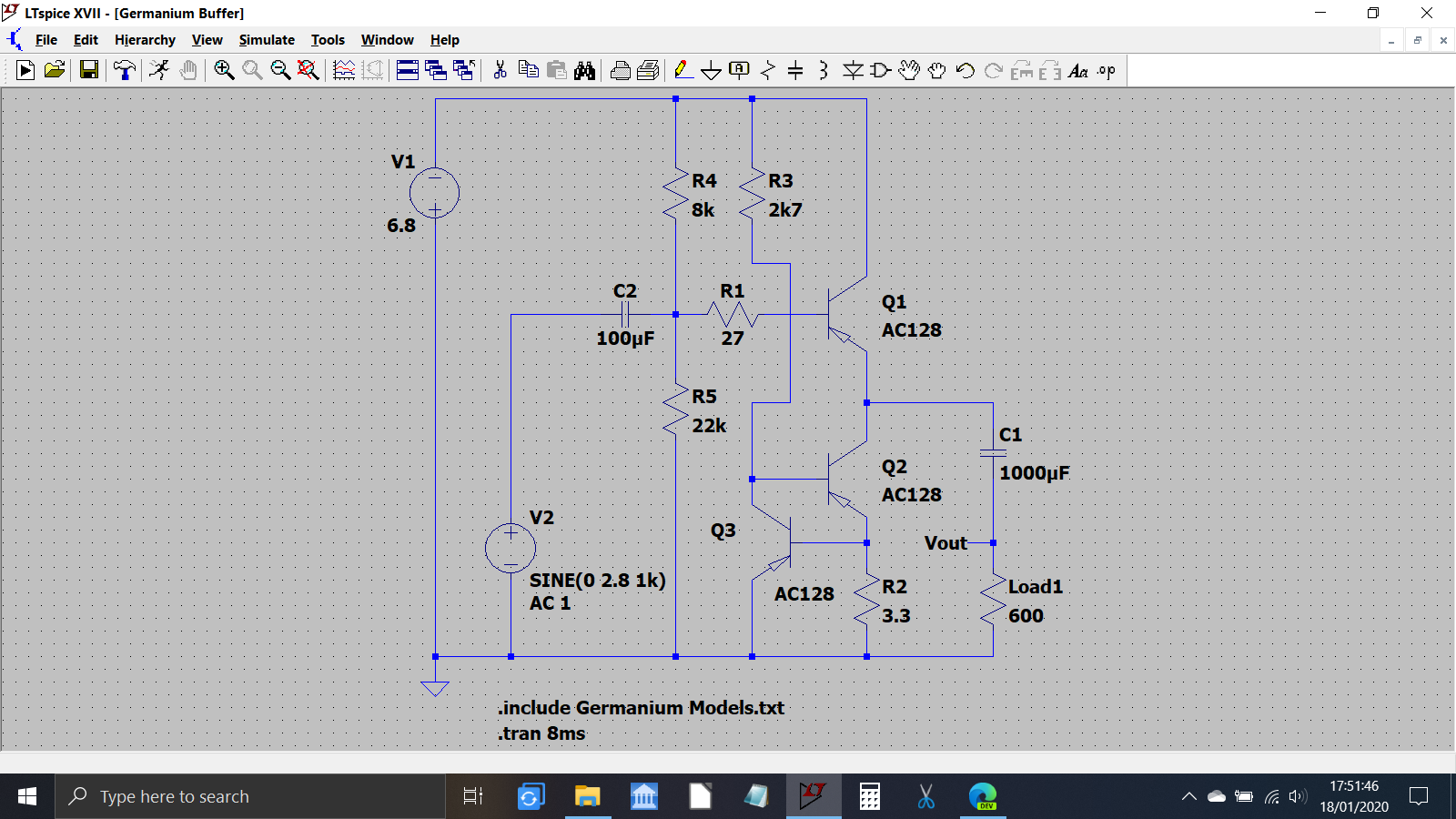

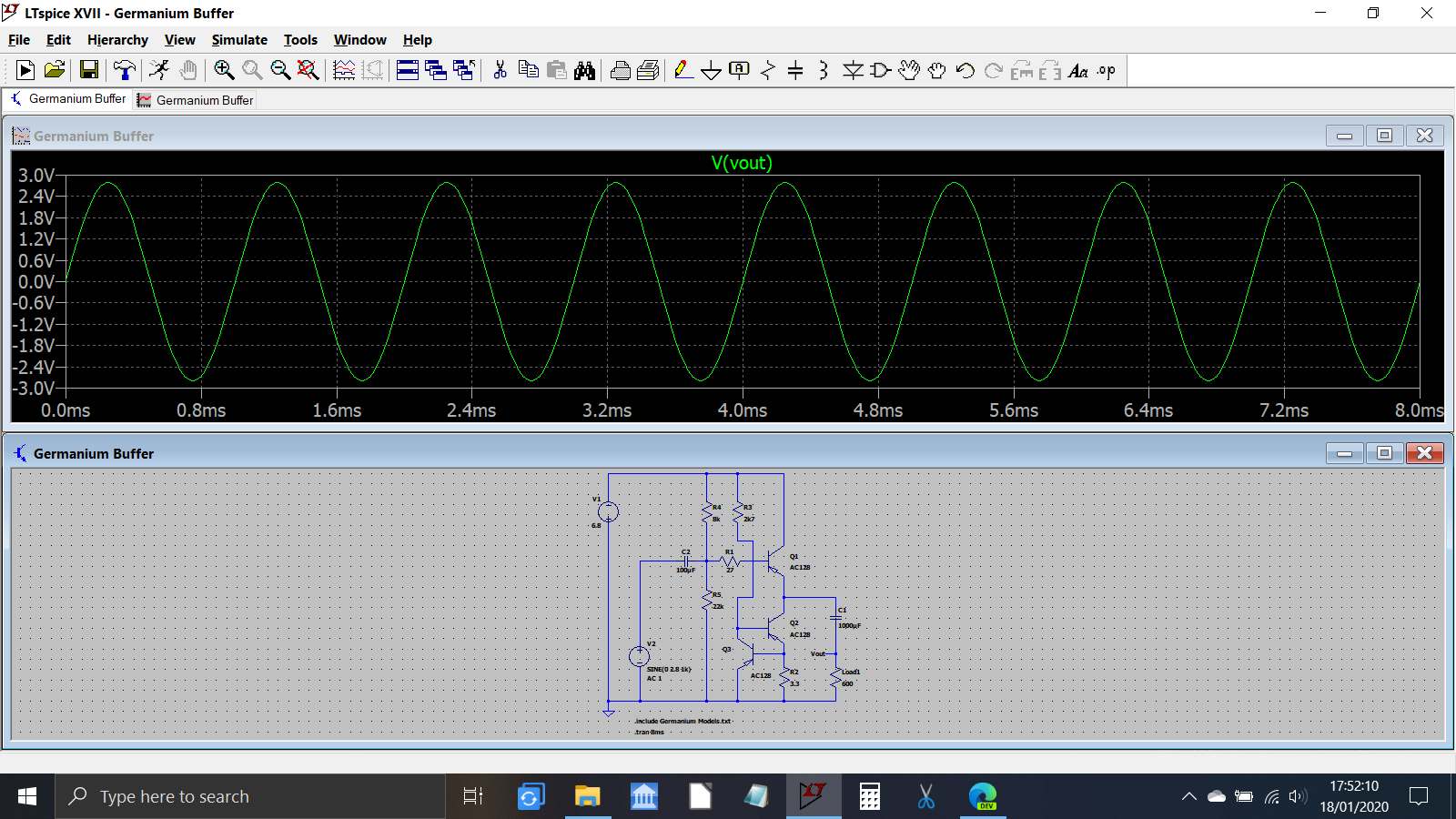

Random changes:
Plus up 😀 I like that 🙂
Actually I think you will find your configuration gives a bit better high frequency ripple rejection (as long as you leave ground where you have it) because the current sink/source is now fed from the rail and is not in the earthy side. For a battery headphone amp it doesn't matter of course.

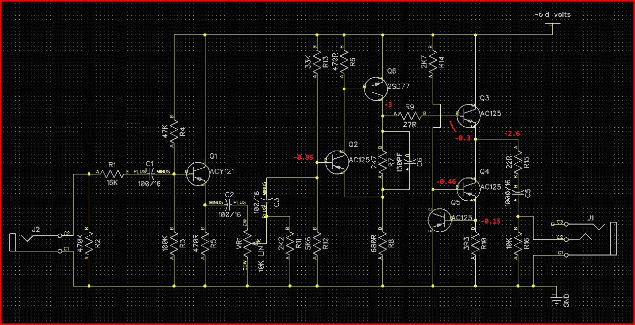

Mooly I built a breadboard version of your design using mp26b and an mp10b transistor. It works pretty well and sounds good but I suspect my output stage needs adjusted. Q3 is drawing more current than Q4. What voltage should the emitter of Q3 be? Mine is about 4.5v now with a 7v supply. The collector of Q6 is close to 1/2 of the supply voltage as you mentioned. Thanks.
Emitter of Q3 should be around half the supply voltage so as to give symmetrical clipping, so around -3.5 volts with a -7 volt supply.
If the Collector of Q6 is correct then the emitter of Q3 should essentially follow it in voltage as it is just an emitter follower.
So that actually suggests a problem with Q3. The base/emitter volts (measured across the junction) should be pretty low at around -150 millivolts with the base the more negative. There should be virtually no voltage across the 27 ohm (R9)
Maybe that particular device just isn't suitable and is going into some kind of thermal runaway and low gain state (germanium devices are prone to this at far far lower temperatures than silicon).
A picture is worth 1000 words so here are my measured voltages. The negative supply threw me off so disregard my previous numbers. Q6 isn't quite half the supply but close enough I gather. The base/emitter voltage of Q3 is reading -0.3v. The voltage across R9 is -31mv.
Lets go back to basics...
The current in Q3 and Q4 should be essentially identical. This is the total current flowing in R10, the 3.3 ohm.
That resistor can be tweaked to give more or less bias current, the effect of that is to allow higher current delivery into lower impedance loads.
The voltage on Q3 emitter sets whether the amp clips symmetrically or not and should be around half the supply voltage. Ideally use a scope and a suitable load resistor to get the max undistorted voltage swing across the load.
You should be able to set that via tweaking R13, the 33k.
The first stage has no effect on the output stage biasing but the emitter of Q1 should also be around half the supply voltage. That can be tweaked via R4
The nature of germanium devices in combination with a low supply voltage and relatively high value resistor networks for setting the DC conditions mean that the circuit can be a bit critical on devices used unless you do tweak values. With silicon the specs are more consistent and gain much higher and so repeatability is better.
