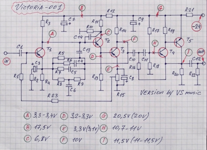

Not exactly a bad habit! I do it the same way, too lazy to learn some schematic design software.

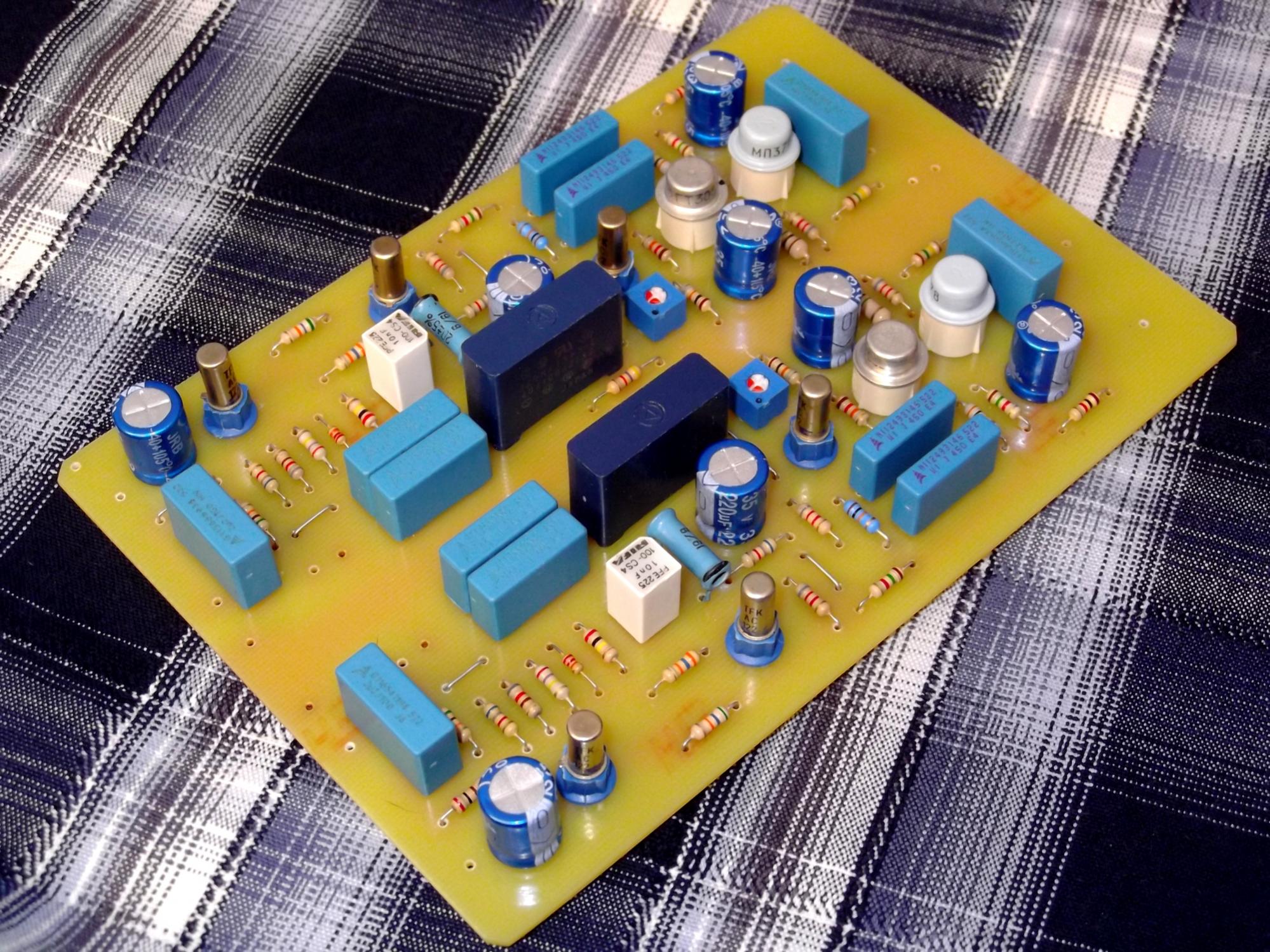

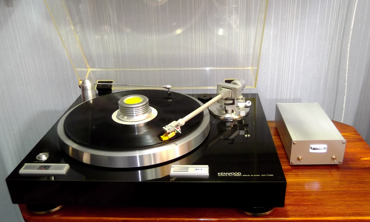

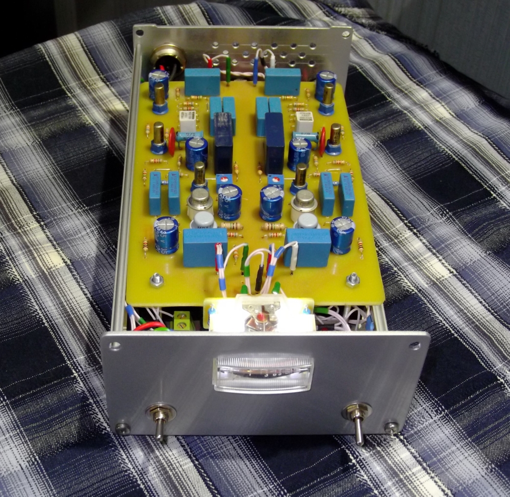

And here is another scheme that I really liked for its sound . I have already written about it here , but I probably incorrectly published the scheme and photo of the product here - the pictures have not been saved . This is the scheme of the corrector from the radiola Victoria-001 ( 1972, USSR). I changed the original scheme slightly for several reasons . My version is like this . This Phono preamp has a rumble filter with a very steep cut-off front - very effective on uneven LP's .@ vsmusic:
Are there circuit drawings available of your low noise Ge-preamps?

I've read this topic . I wanted to try to make such a product . But it hasn't come to that yet . But I recently retired . And now I don't work . Maybe I'll make one . If this happens, I will definitely report the result .What about this ?

I like to listen to the Beatles , Jethro Tull, Caravan, Curved Air and others using the 60s-70s Phono preamp . It's beautiful.
Well, your preamp appears to match exactly your favourite artists' music 😉.

Currently finishing this circuit (AC125, AC130 (NPN!), AC132, 2xAC124), with a single pot semi-shelving tone controle as a hp-amp to dress the digital hiss from modern sources.
vsmusic, your drawings and builds are both stencil-like: beautifull!
I'm lazy when drawing, with all the calculations scattered around the components. Lovely to read cyrillic, I leave it that way.
