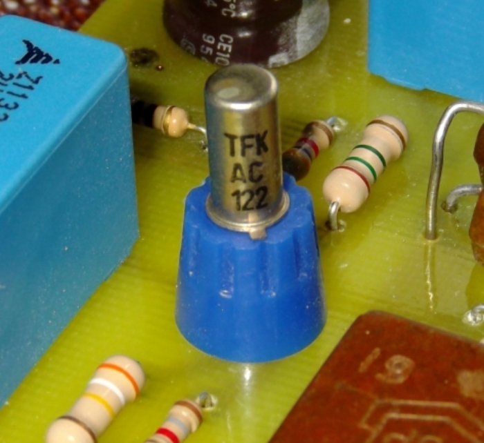

The noise level of this preamp (with AC-122 transistors) is less than minus 70 dB . I took measurements using RMAA . This parameter is quite enough for me . I use vintage players ( pioneer and Kenwood), vintage Empire cartridges ...Why not a vintage preamp ?Yes, especially the AC122, as used by vsmusic, wasn't exactly known for low noise.

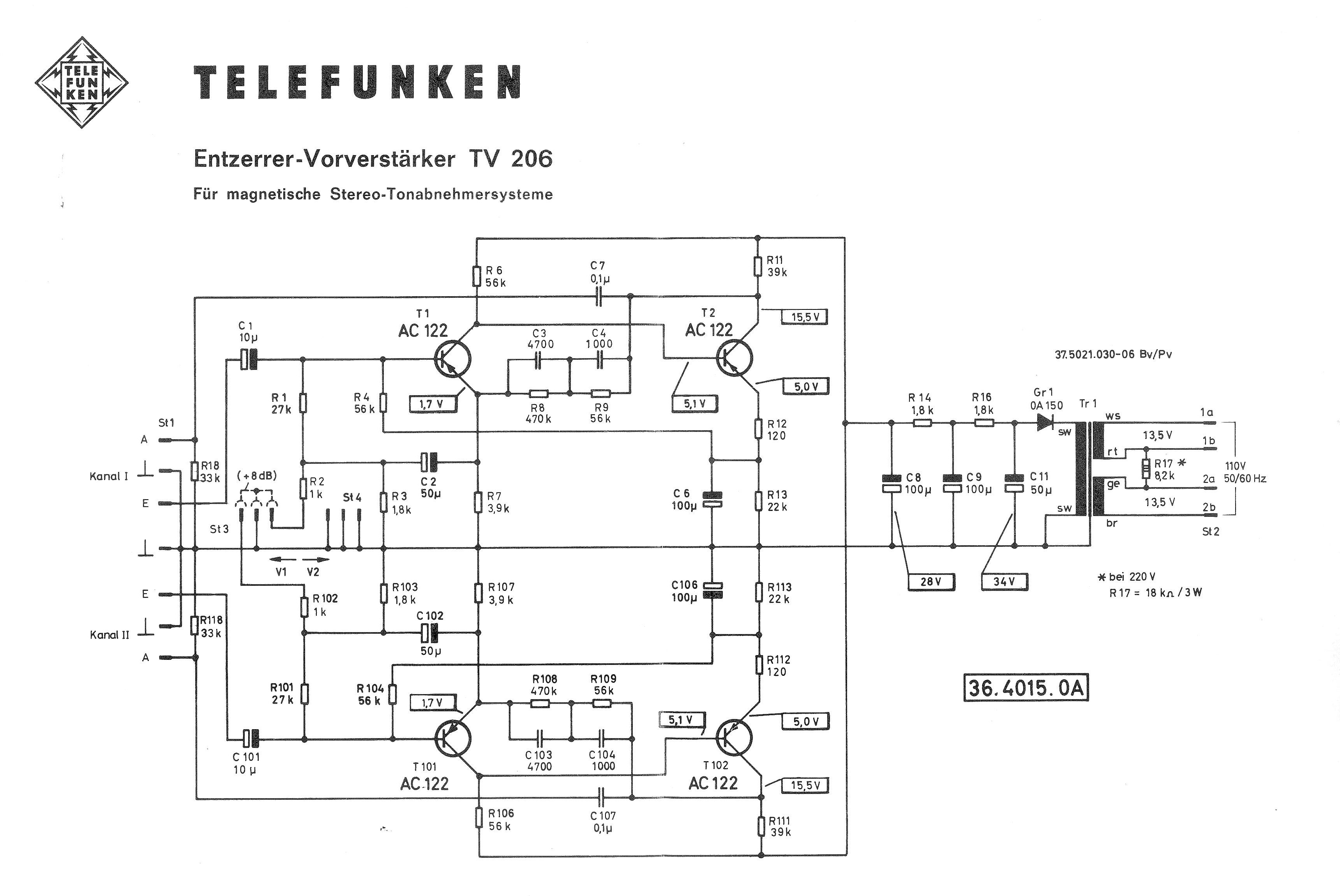

But agreed: That Shure M-61 offers astonishing data, especially for a Ge powered phono amplifier. Which devices are used in here?
Best regards!
The SHURE product used American transistors . But the phono scheme itself was the same as that of Telefunken TV-206 . I don't have transistors like SHURE used . So I can't compare them to AC-122 transistors . Telefunken used AC-122 transistors .I made a device like Telefunken's , using AC-122 . Power supply-32 volts . And this has been working for me for about 5 years...which still has to be proven…
Never noticed any design using paralleled Ge devices, most probably due to their enormous manufacturing tolerances. You'd have to carefully select form a big lot of specimen that aren't in production since a long time.

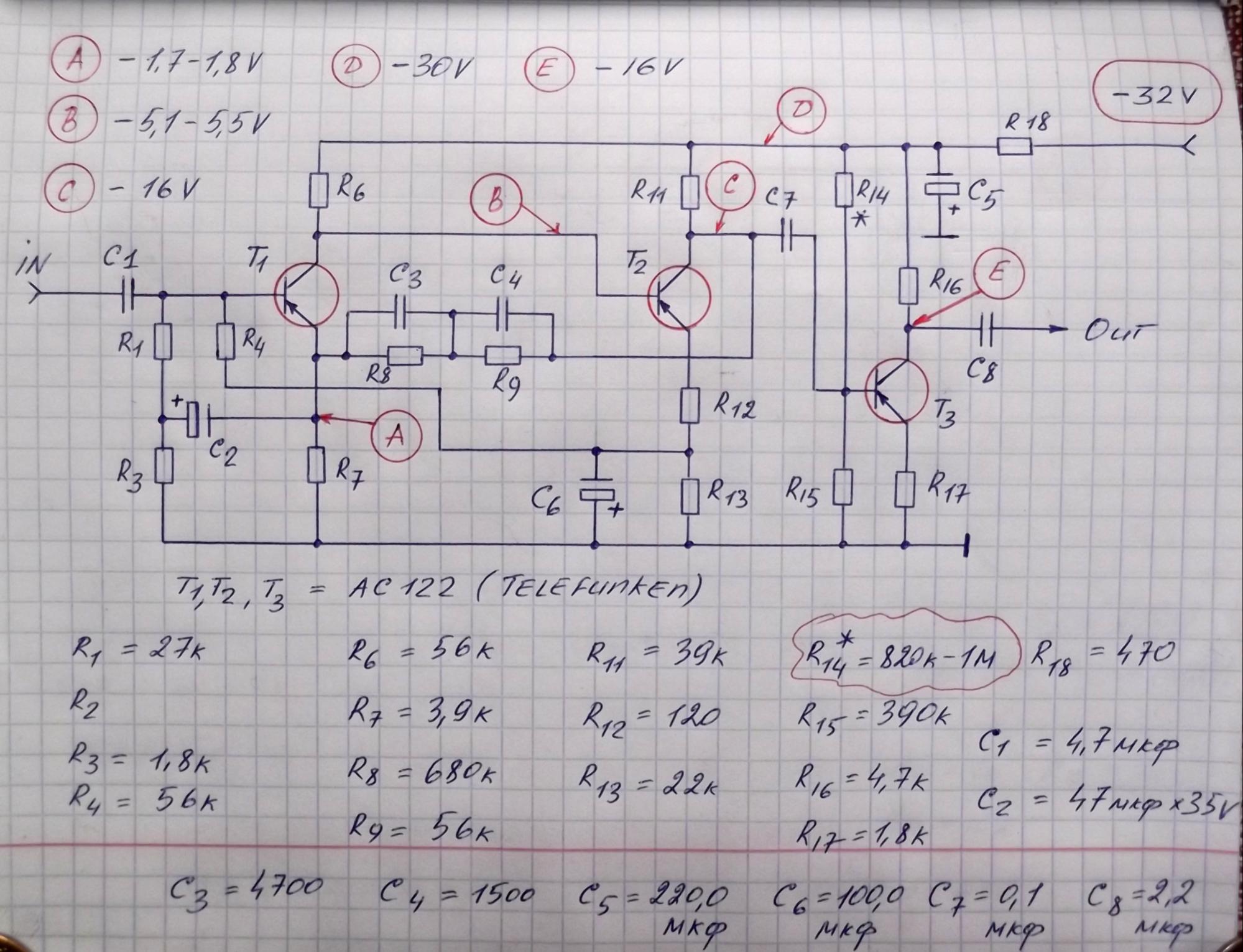

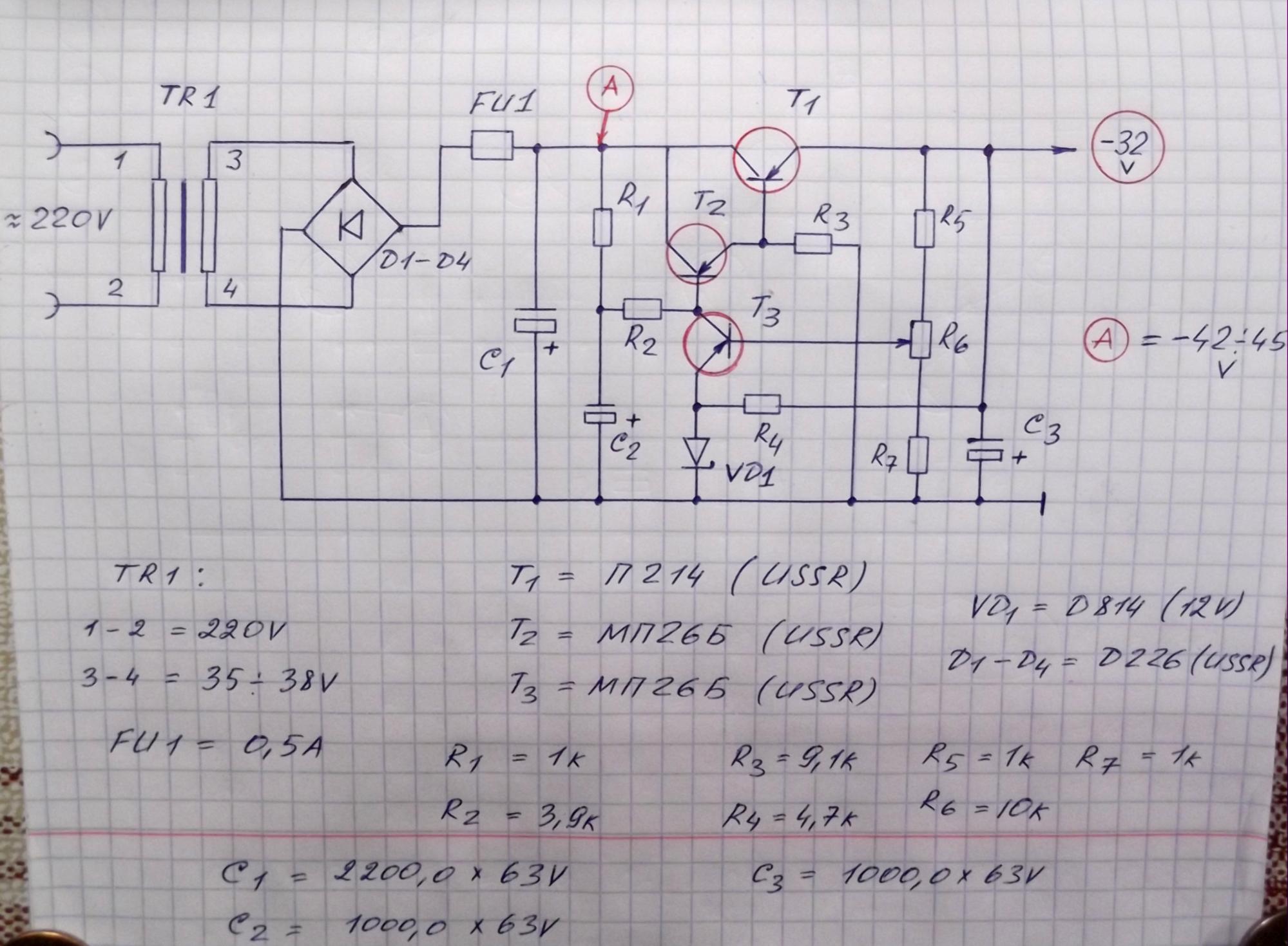

The basis of this scheme is Telefunken TV-206 . I've upgraded the basic scheme a bit . The changed values of the correction ( in TV-206 applied correction Teldec ) . And added a single transistor stage . Diagram of the Phono preamp and its power supply@ vsmusic:
Are there circuit drawings available of your low noise Ge-preamps?
Impressive draughting skills there - using a stencil? Took me a while to convince myself it wasn't computer generated!
Thanks! And now compare with AC150 ;-) : https://www.web-bcs.com/pdf/Tf/AC/AC150.pdfAC-122 - low noise transistors . View attachment 853335

Yes - using a stencil . When I make a device, I always use a drawing on paper ... Bad habit 😀Impressive draughting skills there - using a stencil? Took me a while to convince myself it wasn't computer generated!
