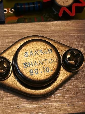

Interestingly, their own pics clearly show two types of output transistors. The one set looks very convincingly like NOS B337, while the other looks like...something else. The cost of replacing the outputs is not prohibitive if they turn out to be fake.
Otoh, seeing there is no thermal compensation or effective cooling, even the modest 2W of dissipation per device may get Ge into trouble, especially in a case with poor ventilation. It will be ironic if only silicon devices survive 🙂

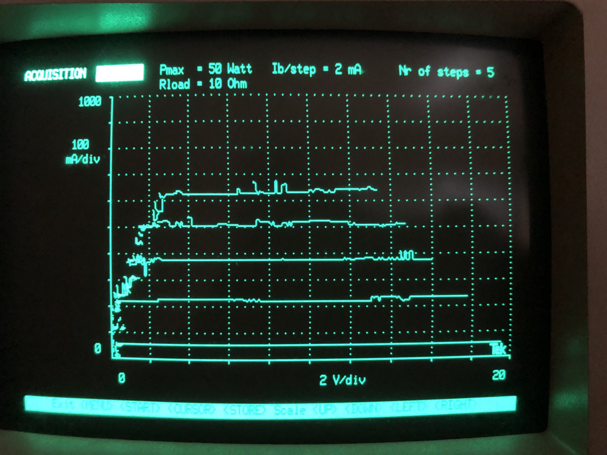

A friend of mine has a Tek curve tracer so expect some more data.

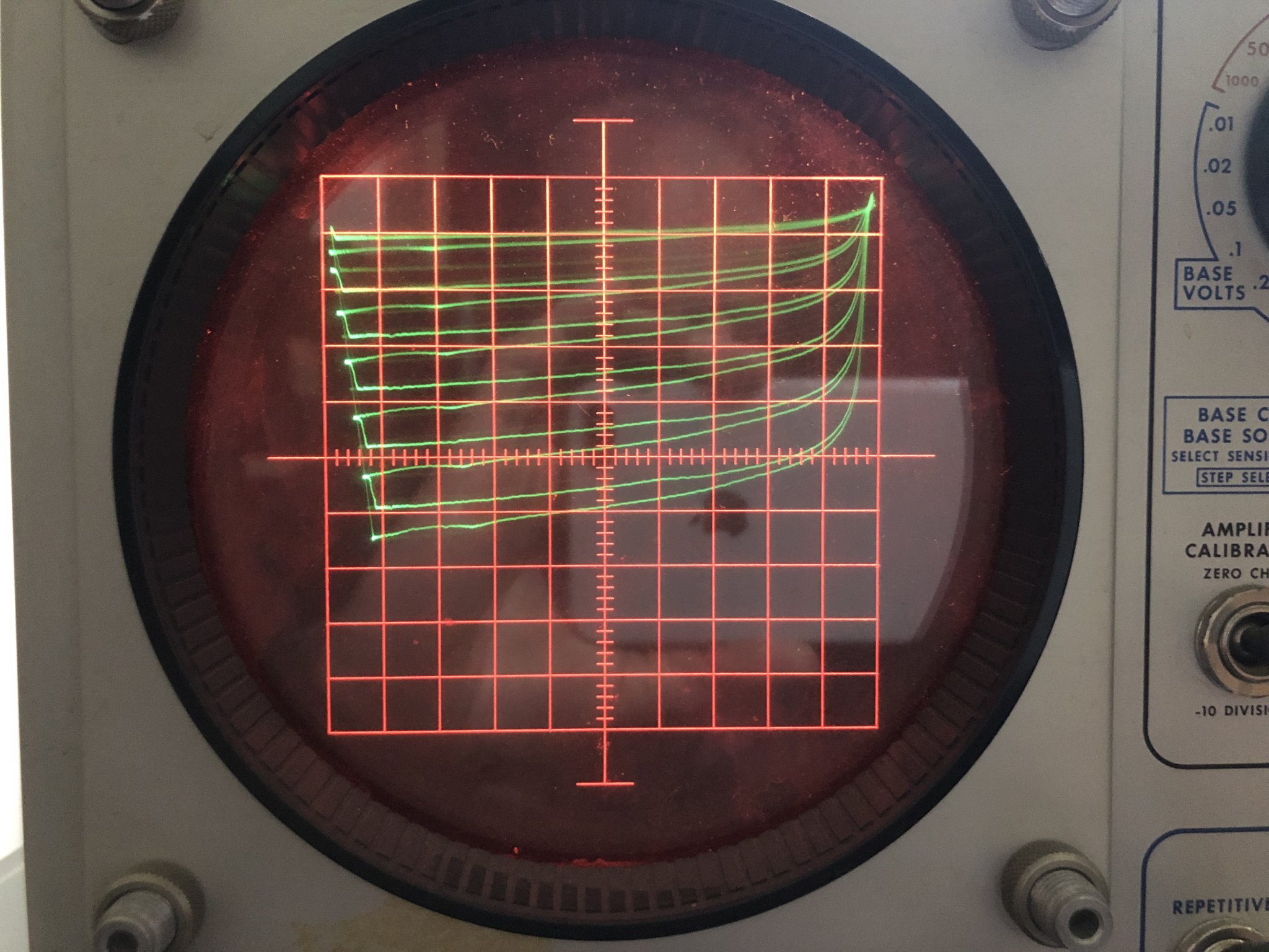

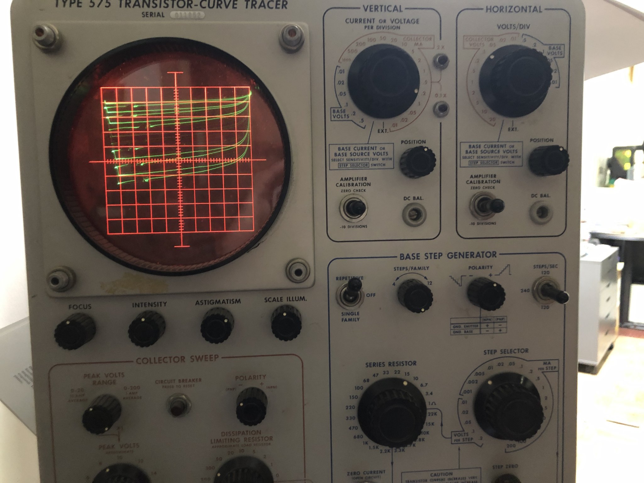

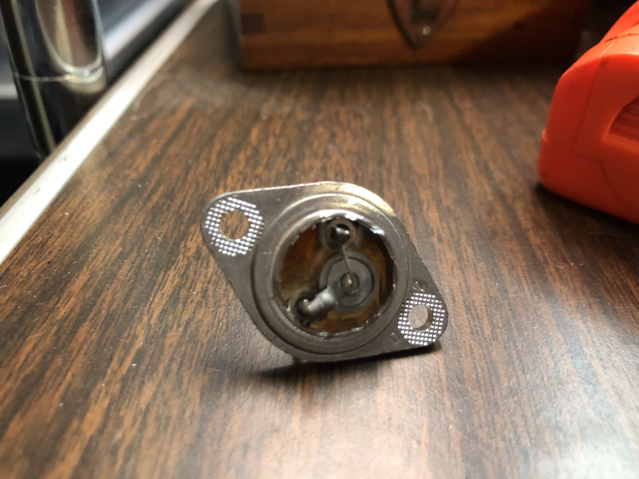

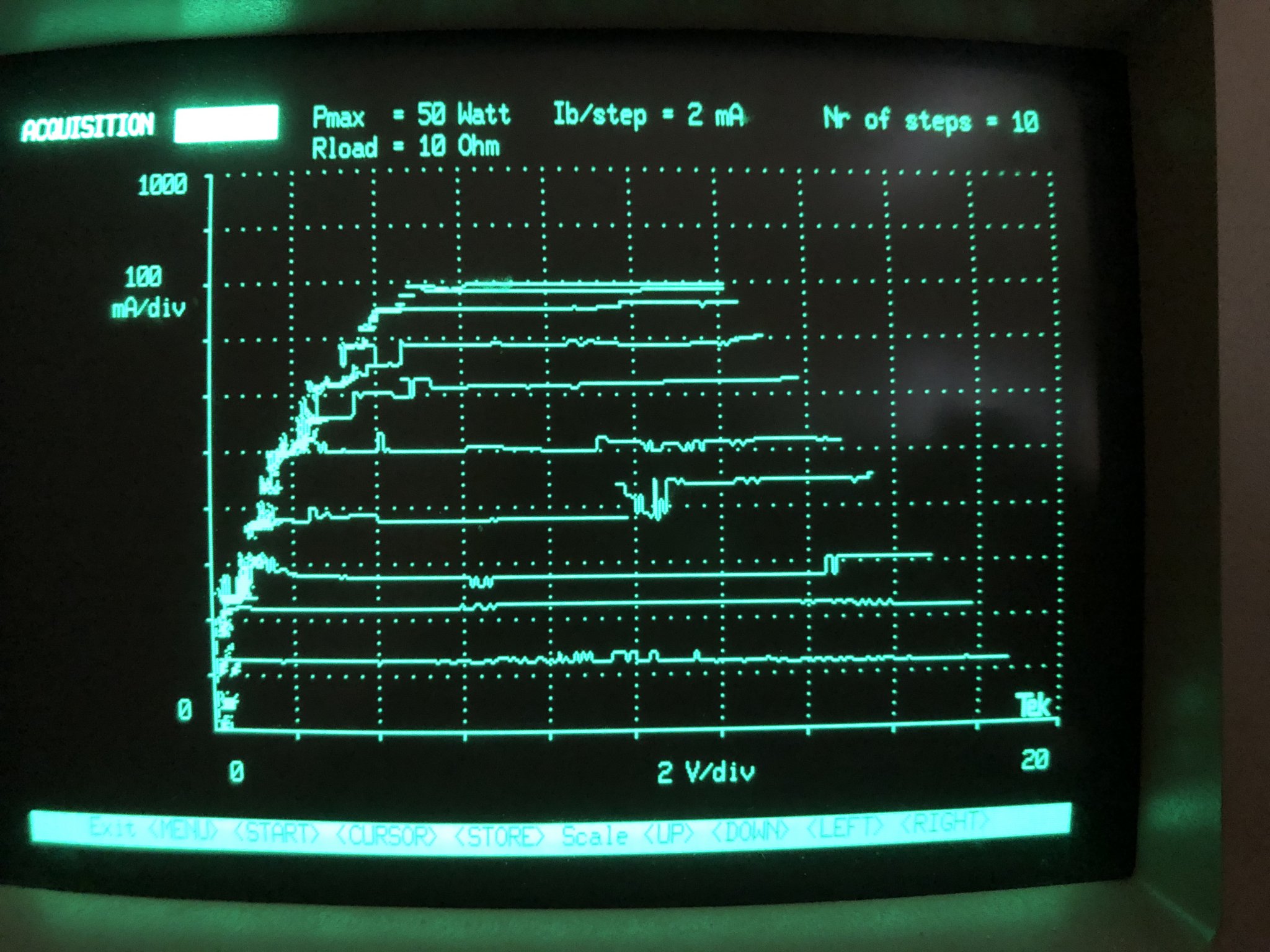

Ok finally got a chance to play with the curve tracers. First I tried the Tek 571 which seemed a bit noisy or perhaps was just having a bad day. Then we busted out the tube based Tek 575 and the plots also look pretty poor. For reference a 2N3906 looked flat and linear as ever on the 575. My buddy thinks these transistors are either rejects or designed for switching purposes. The lot seemed to have different date codes and slight differences on package stamping. We decided to cut open one of the bad ones and you can see the massive disc of germanium inside.
Oh and on the Tek 575 you can hold the transistor in your hand and watch the plots drift right off the screen!
This would be the expected behaviour with a GE transistor.
The scary part is one even drifted by itself at a low current scale.
Could you show Bendix Ge photo with Tek 575 ?..Then we busted out the tube based Tek 575 and the plots also look pretty poor. For reference a 2N3906 looked flat and linear as ever on the 575.

Those photos were all different samples of the Bendix transistors. Here is one more showing the 575 controls. I did have the current cranked up for one but the plots didn't look any better. Maybe next time I'll see how some soviet transistors look. MP10, MP26, 1T806B, P206.

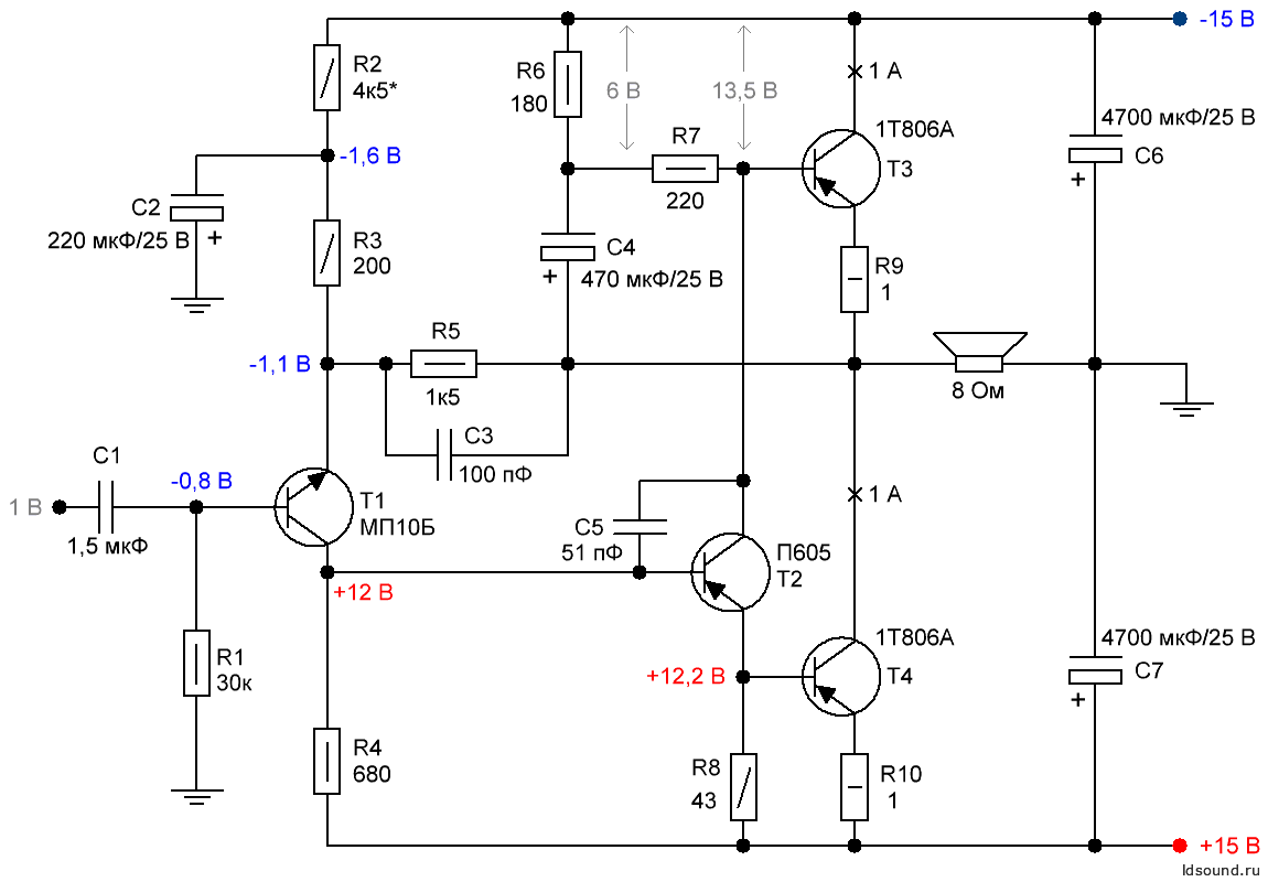

JLH on germanium transistors of the USSR. The last circuit 2021.
Just wanted to say I prototyped this circuit (minus the 4700uf rail caps) and on my linear bench supply the performance is pretty poor. The output transistors don't have heatsinks so I can only test for 30 seconds or so before they get hot.
At 1v input it's putting out 6.5 watts into 8 ohms at 5.0% THD. The DC offset at the load is 0.7v. Once the heatsinks arrive I can do some more tweaking and see what's going on. Amazon sells heatsinks for solid state relays and they seem like a good fit.
You can find out more here.Just wanted to say I prototyped this circuit (minus the 4700uf rail caps) and on my linear bench supply the performance is pretty poor.
https://ldsound.ru/jlh-germanium-transistor-amp/
I didn't make this circuit. The amplifier works in class "A", so you need to use the appropriate heatsinks.
+ 1 for make work germaniums in good conditions in class AThe amplifier works in class "A", so you need to use the appropriate heatsinks.
Your work is low quality or bad joke ?....the performance is pretty poor. The output transistors don't have heatsinks so I can only test for 30 seconds or so before they get hot.
You didn't even get as far as my second paragraph. I know the transistors need heatsinks but don't have them yet. With the link jpatay provided I now know that this amplifier is only rated for 5-6 watts and it was into clipping. Reducing the input to 0.7v reduces the distortion to 0.2%. Once the heatsinks arrive I will do a better analysis.
