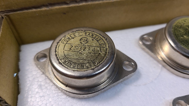

After watching the NP interview where he discussed his interest in Germanium, I ordered some parts. The parts have begun to tricke in.

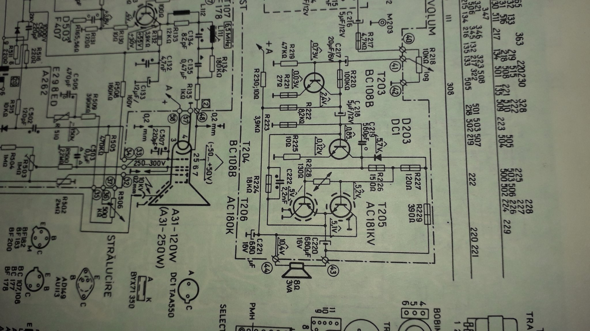

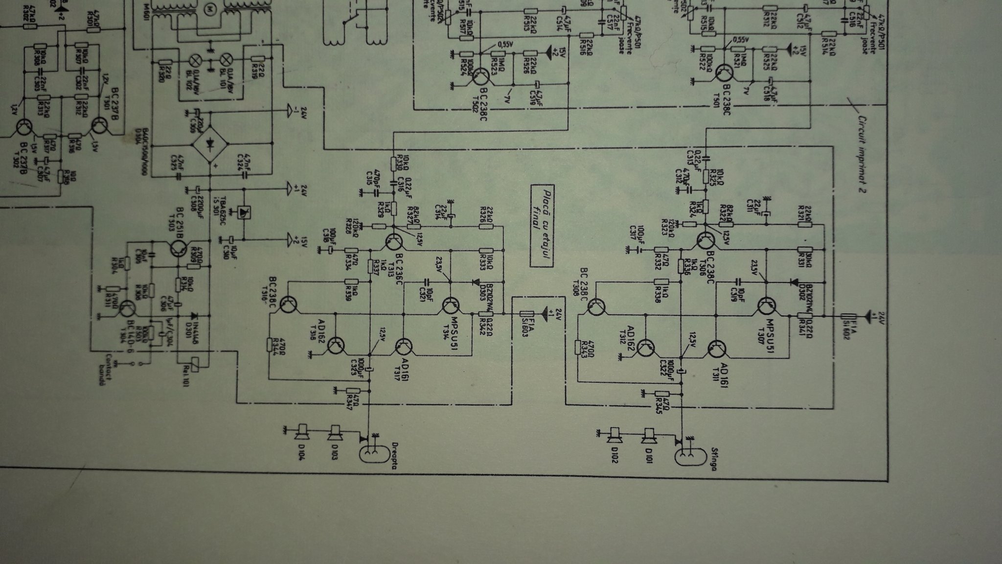

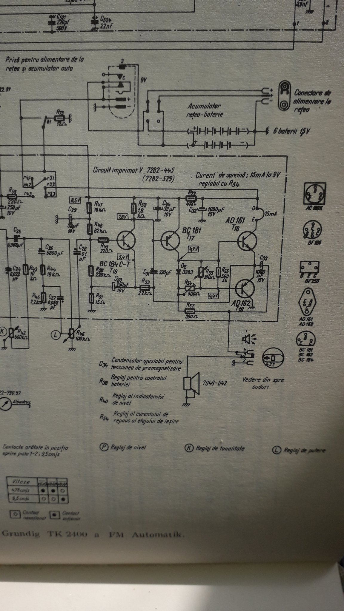

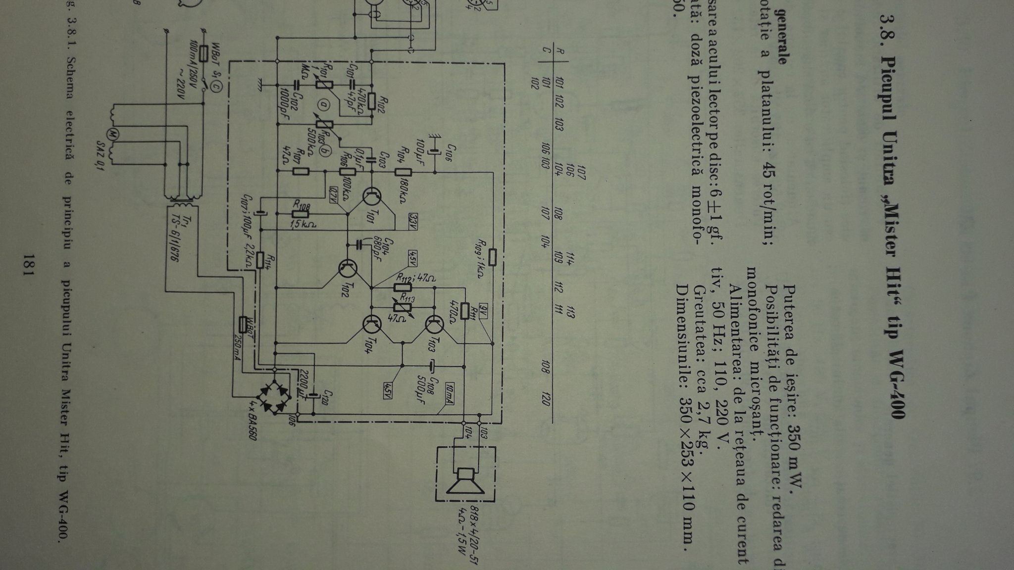

What makes me wonder is why N.P. takes the credit for being the first person to bias a speaker with a direct current.In just one book from 1974 I found more than 5 schematics of commercial amplifiers tape machines, portable tv sets and amplified turntables made in the 60's and 70's that used to derive the driver's current through the speaker using a form of cheaper bootstrap at the same time , avoiding thus the use of a capacitor.In some cases a 470 ohms resistor was in parallel with the 8...16 ohm speakers to limit the current through speaker.Those in the pictures were made by germans , polish and romanians...most of the basic designs being actually german(telefunken, saba, grundig) designs from the 60's.Those currents were in the order of tens of milliampers with a 24 v supply , but the speaker's maximum power was below 5 or 10 watts having some 4...16 ohms impedance so they were considerable for speaker's wellness...especially in the case of a short circuit...

Are you sure about that? I don't see any refference to old push pull germanium amplifiers that already had a severe imbalance by design using two very different devices for npn and pnp while pushing or pulling a dc current through a speaker(both positive and negative supplies were used for that matter ) and yes...that current was fixed too simillarly to NP CCS cause you'd need specific bias for the final stage through the NTC resistor and the driver is class a fixed current.I only see a refference to Barry Thornton using UA 709 op amp externally loaded with a resistor to imbalance its class B output stage.
