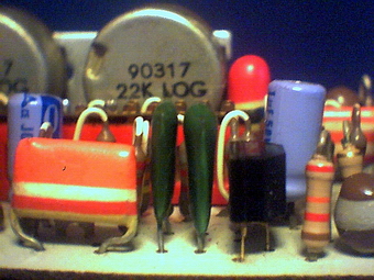

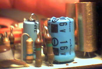

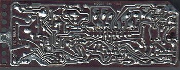

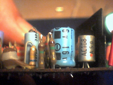

I am showing you pictures of the Philips Mini Cassete Recorder, made in 1967 this model had some Silicon transistors too...earlier models used only Germanium transistors, this one is already using Silicon units, mixed with AC127, AC128 and AC187 and AC188 units...those were very commom, to full complementary output around 2.5 watts RMS over 4 ohms.

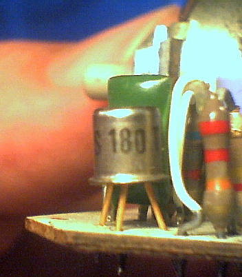

Other line, very famous also, a non Philips line was made with glass...very pretty and thin transistors, painted black to avoid the Photoconductivity of those early transistors.... they are named OC....OC71 was very famous.
Leads were easy to broke...this problem we have now a days... terrible that...leads broke too much easy!
Colector was not connected mechanically to the aluminium case...so, heat dissipations was awfull, despite the use of thermal compound.
Transistor turn very famous by the distortion produced, because when silicon units entered the market, the factories suggested their substitution, informing replacement charts.....but Silicon units had much more gain, the result was saturation...terrible distortion...also, 200 milivolts were not adequated to bias those transistors, and many guys did not made modifications in biasing.... the result was a bad fame.

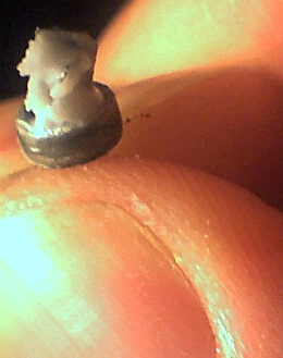

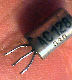

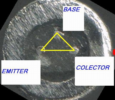

They used to have red and blue dots, to turn easy and fast identification when PNP or
NPN transistor...i do not remember with precision, but i think the dots were indications to the Colector lead.
Other brands used different marks, 2N models used other kind of black dots..... glass units, black painted, had white or yellow dots.
Was pretty and interesting.
