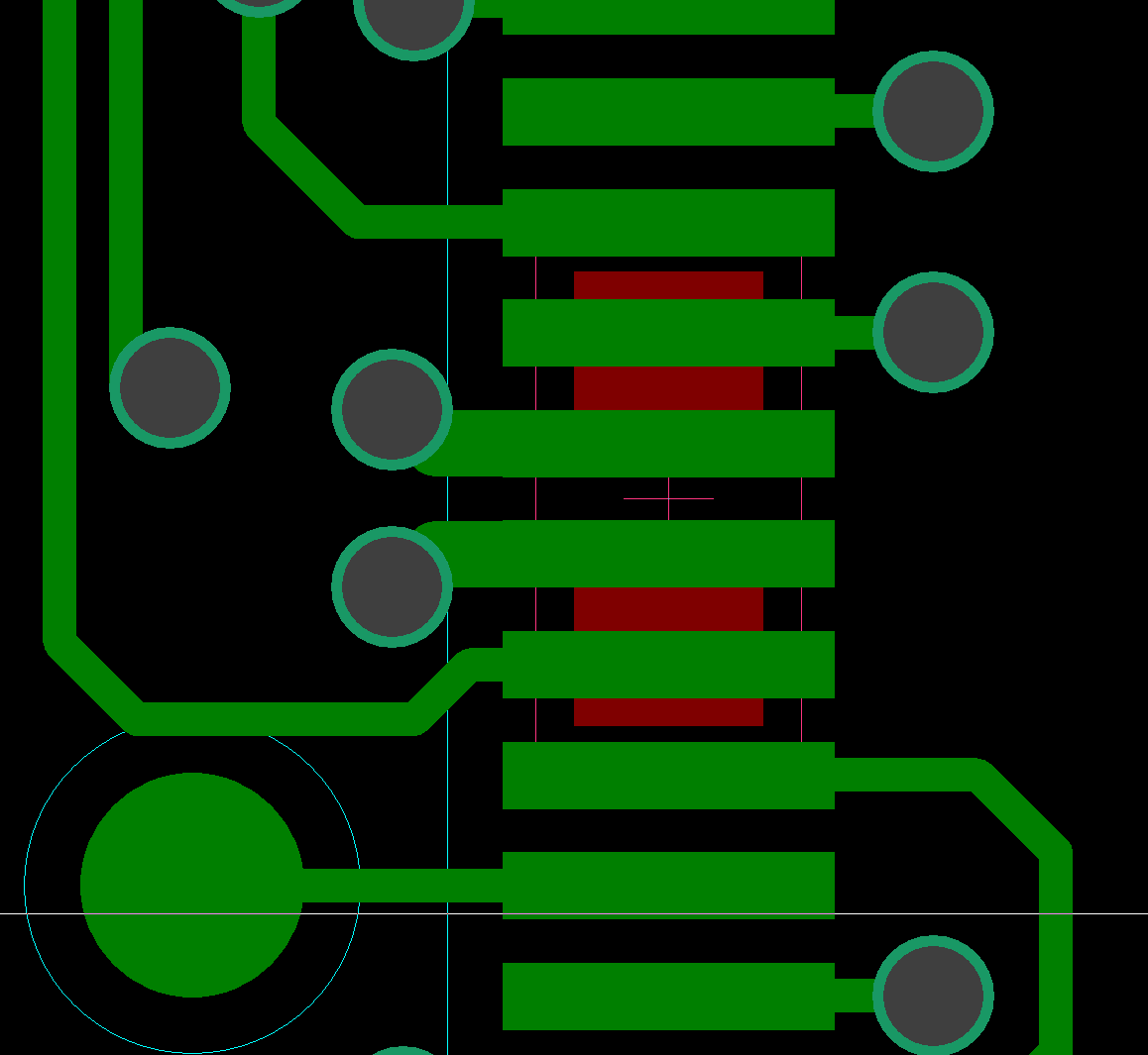

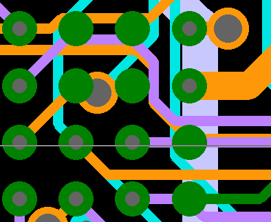

The other picture is HDI layout, via in pad, 2mm per side 0,5mm BGA, 8 layer board copper turned off for clarity.

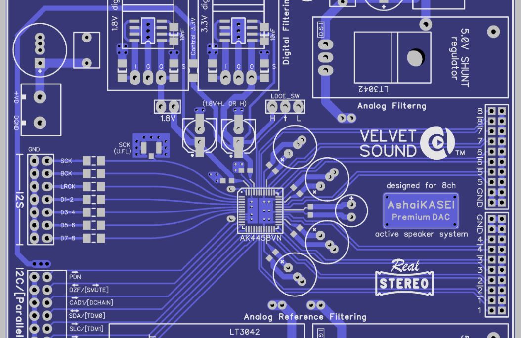

How hot will the shunt reg get... Some copper on the board will help protect the board and get rid of a bit of heat if its laid flat.

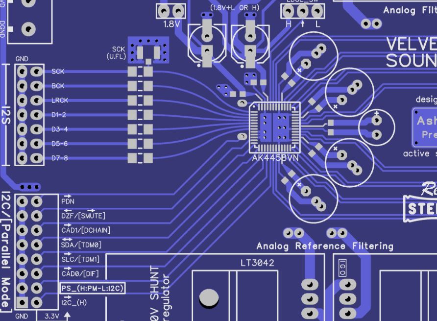

I would move the SCK uhf connector to the end of the line a t junction on a clock line is not a good idea.
Spread the tracks out a bit more on the left hand side of the AK445, especially the 45 degree ones, minimise crosstalk, coupling etc. Use the board space.
SOIC regulators add more copper if possible and more thermal vias, specify 0.025mm or greater plating thickness.
If you start with 0.035mm (1oz) copper after plating you will have 0.052mm copper, starting with 0.018 (1/2oz) may be a better option for the smaller device.

You don't really need curved traces, but they wont harm anything. Its the 45 degree traces below the curved ones, still close together where they are at 45 deg.
The clock is still on a t junction move it to next to the resistor pad and take the feed from that.
yes thats better, the further apart the traces are the less crosstalk you get between lines and thus the best signal integrity and EMC performance.

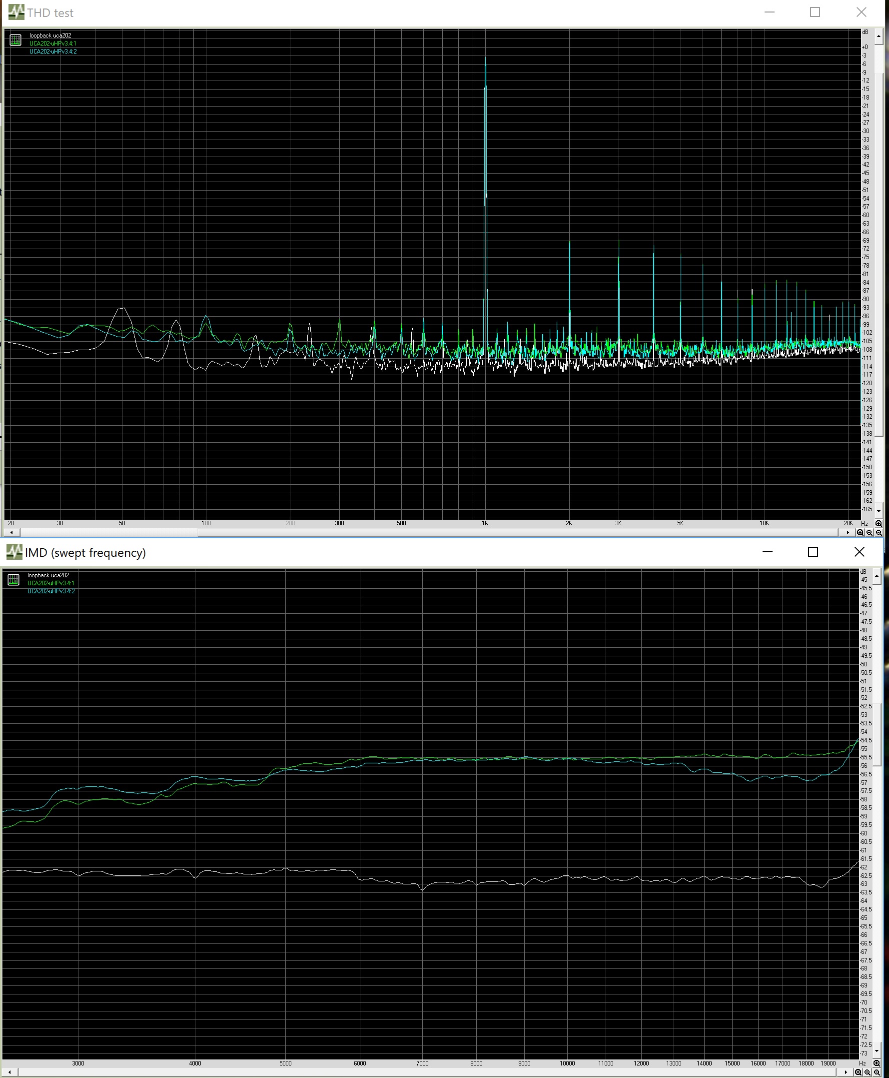

i have tested this on pcm2706 a/d supply pins and there is some difference.
tested is 10uf and 47uf caps or: #10uf-blue #47uf-green on graph on picture.
imd is pretty interesting but i am not sure how good were my tests and is this any representative.
How about the pink traces, what case are they?
Nice plots, they pretty much show what I’ve heard going between those values in that same position on other DACs. While not world peace or anything, there are differences.
