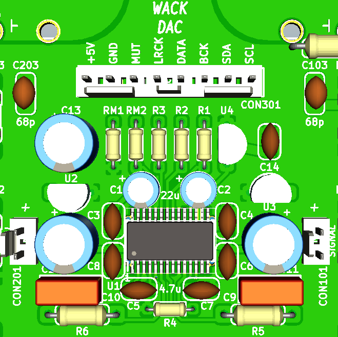

BTW
It is quite possible that the noise is coming from my test amp and speaker and it's ground loop.
I am playing around with the prototype to get it to work with an amp that I am building also, so the temp amp and speaker is a toss away item.
The driver for this DAC comes able to configure a switch to start an amplifier, and at the same time, I am making a power switch that actually works like one should, in conjunction with an Adafruit UPS so no data loss or corruption. When all is sorted and tested and most complete, ya'll can have the files, it's actually quite simple. The original worked great with kodi or whatever, although this is ver2
cheers
cheers
