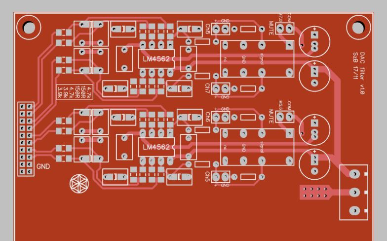

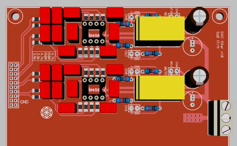

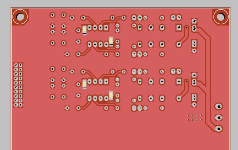

So, I've decided completly redesign my PCBs, as mentioned. I'll leaved the stacked layout and made a side-by-side arrangement with 2x 10x10cm 2 layer boards for DAC and output filtering.
First I've designed the filter PCB, it's the easiest... The to boards will be connected directly with 2 pcs. of angle 2x10 pole 2mm pin headers.
(the other 4 channels on the lower side will be simply mirrored...)

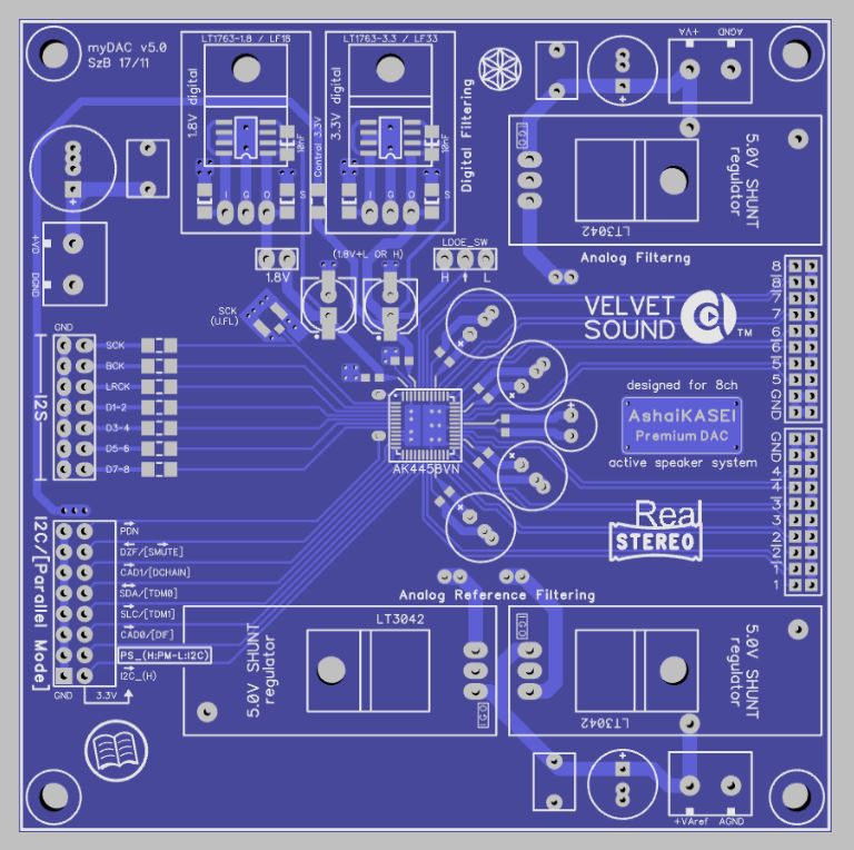

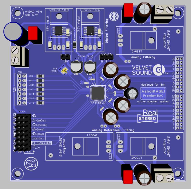

I've completly redesignd the DAC board too, see pictures...

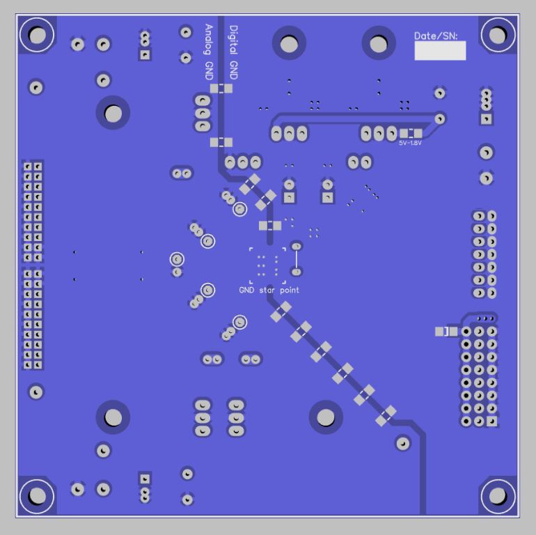

I made the bottom GND layer as solid as possilbe, and placed the bypass capacitors on the top as near to the IC as I could. I used 0603 size SMD patterns, I'm curious how I'll to solder them...🙂
The drawback is that the signal paths are a little bit longer, and I must make some power bridges on the bottom. But I think these are acceptable compromisses.
Some idea to improving?
If the digital decoupling are to be a solid polymer-type, then you may want to do some testing before using a smaller ceramic part with them. They tend to resonate like that I have noticed.
I have some 10uF OsCon SMD caps for that purpose. Should I use bigger (e.g. 0805) ceramic caps?
For the analog side I'd like 10uF Elna Silmic II caps. My shunt regulators are stable by >=100nF, but too big caps would degrade the characteristic.

Looks good
I kinda miss your curved traces though. Wish I could do that.
FYI, I use the MCP1702 type LDO regulator with great results. With my V meter I read dead on each one. Also, 250mA each is well beyond plenty.
