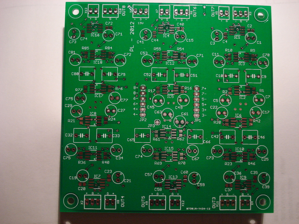

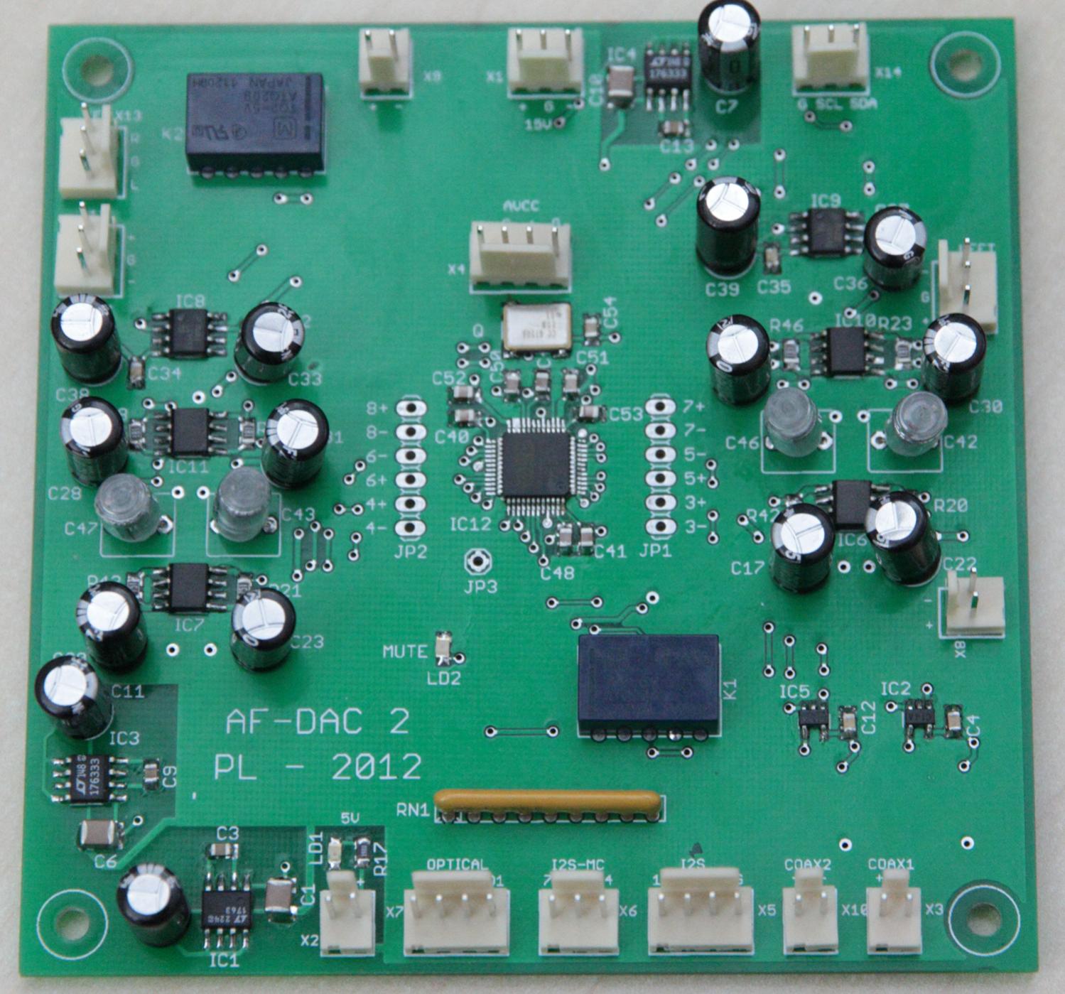

I'am considering 4-layers but it is not so easy. Nr.1: never done before. Nr.2: I must buy a layout software. Nr.3: manufacturing costs more, if I'd like to order 1-2 pieces (only for me).
Regarding point 2, KiCAD is for free and can be used for four-layer boards; I designed the four-layer boards of my hobby DACs with it. KiCAD takes some getting used to and via stitching is a bit clumsy, but it is really a very decent layout program. I definitely prefer it over Eagle - with Eagle you can very easily generate netlists that don't correspond to the schematic you see on the screen, with KiCAD I've never had anything like that happen to me.
I've tryed KiCAD but it is not my software. If somebody is beginning to get to know a layout editor and building up new database than possibly ok, but for me it is very strange and confusing...
Just an example where this stacked boadrs idea comes from, see pics. The pin header must be relative massive if I want to connect two boards with about 2cm distance. Other argument for the 0,1" headers, that I can sneak through the pins with ground filling, in case of 2 layers it is very important. But I'm considering a flexible connection too instead of stiff headers...
I think the JP3 is the GND connection between the boards.
This is an ES9016 board, but I do not want to make an ESS DAC from several reasons... AK4458 is just good or better...🙂

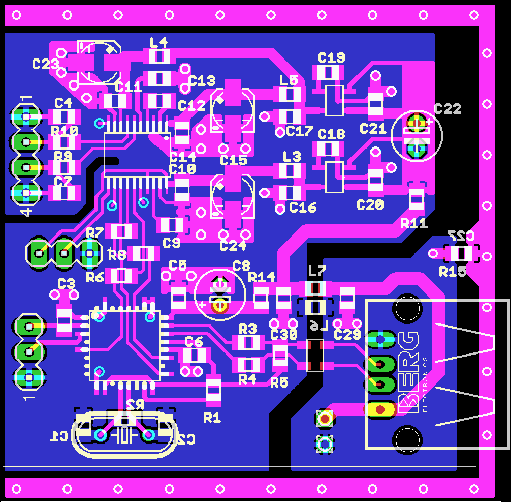

A way to minimize the loop on two layers board is to use a small ground pour on the top layer to which both the decoupling caps and the IC connect and then stitch that to a bottom layer groundplane with multiple via.- ground connenction of bypass caps (bigger electorites and small ceramics): simply to common ground pour or preferred a star grounding terminology?
This pcb is far from perfect but it illustrates the technique.
Yep, hierarchical grounds can work but they tend to take some consideration in design to get right.
Someone got a little carried away with electrolytic decoupling caps methinks on that stacked board set, I figure that with better layout and C0G instead of those film caps I could probably get the whole thing on one board (Possibly even one eurocard) with better signal integrity.
Two layers is a massive compromise for anything non trivial, and seriously four layers does not add that much cost compared to the time saved on layout.
If you are dead set on sticking with .1 inch connectors, at least make them double row and use the second row for ground, that also makes testing much easier as you can use an IDC ribbon between the boards.
Regards, Dan.
Regards, Dan.

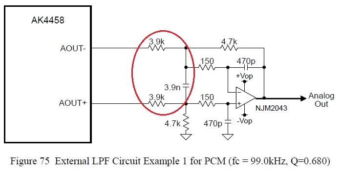

I wouldn't bother with splitting up that rather weird filter, it clearly does nothing very useful with common mode noise at the output of the DAC, relying instead on the opamps PSRR (What PSRR at a few MHz?)...
