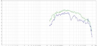

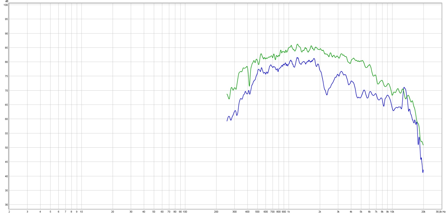

Here's a measurement of a Klipsch horn with Klipsch's own K69 2" driver (blue) and JBL 2446 with truextent beryllium diaphragm (green). No doubt which is better. Would be fun to try ALE driver(s), but they are not exactly cheap. 1/24 octave smoothing, nearfield indoor.
