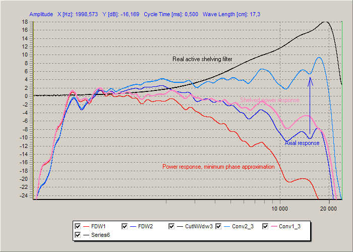

I didn't say it is CD or better in this area 🙂 Can you explain CD? Dr Geddes wrote on AES paper that diffraction horns have +5dB aberrations on frequency response. Keep in mind we talk here about cheapest solution of an unplugged tweeter 🙂 I published power response (red) in this thread:
http://www.diyaudio.com/forums/showthread.php?postid=1371060#post1371060
(it's raw Tractrix response without shelving filter)

Dear Patrick,
I see more highs on Summa polar response. Here's my horn with filter. I don't see weird power response, do you see?
Are you using horns in your playback?

jzagaja said:
Dear Patrick,
The pic you attached displays the behavior I expected.
Because you are using a tractrix horn, the sound is focused into a narrow beam at high frequencies. You can see this in your plot, as the response falls off dramatically as you move off axis.

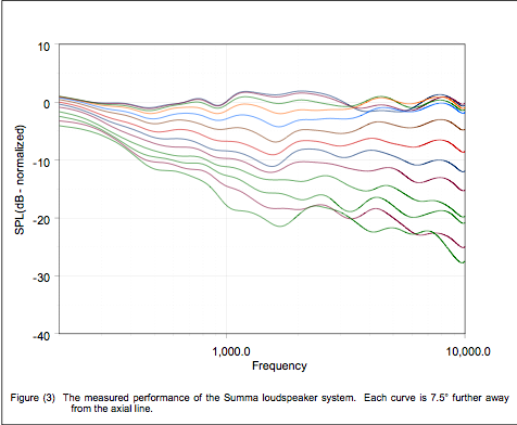

Attached is an example of superb power response. It's from gedlee.com.
In the attached pic, you'll note that the response falls off very very gradually as you move off axis. More importantly, the off axis response is consistent with the on-axis response; you don't see any dips or nulls as you move off axis.
As the frequency approaches 1khz the off axis level grows higher, as the waveguide used in that speaker only maintains directivity control down to 900hz.
At that point another mechanism comes into play, but you'll have to read the pdf for that piece.
This looks like "Controlled Directivity" instead of the misleading term "Constant Directivity". At least I finally know what is actually being referred to after looking at this pic.
