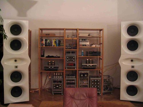

ellyptical wave guide
hi Ged
there is a austrian company, haigner horns, which makes elliptical wave guides.
http://www.theaudioeagle.com/columns/column05.html
They use CNC , quit difficult horns to be done. I had some email exchange with the owner. He sweares that his wave guide is much better than the spherical horns. What is your opinion in this regard ?
Angelo
This can be done, but the common method of doing it - maintaining the same area as an OS waveguide - is incorrect. One wants to maintain the boundary shape, not the area. They are certainly more difficult to make however.
hi Ged
Angelo
Re: ellyptical wave guide
