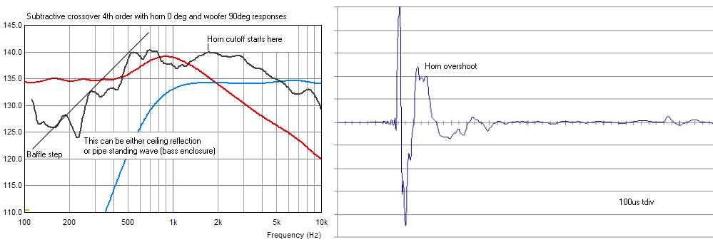

"Uncorrelated' is terminology often used in signal processing for two signals 90 degrees apart. I use it as its part of the familiar lexicon in the field I worked in, a short hand perhaps but a good intuitive description.
In the case I discussed, the trick is maintaining as close to n*90 throughout xover as possible at he listening axis. Anyway, take a look at what I said, and its very easy to model and makes good sense, nit picking about terminology aside.

My horn based on Tractrix profile and standard dome tweeter without phase plug is as good or better than complicated Summa OS waveguide in terms of midrange linearity. I couldn't find solution for Linkwitz-Riley 4th order crossovers - I've got a huge dip at crossover point but maybe I did wrong time alignment. On axis horn starts rolling at 1,8kHz, off axis at 500Hz. Subtractive crossover offers attractive bump from LP section - see appended picture. Overall mix is quite good. These curves contain all room reflections.
jzagaja said:My horn based on Tractrix profile and standard dome tweeter without phase plug is as good or better than complicated Summa OS waveguide in terms of midrange linearity. I couldn't find solution for Linkwitz-Riley 4th order crossovers - I've got a huge dip at crossover point but maybe I did wrong time alignment. On axis horn starts rolling at 1,8kHz, off axis at 500Hz. Subtractive crossover offers attractive bump from LP section - see appended picture. Overall mix is quite good. These curves contain all room reflections.
Tractrix horns can't do constant directivity.
Been there done that.
Please post graphs of power response which prove your tractrix horn is "better."
