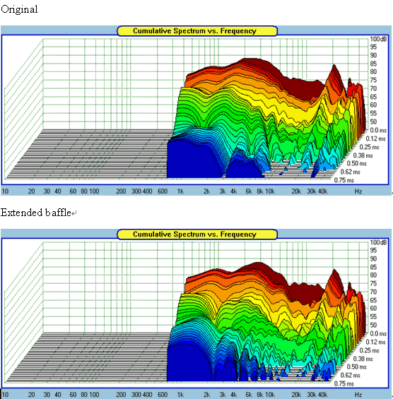

The notch tha occurs at all angles is due to interaction between the diaphragm and the throat. This is interesting, and there might be a possibility to optimize that part.Hello Soongsc,
Probably because at the highest frequency showing dip the (oblical) reflexions ( considered as rays for an easier purpose) can only interfer with the direct wave from a certain distance from the throat .
(See the somewhat simplified graph showing the principle of the oblical rays that may interfer with the not shown direct rays...)

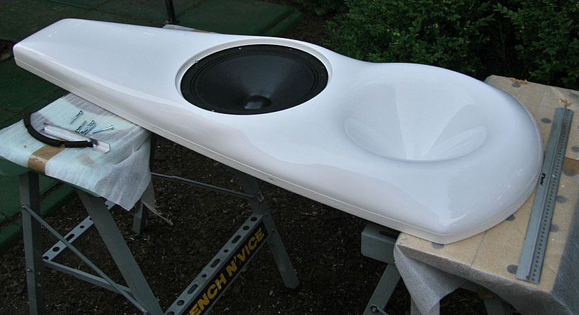

Hello, i am new on here and new to this.. but very interested in this thread as i am employing a friend of mine to build my cabs for me and have searched everywhere for the math to do it without results.. can anyone help me with this?
It is an os waveguide for a bms compression driver.. if someone can advise me on how to work out the math i would be very grateful.... thankyou in advance,

Looking at the CSD before and after extending the baffle, it seems where is something going on below 5KHz. Another hunk of energy seems to come in later, from the impulse which is not shown, it seems to come with a delay that matches the depth of the WG. So I would assume, the lip blend radius will determine the spectral content of this hunk of energy. This means a much bigger wave guide is necessary. But now this also is a very good test article to see what EnABL patterns will do at the edge if we want to keep the small form factor. For the sake of convenience, the exact pattern format will not be followed, but rather just eyeballing a pattern to see what happens.😀... Scott's observation seems also correct that it does not seem to be exactly a hole.

Hi Jamie,
If you search this thread for the word:
spreadsheet
you should find a ton of info.
The program Hornresponse will calculate it for you
