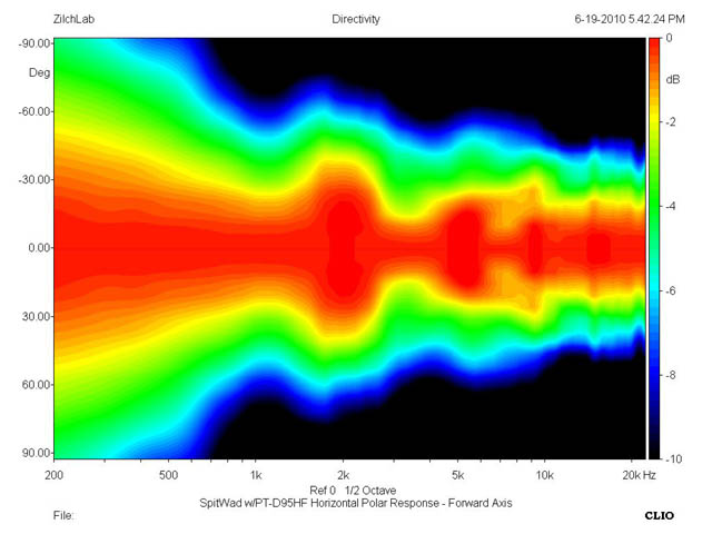

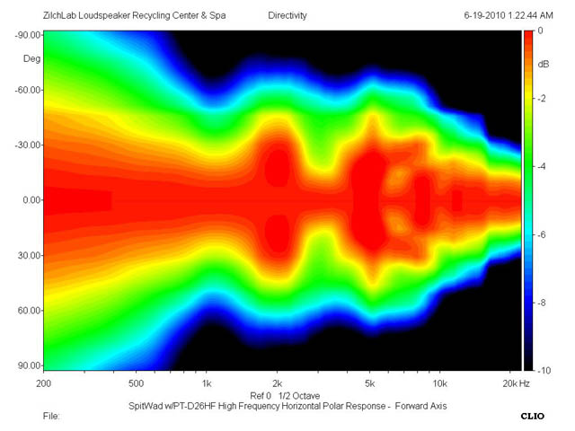

Dunno; kinda looks like dipole directivity vs. waveguide directivity in the same package to me.... 😀Hey Zilchlab, now 1000 fingers are itching to type that you don't know what you are talking about.
But not one finger to try it.
You gotta normalize them, is all.Thanks for making my point Zilch. 😉 If we blind test those two speakers you linked and prefer one over the other, is it because of different directivity or could it be this?
Open in separate tabs and toggle between the two:
http://www.diyaudio.com/forums/atta...d1278525595-geddes-waveguides-sw26a_hpmn2.jpg
http://www.diyaudio.com/forums/atta...9d1278525595-geddes-waveguides-sw95_hpmn2.jpg
Close enough to answer the question?

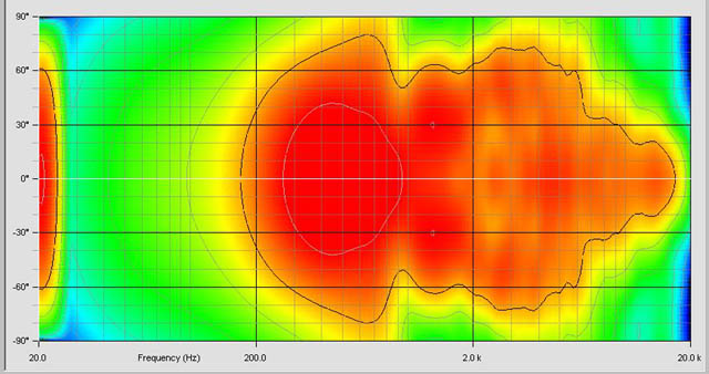

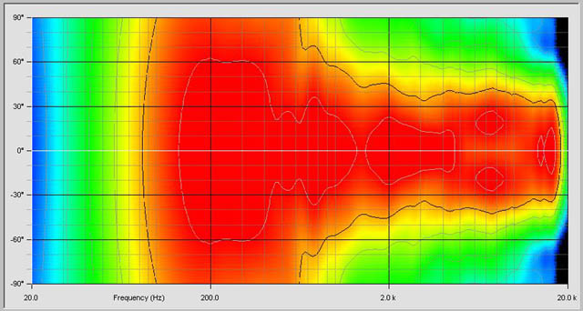

http://www.diyaudio.com/forums/atta...-waveguides-orion-directivity-per-geddes-.jpg
http://www.diyaudio.com/forums/atta...waveguides-nathan-directivity-per-geddes-.jpg

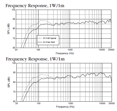

I wasn't paying much attention to that when I did it, but the filters could not have been much different for me to accomplish it so easily. I may have the files, if it's an issue.Agree that might be difficult. Take the Meyer Sound CQ series, for example. The CQ-1 sounds smoother than the CQ-2. Is that directivity, or crossover work or both? Ditto the UPA-1 UPA-2.
JBL's highpasses are substantially more different than anything I might have done experimentally to acquire the directivity data:
http://www.jblproservice.com/pdf/AE Series Compact Models/AC1826-WH.pdf
http://www.jblproservice.com/pdf/AE Series Compact Models/AC1895-WH.pdf
