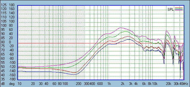

After some quick runs of measurements, it seems Earl was correct. What looks like an on axis hole is due to the lip curvature, not the abrupt cutback after the lip is tangent to the baffle. Scott's observation seems also correct that it does not seem to be exactly a hole.In continuation of the wave guide posted here,

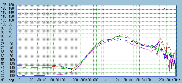

I have finally slipped in some time to extend the baffle of the wave guide beyond the lip to a round baffle with a diameter of 40cm. I should be doing some measurement either Friday or the comming Monday. Are there any guesses what this will do to the response?😀 The curves up to the blend with the baffle remains the same. The diameter of the WG where is blends with the baffle is about 22.5cm.
What it seems like is that the lip is causing diffraction such that the dip and peak shift towards a higher frequency as the mic is moved away from the WG.
Hello Soongsc:
As you describe it, this behavior could be also interpreted as related to reflexions or HOMs appearing deeper on the wall of the waveguide when frequency rises.
MigeO's simulations have shown that the longer the flat part of the profile is, the larger is the "axial dip" (also if memory doesn't miss me the same variation with frequency was shown).
Best regards from Paris, France
Jean-Michel Le Cléac'h

Hello Soongsc,
Probably because at the highest frequency showing dip the (oblical) reflexions ( considered as rays for an easier purpose) can only interfer with the direct wave from a certain distance from the throat .
(See the somewhat simplified graph showing the principle of the oblical rays that may interfer with the not shown direct rays...)
.The dip occurs only outside the WG as previously measured.
