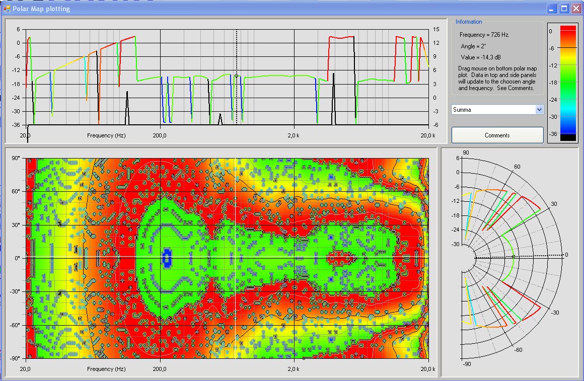

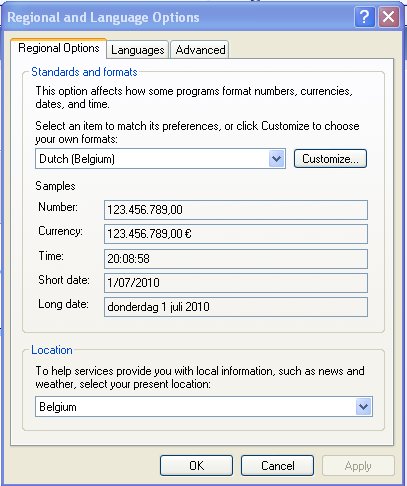

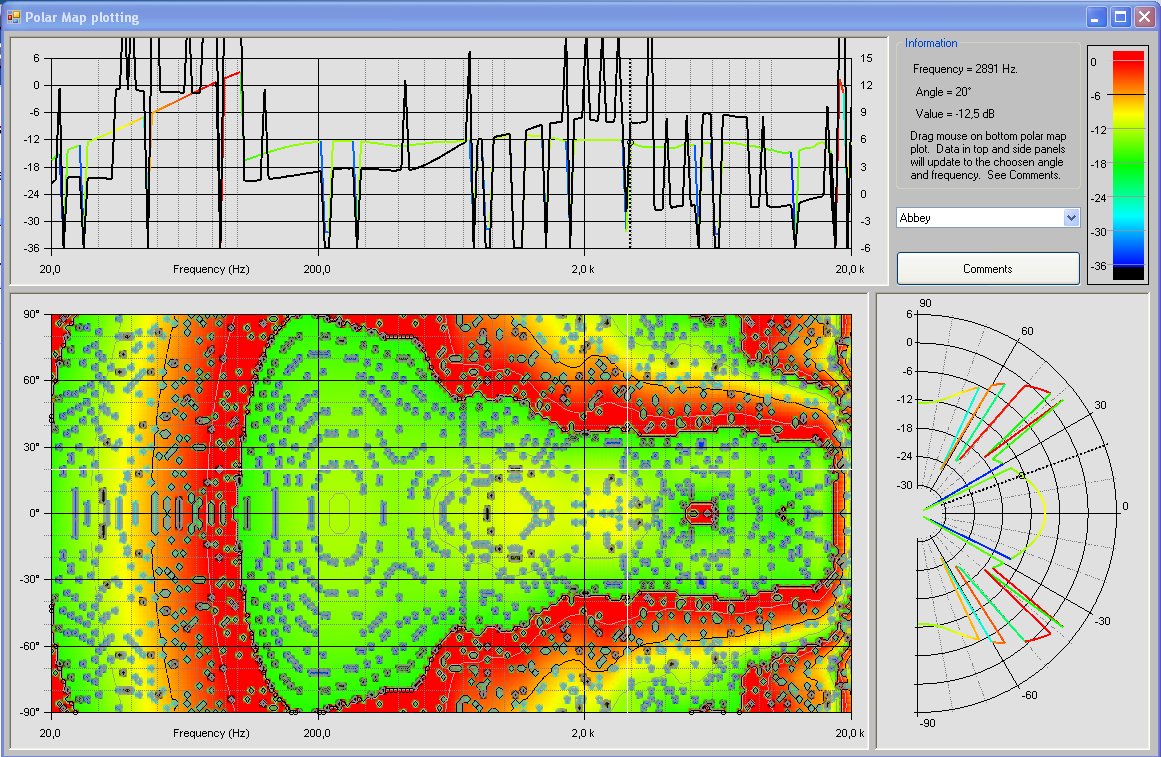

Hello Dr. Geddes,
When I run your program om my pc (Win XP pro SP3 Eng) I get incorrect polar plots (see attached screenshots).
I did some experimentation, and found the problem disappeared if I changed the regional and language options from Belgium to us (see screenshot).
I believe you can force dotnet to use a specific region and language (in your case US), instead of using the system default (by setting the UICulture I believe). The bug probable originates from the different use of points and comma's in the nummerous calculations.
After I made this change you software ran perfectly. I can imagine some of the other problems reported here can also be resolved by changing these settings. Normally you should be able to simulate this bug by changing you settings to Belgium.
What I would very much like if you could make you software available (as as exe) that allows to imports measurements made with holmimpulse (I suspect you use the function "export all measurement" with somekind of naming convention for the different measurements). This would be a fantastic supplement to the holmimpulse software, and we would then be able to compare our own prototypes (and other commercial speakers) with the same tool.
Best Regards,
Wim

Thanks Wim, that makes perfect sense. The data uses "." and "," for completely different things here than there!! Now all that needs to happen is for you EUs to change! 🙂
But I will check out the Regional settings. Thanks
My original idea was to offer the software as a link to Holm. But now I am not so sure. Holm seems to have changed, Ask Bojessen no longer seems to be arround and the software has not updated in a long time. This is precisely why I objected to its being free. The idea of "free" software just goes against my capitalist inclinations. There has to be an incentive to keep the software alive or it will die. There is not a single piece of software that I use that is free (Ahh - except HOLM). The free stuff just doesn't work right. (A few small apps maybe, but nothing substantial.)
If HOLM doesn't become supported, then I will just go ahead and write this part of the project myself as well.
Yes, I do use the "export all curves" aspect of Holm. No special naming convention is required. You just need to be able to find the file.
Thanks again for that note on "," & "." - that is certainly the issue.

Any differences must be in your perception because the data set is exactly the same in all the plots. The data is a matrix - the top plot shows rows and the side plot shows columns - exact same data in all of them. No smoothing done in one of them thats not in the others. The smoothing is 1/20th octave in frequency.
Yes, perception. But when I look at your contour map for the un-normalized Nathan the black line seems to indicates a pretty constant beam width of around 40 degrees at about -6dB. However, when I look at the polar plots at 1k, 2k, 4k and 8k what I see is not particularly uniformity with frequency. And at 8k Hz the polar response looks particularly unsettling with 3.2 dB peaking at 18 degree off axis relative to the on axis level. Normalizing the contours by the on axis response would certainly make the -6dB beam width look worse (more pinched in at some frequencies and wider at others). All of your designs seem to have a range between 5 and 10K where the polar response show depressed on axis response with some off axis peaking at about 15 to 20 degrees. Constant DI on axis, even if achieved, doesn't necessarily mean constant polar response. The prime example of this is a dipole and a cardioid. Both have the same on axis DI but the polar response is completely different.
Don't get me wrong, uniformity of the beam width is certainly better than most other designs I have seen, but I think uniformity of the polar response could be better. I am actually some what surprised that it isn't.
I'm also wondering if your Abby data might not have the same problem at the Orion data, at least on axis, since the tweeter level is depressed overall by about 6dB on average above 5k Hz. Seems strange to me. That just shouldn't sound right if true.
