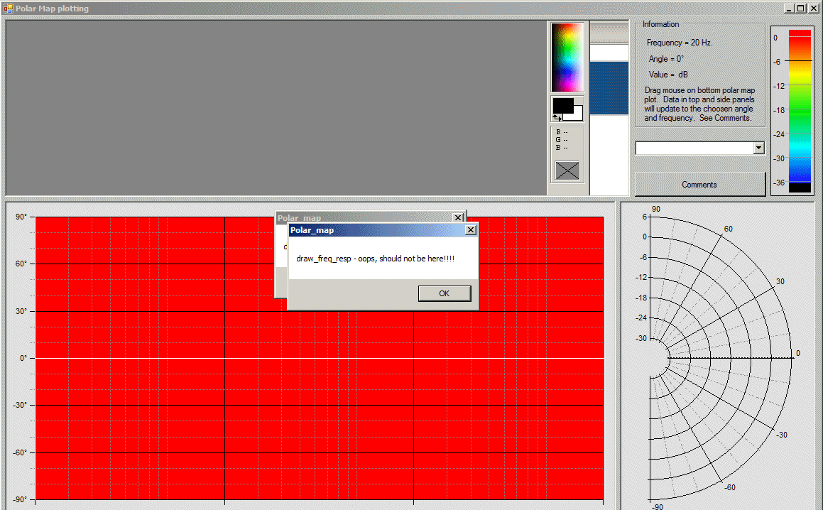

When trying to run polar_map from Firefox in Vista, I get this message.
Afterwards polar_map freezes and can't even be shut by the task manager. Any idea, what's going wrong?

The problem is that I am just not that good a programmer for web apps - never done it before. Most of the errors seem to come from countires other than the US, but as I said, it ran fine in China. I could see that if the connection "times out" then anything is likely to happen since I don't do anything to detect that. The program failed for me a couple of times when I didn't have an internet connection.
Rudolf - the right part of the top plot is not part of anything that I wrote, so there seems to be a conflict with something on your computer. The solid read means that it had data, but they were all the same value - sounds like a connection problem.
I'll see if I can post an installation file so you can run it stand alone without a connection.
