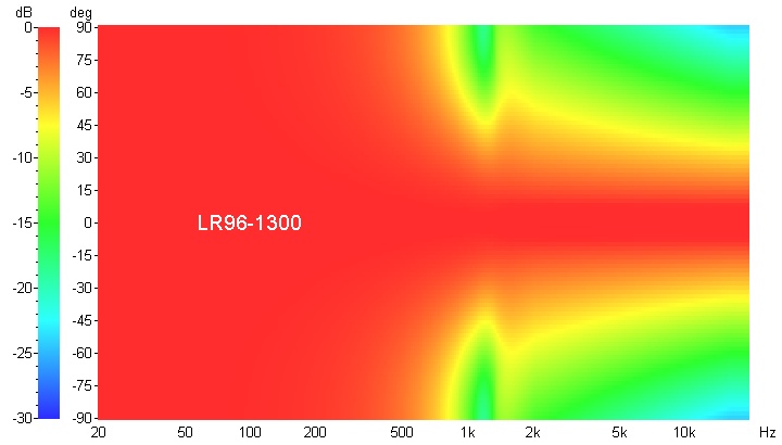

Hey Paul,
You can do it two ways. For these, I just built a simple off-axis text file for the horn based on Brandon's measurements. You specify a few frequency, angle and dB numbers and it will interpolate the rest.
F:500
H: 15:0
V: 15:0
F:1000
H: 7.5:0 45:-3 67:-5
V: 7.5:0 30:-1 67:-3
F:2000
H: 7.5:0 45:-6 90:-14
V: 7.5:0 30:-6 90:-10
F:16000
H: 7.5:0 30:-6 90:-24
V: 7.5:0 20:-6 90:-43
The more accurate way to do it is to copy/paste all your measurements into a single file like this:
[data]
## EXTENDED DATA ## OFF AXIS <X,Y>
[data]
[data]
[data]
