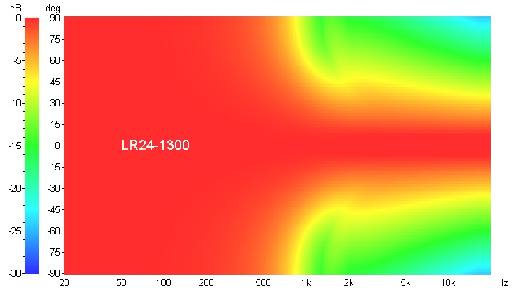

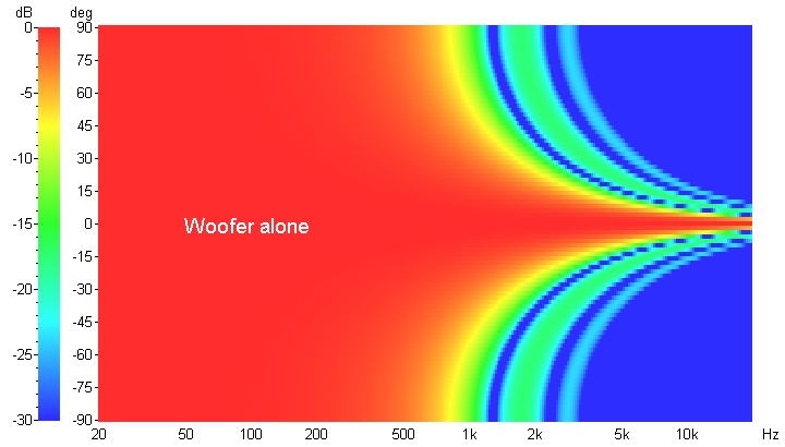

I think the important thing is to not cross so high that the woofer's pattern narrows and then the pattern widens again as the tweeter kicks in. These sims are based on the measured directivity of the QSC horn and the theoretical directivity of a 15" woofer (13" piston) and a hypothetical 1" piston. Both are crossed LR4 at 1300. The 15" is just starting to show a bit of wide-narrow-wide so 1300 is probably about as high as you'd wan't to go with that driver. But the 1" woofer shows a nice smooth transition. A too-big woofer or a too-high crossover isn't so good. A too-small woofer or a too-low crossover is no problem.Yes. If the directivities do not match then the polar response through the crossover will not be smooth, nor will the DI for any angle. This is a critical part of the design.
15" woofer
1" woofer
Unfortunately those sims don't look much like actual measured data for a 15" woofer (see Summa at GedLee LLC under loudspeakers, the polar map program). And your conclusions don't seem right either. A 1" woofer vs. a 15" woofer!? Those sims don't look right at all. (Or maybe I don't understand what you are doing.)

If by this point you mean that both the woofer and tweeter are omnidirectional pattern, there is some truth to that, but not if any kind of directional response is desired. You will note that the 15" speaker in the Summa is not even approaching omni until about 400 Hz. You can't really take a tweeter that low. Basically, I just don't agree with your point, or, again, I don't get it. There is one and only one frequency at which a directional waveguide and the woofer match directivity. You either crossover at that frequency or you will not have an optimal situation.

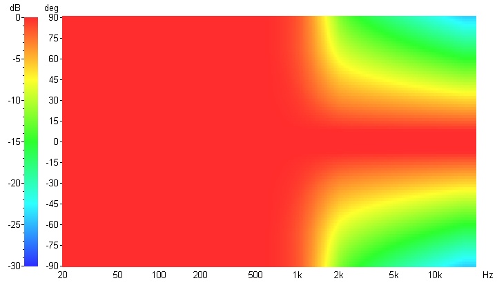

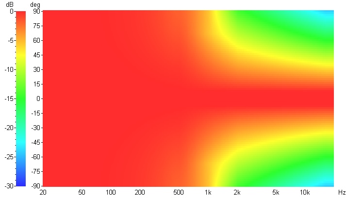

Maybe this will show it a bit better. Both of these have 15" woofers and the QSC horn. The first crosses at 1300 and the second crosses at 500, LR4 acoustic.
Now both presume that you can EQ the horn's response to LR4 acoustic and that's probably not possible at 500 with the QSC given its steep roll-off below 800. But I think the principle still stands.
Upper limit of XO frequency is determined by the cone diameter.
Lower limit of XO frequency is determined by where the horn/waveguide starts rolling off.
It may work out that matching directivity gives you the one and only best frequency but it may not. Consider a 10" woofer with a 15" waveguide. You could cross that considerably lower than where the directivities match and it would work just fine. It might even work better when you look at the big picture considering driver capabilities, vertical polars, etc.
1300 XO
500 XO

Sorry Dennis, but I remain unconvinced. You are using sims that I have already shown aren't even close to reality to prove a point that I don't agree with. I have designed more than a few 2-way systems with waveguides and I'll tell you that they don't work anything like what you are suggesting.
Well, I didn't really expect to change your mind, Earl (has anyone ever?) Plenty of designers around the world use LspCAD and find that it does a good job of predicting what they actually measure. I don't think it's a software problem.
Using your software and measurements, what happens if you use a 10" woofer and a 15" waveguide, crossed at the same frequency as the Summa (well below where the directivities match)?

Catapult, in your second set of comparisons I notice that the higher crossover (1300Hz) actually shows a more narrow dispersion between 1kHz and 2kHz.
Is this because the waveguide is rather small and the 15 inch woofer has narrow dispersion down lower? or is there some phase cancellation going on? or none of the above?

Yeah, the horn is smaller than Earl's 15" waveguide and has lost most of its directivity by 1K.Catapult, in your second set of comparisons I notice that the higher crossover (1300Hz) actually shows a more narrow dispersion between 1kHz and 2kHz.
Sounds like a lot of work. You can download the demo version of LspCAD and try it for yourself. I'm guessing you're right that a brickwall filter would need the directivities to match. More gentle slopes, not so much.Catapult, could you show the same plots with a steeper crossover slope? Something like 36dB/oct or more?

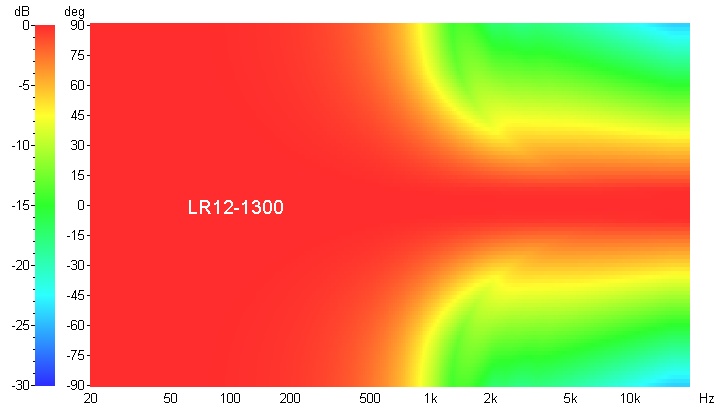

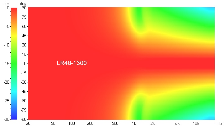

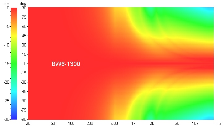

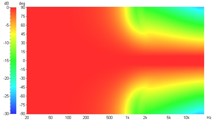

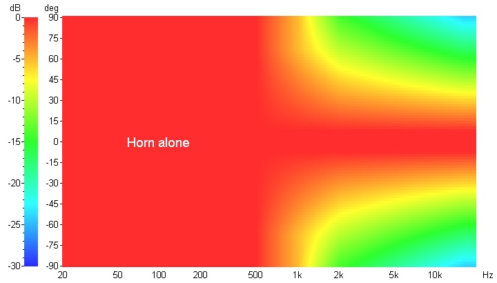

I had some time and curiosity got the best of me so I did some polar maps with crossovers (acoustic slope) from 6dB/oct to 96dB/oct. They're using a 15" woofer and the QSC 90x60 horn. I stuck with 1300Hz for all of them because there's a directivity mismatch there. Crossing lower would give smoother patterns but going too much lower would strain the tweeter on that horn. These are normalized to the on-axis response so they aren't showing the actual on-axis response of the drivers.
