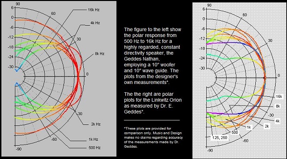

Yes, perception. But when I look at your contour map for the un-normalized Nathan the black line seems to indicates a pretty constant beam width of around 40 degrees at about -6dB. However, when I look at the polar plots at 1k, 2k, 4k and 8k what I see is not particularly uniformity with frequency. And at 8k Hz the polar response looks particularly unsettling with 3.2 dB peaking at 18 degree off axis relative to the on axis level. Normalizing the contours by the on axis response would certainly make the -6dB beam width look worse (more pinched in at some frequencies and wider at others). All of your designs seem to have a range between 5 and 10K where the polar response show depressed on axis response with some off axis peaking at about 15 to 20 degrees. Constant DI on axis, even if achieved, doesn't necessarily mean constant polar response. The prime example of this is a dipole and a cardioid. Both have the same on axis DI but the polar response is completely different.
Don't get me wrong, uniformity of the beam width is certainly better than most other designs I have seen, but I think uniformity of the polar response could be better. I am actually some what surprised that it isn't.
I'm also wondering if your Abby data might not have the same problem at the Orion data, at least on axis, since the tweeter level is depressed overall by about 6dB on average above 5k Hz. Seems strange to me. That just shouldn't sound right if true.

..In your value system, controlled directivity may be paramount..
I think that's the problem here that John was pointing out.
If you have +6db "bumps" in freq. response off-axis. Or a 3-4 db "hole" on-axis.
It isn't terribly well controlled directivity by ANY standard.
Even if the listening axis for the Nathan is 20 degrees off - that +6db "bump" around 8 kHz translates into about +4 db from the average. That is neither "controlled", nor is it "constant".
And that is disregarding the polar behavior at 1kHz and lower - where it's increasingly dissimilar.
How *anyone* could perceive any of the Gedlee designs as "constant" directivity is beyond me.
That of course does NOT mean that the design itself isn't good, as many people obviously like it, but rather that it does NOT live up to its marketing/engineering claims.

Back to topic. Isn't 1D polar directivity graph showing a very limited view of the generated soundfield - or only I can't interpret it? Why not show the generated 'soundfield' with a polar map?
Even big players in the pro prefer showing data with the 2D polar map.
That's good to hear especially since your data has now onto the bottom of JohnK's page...
The problem is that they are normalized to the axial response, which I have said over and over again is not a good thing to do and is especially wrong in the case where the listening axis IS NOT the normal axis. Further. showing only limited data, which I DO NOT do, is always prone to misleading interpretations (like here).

Presumably the data is not limited, but it is a different view. John's provided the view that most closely matches his own.. is that not fair?
..and speaking of fair..
This is your representation:
Nathan
Is it fair to use a 6db color gradation?
While you do have those areas that are problematic "circled" in white on the sonogram, does it really show the degree of difference from the average (for any axis)?
Looking at the accompany single axis freq. response (on your preferred axis), suggests a decent (neither good or bad) +/- 3 db across the average. BUT is that really what it is?
IMO you have purposefully chosen a sonogram "view" to highlight HIGHER losses in pressure to emphasize the design's most notable character/feature.
Further, the single axis freq. response doesn't adequately represent the average because:
1. The deviation*S* are *broad* - effectively spanning an octave.
2. It doesn't show that just 7.5 degrees off-axis that there is a fairly substantial change in sound pressure throughout the response. (..and as mentioned, this isn't obvious in the sonogram.)
Is any of that fair or honest?

Earl, I noticed that you posted rear-wave data for (only) the Orion. Do you believe this is an important metric? Regardless, I think it would be interesting to see the rear polar patterns of your loudspeakers displayed in your application. 🙂
Also, going back to your published Orion data... You previously mentioned that the data below 200Hz should be ignored (due to dipole interactions, I think). If this is the case, can you tell me why the LF data for the reverse side seems to be relatively flat down to 20Hz?
LspCAD does polar plots and polar maps, either as simulations or using real measurements. You can choose no normalization, normalize to the on-axis response or normalize to the strongest response. The angle spacing and frequency spacing can be whatever you have. LspCAD will figure it out and interpolate. The free demo version does everything except save files.
Edit: I like normalized plots so you you can see directivity directly. But to be fair to Earl's speakers where the design axis is ~22 degrees, I'd build a data file where the nominal 0 degrees in the file is really the ~22 degree measurement.
I will post some rear data at some point just to prove what I am about to say. There is nothing there. Above about 200 - 300 Hz, it's just all black, pretty uninteresting - once youv'e seen one youv'e seen them all. That's not at all the case of the Orion, which justifies the display of its rear radiation. It would also not be the case for a lot of other speakers, but it is certainly true of mine.
There is a technical reason for measuring the rear radiation (too technical for discussion here, but the bottom line is that the rear data can be used to better refine the forward data), so from now on I will most likely measure the full 180 degrees, but only in exceptional cases will I bother to show it - those cases where it is anything but totally predictable and uninteresting.
The data for the Orion below 200 Hz "could be good", but it "could be bad" as well. I just do not have any data or experince to know how well a near field patching works for a dipole. I have every reason to suspect that its wrong, but that doesn't mean that it is. In my data, I use nearffield data to refine a monopole model that fits that data set. Obviously this won't work for a dipole. But I did do a dipole fit on the model, but I wasn't happy with the results in that it was too sensitive. In general you have a good model when it is fairly insenitive to small changes in the parameters. That is the case with the monopole model. But the dipole proved to be more difficult.
So perhaps the rear LF response is accurate, and the front bad, or then again maybe its the other way arround.
