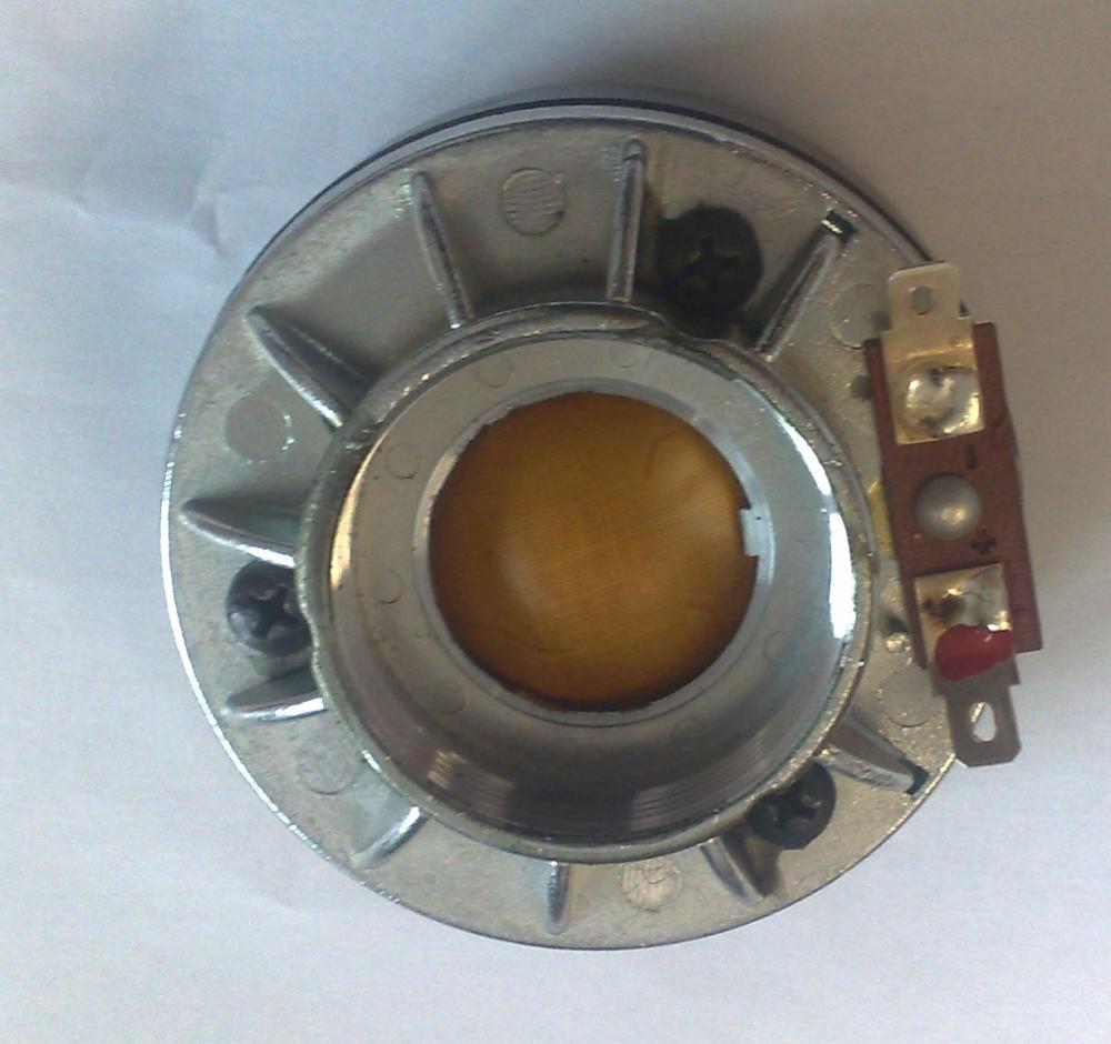

A friend of mine needs 6" EOSWG as a replacement for Klipsh tweeters:
Klipsch Tweeters | Critesspeakers.com
I'm collecting order list now. Throat is 1".

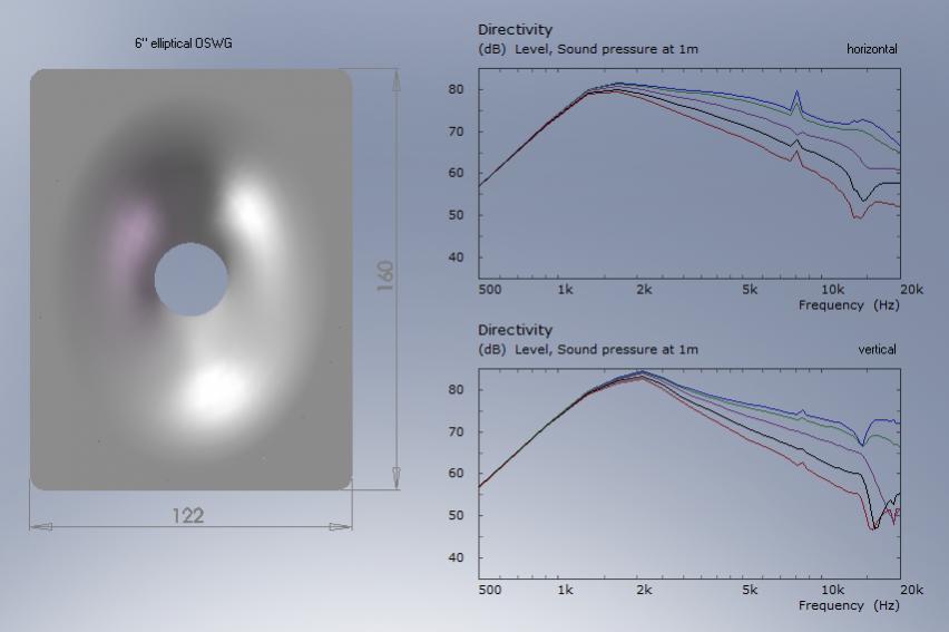

Does not look like the WG is doing anything
Why? Here is the same but normalized:
http://www.diyaudio.com/forums/multi-way/103872-geddes-waveguides-387.html#post2082665
(first from the top)

Could you plase explain what is shown in this grafic I cant read it?
Hello earl.
The X axis is frequency and the Y axis is angle. The colors designate the sound level in dB - each contour line is a 3 dB change. Red is the highest and purple the lowest level. This "map" shows how the sound is sent out from the loudspeaker in a single plane - horiziontal in this case, at all frequencies and all locations.
Read the paper on my site about polar maps http://www.gedlee.com/downloads/directivity.pdf. It explains what they are and what to look for.
So what you are saying Dr. Geddes is that JBL is just referring to the shape of the mouth?
They coined a term that sounded good. It doesn't have to mean anything.

These look like sims and the first one does seem to be doing somthing.
But here, if you are using AxiDriver to sim verical and horizontal angles independently, you will not get correct results simply because volume expansion.Why? Here is the same but normalized:
Characteristic of an OSWG is usually the curves closer to axis are more closely spaced than the curves further from axis. In the data of EOSWG you presented does not show this characteristic.A friend of mine needs 6" EOSWG as a replacement for Klipsh tweeters:
