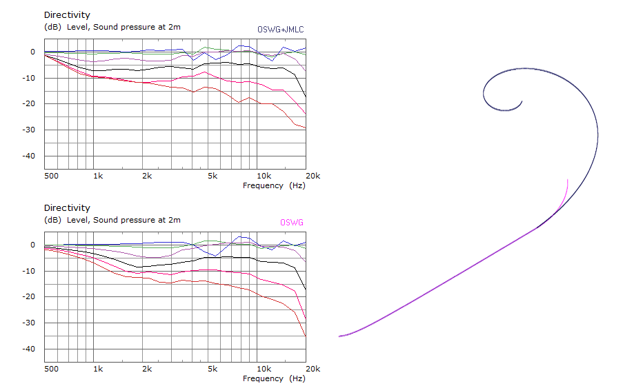

I beg to differ. It is reasonable and possible to fit a radius such that there is no discontinuity in surface curvature.
Yes, it is possible, but not with a constant radius flare of reasonable size. The curvature of the OS profile anywhere but close to the throat is rapidly approaching zero, or infinite radius of curvature. Patching a flare of constant radius and retaining reasonable overall diameter would necessarily cause a jump in curvature. That is why I asked about elliptic flares, log spirals and such.
Yes, of course, the angle of the walls and that of the baffle are different. There is always going to be a change in slope and there will always be diffracation. The more gradual this change in slope the less diffraction that occurs. Its not complicated, but its change in slope that matters (curvature), not change in curvature.

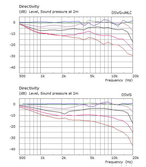

Thats a classic example of a bad comparison. Why doesn't the OSWG take up as much space as the other one? Put a larger radius on a larger waveguide such that they are both the same size (length and diameter) and then do the comparison. Size is always an advantage and its not fair to compare to devices that are different sizes.
More reasonable - thanks. These are simulations right? Was the OSWG in a flat baffle as it should be?

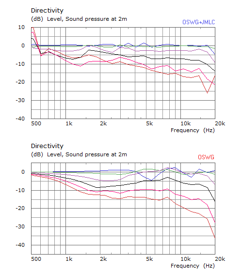

From my own experience, AxiDriver does not simulate free standing horn/guides very well. The directivity of baffled response is much closer to free standing measurements as I have shown previously in this thread.Comparison between pure OSWG and OSWG+JMLC hybride.
Thanks for clarification. I simulate OSWG in an infinite baffle and JMLC in a finite baffle. It is very easy to correct diffraction in OSWG with JMLC profile. Exchanging the lips isn't sufficient.
But the directivity control isn't nearly as good.

What you say is true. However, we must not forget that the energy of backreflection is proportional to the radiated energy around the lip. As I show here, an OSWG with the kind of lip I explained before produces less energy radiated on the sides, thus the backreflection is also reduced.
http://www.diyaudio.com/forums/multi-way/103872-geddes-waveguides-404.html#post2101785
If we consider the Le Cléac'h expansion using similar dimensions, the side energy might be much higher, and thus the lip rollback might be more critical. So whether lip rollback is critical or not depends on the actual design.
