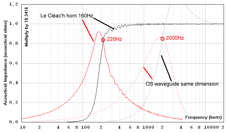

IMHO there is another method to determine the cut-off: we can call acoustical cut-off the frequency below which the resistive part of the acoustic impedance becomes smaller than the reactive part of the acoustic impedance.
See attached file with comparison betwwen the such defined cut-off for a Le Cléac'h horn (Fc = 160Hz) and an OSwaveguide of the same dimension. (Resistive part of the acoustic impedance = black. Reactive part of the acoustic impedance = red)
This is a very important indication for us as this is the lower frequency for which phase distortion (and GD variation) will be negligeible. (but this will obviously lead to flamed replies)

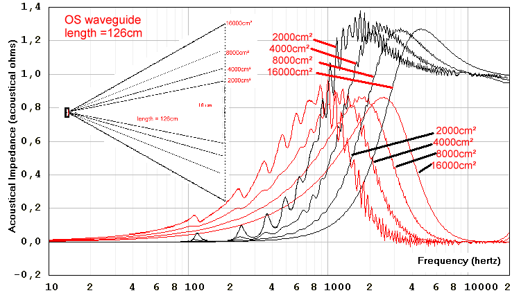

I would really like to see an example of such an OS waveguide having a cut-off Fc as I define (the frequency above which acoustic resistance becomes larger than acoustic reactance) lower than 1000Hz.
Here is attached simulations performed using Hornresp for four different OS waveguides having the same length (126cm which is the length for the chosen 1 inch driver of my Le Cléac'h 160Hz horn , T = 0.8). The mouth area of the OSwaveguide are respectively 2000cm², 4000cm², 8000cm² and 16000cm².
The lowest cut off obtained with those four OS waveguides is around 1000Hz which is very far above the Fc = 200Hz obtained with the Le Cléac'h horn having the same length
May be I am doing something wrong but I would know what!

an OS can have any cutoff that is desired, just like any other horn or waveguide.

Jean-Michel
You are doing something wrong, but I have neither the time nor the patience to argue the point with you.
