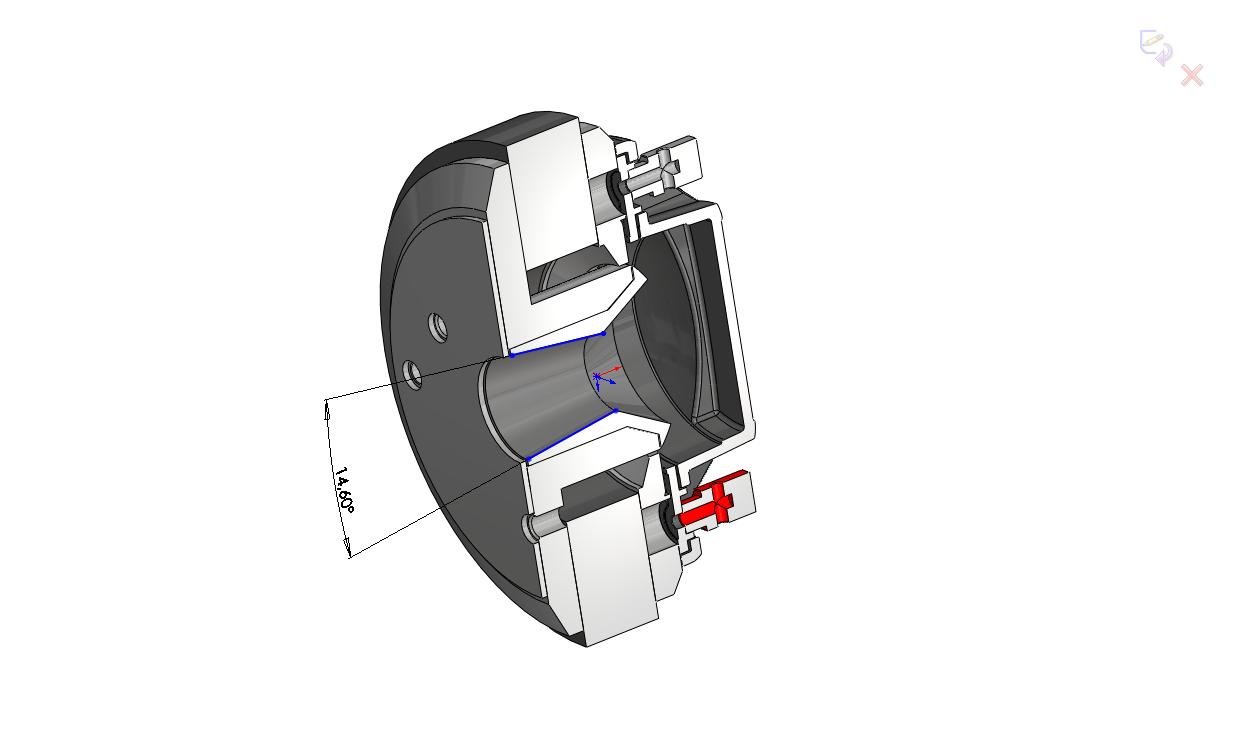

Wasn't it posted in 3578? Looking back I believe that you may be correct and that I misundertood. It was the profile in 3578 that I was refering to and this may not be the same one as in the other speakers being talked about.
I'll admit to not paying very close attention. Until some real data is shown, as promised, its just another speaker with no data and a few casual and uncontrolled listening tests.
I think the horn in 3578 is supposed to be an OS flair with the taper at the throat left on the horn so it can be cut off at exactly the correct size to mate up to the exit flair of a compression driver. So if that point is at the tangent of the conical section and OS section, then it would be an OS flair from the entry of the horn out to the mouth (assuming it's an OS profile, but it looks like it). I don't think it's meant to be a diffraction horn with a radius at the break in the flair.
I can't tell what the other horn being discussed is (in 3595, for example).
A little explanation to profile 3578 - basically it's an OS waveguide for B&C DE250. It has OS contour down to 1", where it has 14.6 deg full wall angle and then it continues with conical section (14.6 deg). This way it is possible to attach the driver preciselly accounting the production tolerances, etc.
I'm doing a lot of assuming, but I don't think one size fits all was the intent. I think the manufacturing process doesn't all them to mold an exact size throat, so they are leaving that conical section on there and then trimming it to be an exact size, but there is only one size intended.
Thats a lot of extension, and a pretty big tollerance, if that was the intent. I do something like that on my waveguides, but I only end up needing maybe 1/16".
I think the true throat is in the driver, this is the most critical part of the design. Any change in flare after than acts like any other diffraction horn. The long 14deg flare howers the horn extension frequency which would be evident in any AxiDriver sim if modelled to the true physical diaphragm location. So it seems the horn loading may not be optimum, thus the image focus can be lost in the mid frequencies probably below 2KHz based on an educated guess. I would expect this to be evident when the data with proper CSD resolution is shown.
