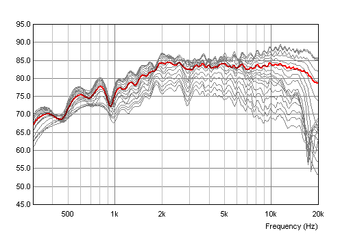

If I could suggest, I would like to see the polar responses from the axis out to 90 degrees in 7.5 degree (or less) increments. Sorry 10 or 15 degrees is too coarse. The data can be smoothed, but no more than 1/6 octave. A full set of data taken with HolmImpulse would be great! Impulse responses every 7.5 degrees, export 8500 data points (-200 to 8300) to a single file and post that. Then we can all see the performance in a manner completely consistant with what I post for my speakers.
We need to see the full system, not just the waveguide. If you want to take some vertical polars would be good as well, but I'll understand if those are difficult to do as I have difficulty with this as well. I can, and do, take verticals +- 15 degrees, but thats all I can get from my setup.
Don't know if the have a twister for that monster. Simu says it is CD. Distance at least 2 meters? Here's my measurement on Seas tweeter, 5 deg step. Is it ok?
5 degrees does tend to be a little dense as your plot shows. I find 7.5 to be about right, but I'd prefer 5 degrees to 10 degrees. Scale should be no greater than 50 dB. And a full system plot, not just the tweeter, is necessary to draw any opinions from.

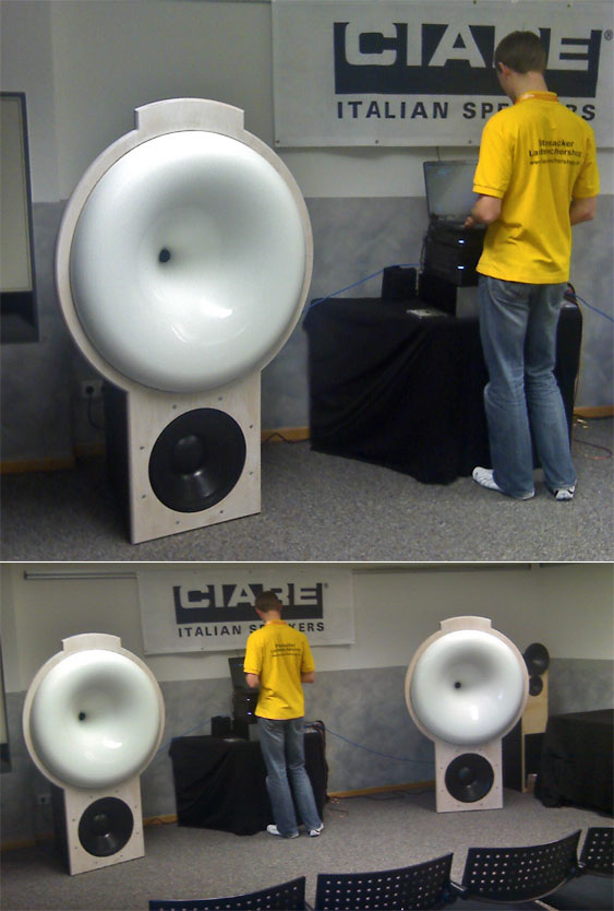

Hello,
http://www.diyaudio.com/forums/atta...258814376-geddes-waveguides-gelsenkirchen.jpg
For such mouth diameter Le Cléac'h horns are deeper (at least if T <1).
For what it seems to me this horn/waveguide is the result of a strange genome coupling between an OSwaveguide at the throat and a Le Cléac'h horn at the mouth.

I thought those horns had a Leclerq contour and that contour is well know to not be CD. Looking back at the photos, its impossible to tell what the contour is.
Min Phase Horn
Ui, ui ui calm down guys!
The discussion point of "constant directivity" or "true constant directivity" is a widely mute one as I also pointed out in my paper:
Dipole Horn, Dipole Directivity Control Device
Hence I call my designs "min phase" horns – to clearly state where they are heading (rather than how perfectly they meet the goal)!
No "Gedlec" nor "Leclerq" nor " Le Lee" or whatever malapropism – please do me a favour and stay with the name *I* gave it for some good reason – its simply a "Min Phase Horn" .
You are right Jean-Michel – its not exactly a LeCleach contour.
Though I use your contour (and subsequent philosophy about wave front propagation) as a basis for my calculation due to their inherent consistency and smoothness that shows up in any directivity sonogram I've done so far – and no – there definitely is *no* oblade spheroide mixed in.
Its a grain of *Gaussian* ingredient I use.
Yes. I have done simus for that very contour - but I will not share for the simple reason that no one knows what *exactly* the wave front shape is, that's injected into a horn's throat.
The flare of the compression driver exactly tells us *nothing* in this context – a rough guess at best...
And no – Earl – I wouldn't even trust your measurements you claim to have done in this department, as you clearly have failed to stay clear about the nature of wave fronts in general.
So, I'd also suggest to patiently await measurements and hope for someone to have the time and guts to find out what's needed to let min phase contour shine.

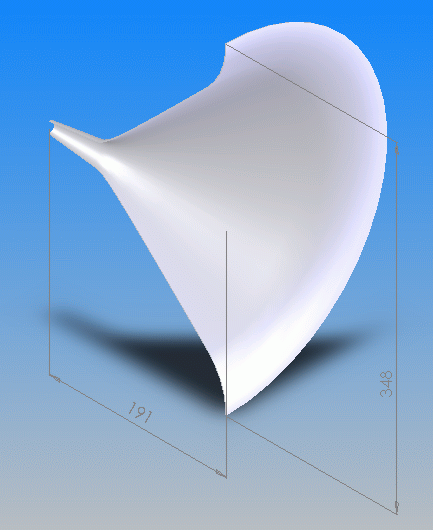

We are ready to ship 12" OS waveguides, one piece no more than ~90€ or ~130$.
Hello Jzagaja,
That looks very interesting! Could you post some pictures of an actual device? For which opening angle of the compression drives was the contour calculated?
