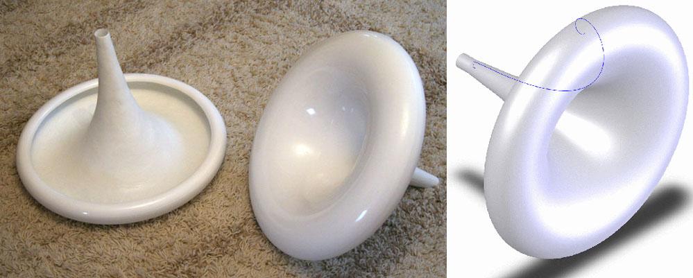

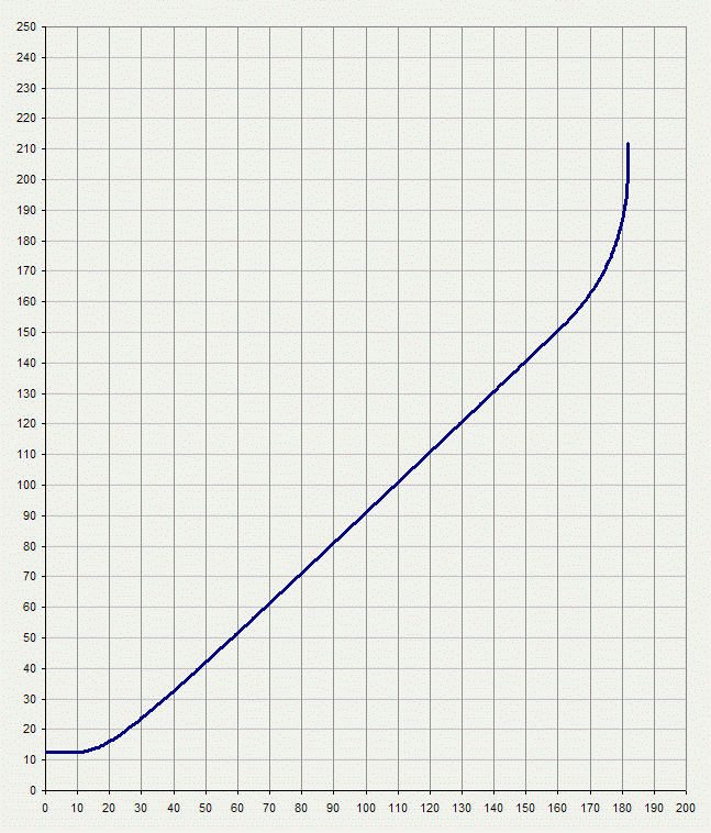

Made of polyester resin (white/green/blue/yellow). We had a client who wanted carbon fiber large horn, no problem. Cost only when exact drawing is supplied. What about drawing several cross sections in 3D app. with leading spline and morph circular shape to an ellipsoidal?

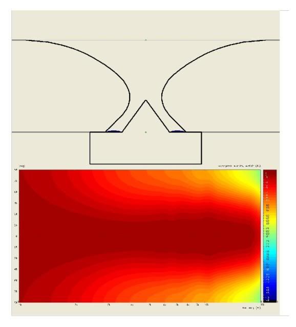

btw, somewhere theres a simulation of OS with optimised longer throath transistion, very smooth
I think it was soongsc
The OS throat is what's necessary to widen the beam at the top frequencies. However, the flare shape can significantly influence the smoothness of the overall response. In sims, the part from the diaphragm to the throat seems to have effect in almost anywhere in the operation range of the horned/driver.
