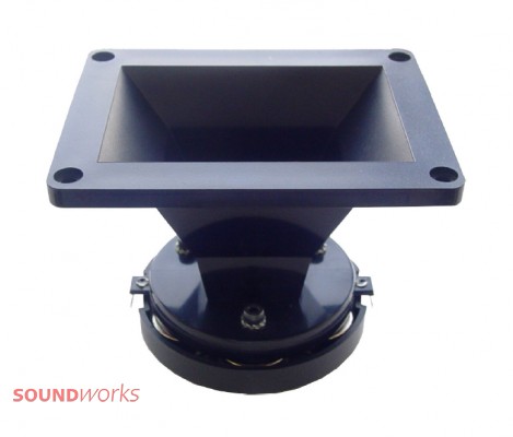

100db soft dome, a new Beyma?
http://www.beyma.de/fileadmin/seiten/download/pdf/Beyma_professional/2007-M_rz-SMC2012N_1_.pdf
45EUR btw
Might be easily DIY improved with a roundover mouth 🙂
If its possible to take off the horn it might be easy to improve it
Though it looks like the front poleplate is integrated part of horn
