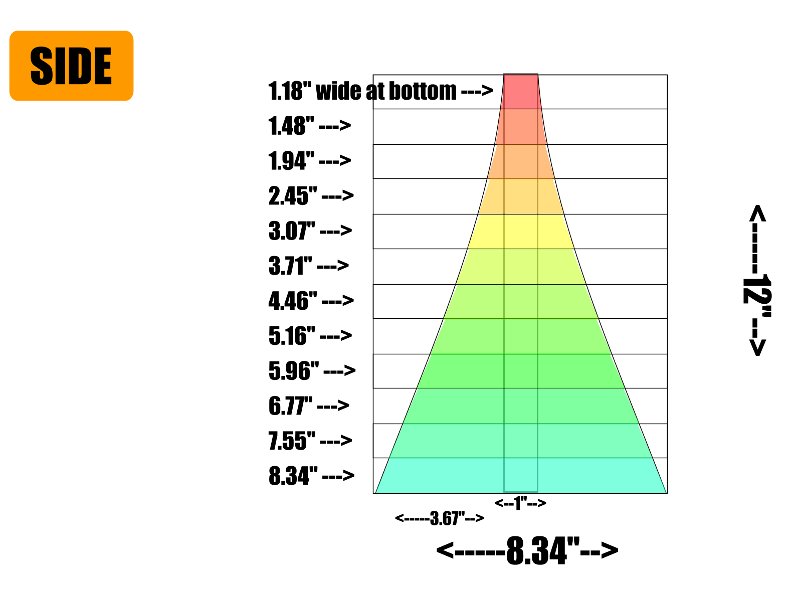

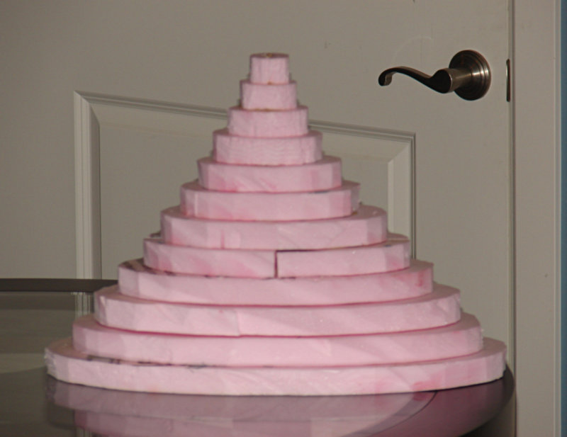

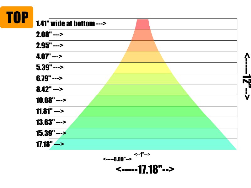

Hi Patrick,
The mold looks cool.
Say, for maintaining the control on both H and V directions, do they have to be the same length along the inner surface from throat to mouth?
I mean, in a circular WG, it's symmetrical in all directions and identical length from throat to everywhere on mouth. In this elliptical WG (or any other horns with elliptical exits), the distance from throat to V sides is shorter than to H sides. So I imagine the wavefront 'escapes' the mouth earilier on the V and later on the H.
How would this affect the directivity control or sound characters? Or, would it need some kind of longer 'lips' on the V sides?

CLS said:Hi Patrick,
As I understand it, the angle of a waveguide simply controls the coverage pattern. So if you have flat sides and a constant coverage angle, all the little pieces fall into place.
IE, you get smooth polar response that doesn't jump around at different frequencies.
So I haven't spent a lot of time wondering how the wavefront behaves, I just know that it measures well. I *did* spend a few hours trying to wrap my brain around a bispheroidal waveguide, which Geddes recommended a few years back, but didn't want to hassle with a mold that complex. (A bispheroidal WG looks like a figure eight.)
In the thread that I referenced, I did polar measurements of a 108x72 degree OS waveguide, and it was very smooth. Another "waveguide" that I built was not.
I started building this new mold because I need a tighter pattern, 108 degrees is too wide.

I posted plans for an elliptical waveguide over on my Unity thread. Instead of oblate spheroidal or conical, it uses a bezier curve between the throat and the mouth. Based on an article I read, that's supposed to provide a gentler transition between the coverage angle at the throat and the mouth. Basically it has fewer abrupt changes in directivity, like what you see at the throat and the mouth in a lot of waveguides. Here's a few pics:
Hey John
Are you using polyurethane boards now? Thats what they look like.

Hey John
According to this site here, it's called "xps foam."
http://www.8linx.com/cnc/day5.htm
There are some neat pictures of how it can be cut using a PC:
I cut it using a table saw, not a hot wire. Goes through like a hot knife through butter.
I've made molds using comic book backing boards, plywood, and foam. Wood is a hassle; takes waaaaaaaay too long to build up the layers.
