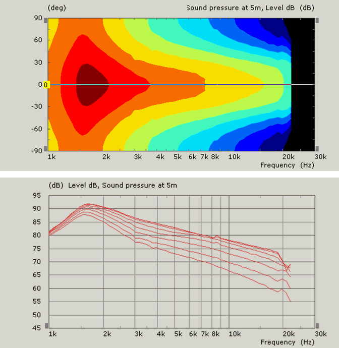

This seems like it's going to be my next test. Based on the BEM sims, the curves look smooth, quite constant directivity, no complicated intersecting between the SPL lines at different angles. Bassed on the sims of previous configurations, this sim should not be too far off. Pretty hard to describe what curve this is because it started out with an OS expansion throat, but after pulling the lines around in the CAD program and looking at the results, I don't really know what to call it, but it looks somewhat like an AX2 from the pictures I can see.

That is very good, almost too good to be true. Its a simulation right? Is there a mouth?

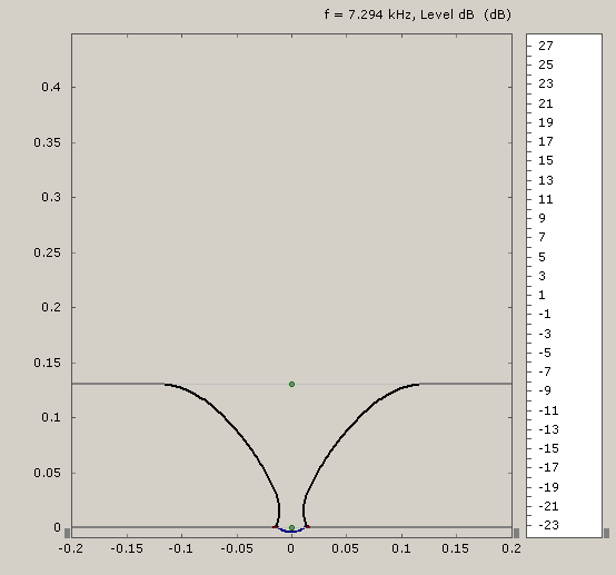

Yes, this is still a simulation. There is also a mouth in the simulation. I tried to get the geometry of the driver as close to the real thing as the software would allow. Since the software assumes the diaphragm a rigid body, it does not show the breakup modes.gedlee said:
Please, show your waveguide curves 😉
