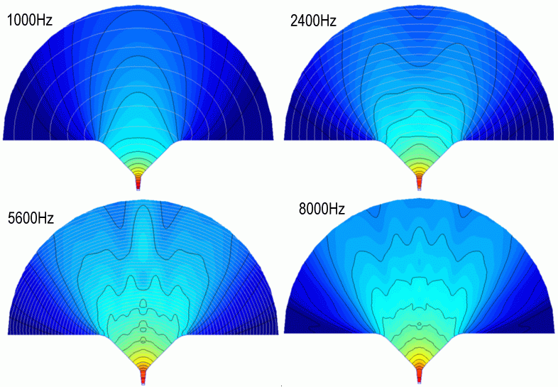

Hello,
In a previous message Earl Geddes published a smooth soundfield map simulation for his OSwaveguide.
http://www.diyaudio.com/forums/attachment.php?s=&postid=1754191&stamp=1235402217
We don't know at which frequency - a probably low frequency- it has been obtained and as Tiki wrote in his message:
http://www.diyaudio.com/forums/showthread.php?postid=1753250#post1753250
"several horns look good up to 1kHz in Hornresponse. One should try higher frequencies to separate the wheat from the chaff. "
Recently, long term very precise BEM simulations of OS waveguide and Le Cléac'h horn has been perfomed by Bjørn Kolbrek at different frequencies.
I assembly 4 soundfield maps obtained by Bjørn Kolbrek for the OS waveguide (mounted on a modelized compression driver) in a single graph. To be attached to this message the resolution of the maps has been largely reduced but I think the essential of them has been preserved.
We can see that the smoothness of Earl geddes simulation is verified at 1000Hz but when the frequency rises the sound field show important perturbation.
Best regards from Paris, France.
Jean-Michel Le Cléac'h
(thanks to Bjørn Kolbrek to allow me to publish the results of his BEM simulations)

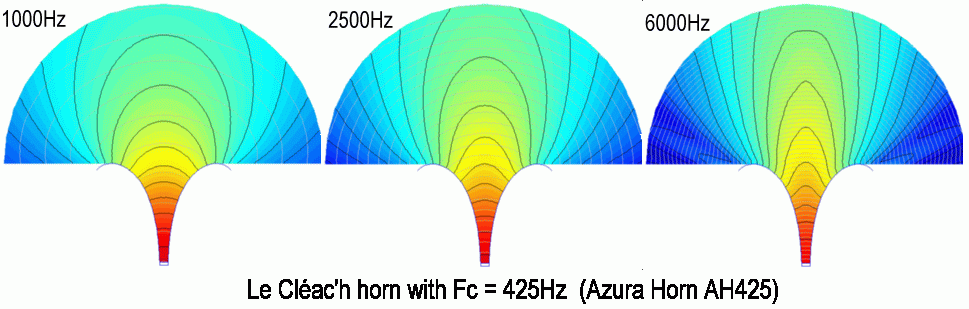

hello,
You'll find in attached files soundfield maps obtained by Bjørn Kolbrek on a Le Cléac'h horn (Azura horn AH425 mounted on a modelized Altec 288 compression driver) at different frequencies, in order to be compared to the soundfield maps obtained for the OS waveguide.
As for the OSwaveguide BEM sound field maps, the resolution of the maps for the AH425 horn has been reduced but I think the essential of them has been preserved.

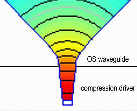

Hello Klaus,
You'll find a magnification of the throat part of the OS waveguide mounted on a compression driver.
For what I can judge, in the limits due to the precision of the drawing, the compression driver ensures a plane wavefront at the throat of the waveguide.
So we can admit that the OS waveguide should operate at its best in those BEM simulations.

My opinion is that these simulations clearly show the superior directivity control for the OS device. As I have said over and over, Jean Michel keeps trying to compare a beaming horn with a CD waveguide. That doesn't work for me. When he has a CD horn with comparable directivity then I'll be interested. His contour fails the single most important aspect of a waveguide and that is directivity control. It doesn't meet the objectives and as such isn't worth considering.
But I do think that the throat in those models does not look right. Why isn't the driver throat on the Le Cléac'h horn?
And why is the Le Cléac'h horn terminated in a baffle when that is not what is done in practice?
All in all I find this a pointless study which is designed to be misleading and not instructive. Quite typical. Nearfield efects are not whats important, its the far field polar pattern that counts - the Le Cléac'h horn will fail that test. And there is no foam in the OS simulation.
Pretty pictures, but not very useful for a real world device.

Earl wrote:
"Why isn't the driver throat on the Le Cléac'h horn?"
It is. The angle of the throat of the driver is exactly the same as the throat angle of the AH425. This render difficult to locate the driver throat.
Earl,
Could you please show an example of what it should look like? I don't have the intuition to see when a waveguide throat looks right or not, I just draw the contour from the equations and expect it to be correct.
The AH-425 is NOT mounted in a baffle. If it had been, the amplitude contours would have met the baffle at right angles. The grey lines are isophase contours spaced 90 degrees apart, btw. The blue horn contour is the entire boundary of the simulation, which is done by the Shell Element Method, the code can be found here. I have compared it to other BEM implementations, and it works very well.
It was not, at least not on my part. The simulations were run at different times, out of curiosity on how the field inside these two devices would look like. I tried to make them as realistic as possible.
Doesn't the nearfield determines what the far field look like?
And as I have said before, I have no idea on how to implement that in BEM. Suggestions?
Best regards,
Bjørn

From your perspective of trying to do models and learning how to simulate horns and waveguides I find your work highly respectable. But for Jean-Michel to compare a directional horn to a CD waveguide is pointless - he did that not you, I hope that you know better.
For the throat, I would need a far more detailed look at the curves down into the throat. It was not possible to tell from what was posted what those details were.
As to the nearfield to farfield, the nearfield does determine the farfield, but not everything seen in the nearfield will propagate to the farfield. For example do a run of a piston or cone in a baffle in the near field and then compare it to the farfield. You will see that many details seen in the nearfield do not propagate to the far field. The farfield tends to be an average of the nearfield where the details as washed out. Much of the fine structure that you show for the OS waveguide will NOT propagate to the farfield. These effects are called Evanescent Waves and they are "complex" (in the mathematical sense) and have wavefunctions that are real exponentials - they dampen out exponentially with propagation.
All this said I do not doubt for a minute that the fine structure that you show is real or close to real. Constant Directivity (CD) does not come without its costs. There is a price to be paid to achieve it and that price is a certain level of diffraction and HOM. Did you get these exactly right? I don't know, to me it doesn't really matter. I have always said that they were there just as I have said that you can't get CD without them. But CD is the more important (indeed most important) aspect of a waveguide. If people haven't gotten that from reading my work then they have missed the whole point. If a fine structure and some HOM are the price to be paid for true CD then I will gladly pay it!!
What Jean-Michel has shown is not new. Smooth contour horns can have smooth results as shown, BUT THEY ARE NOT CD. That and that alone is the whole point.
