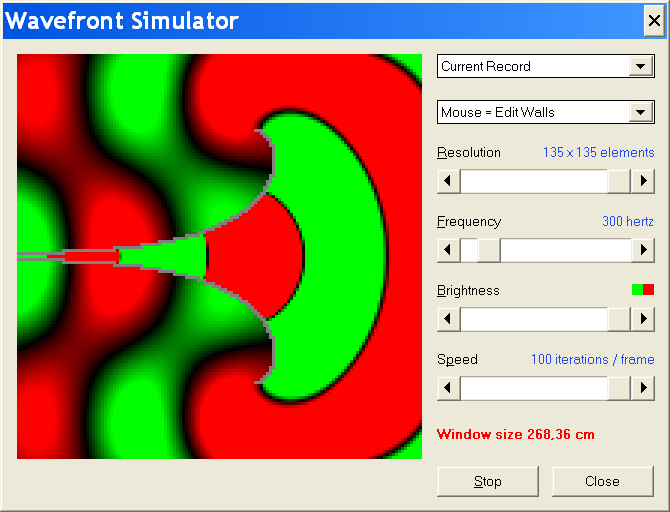

"Here is a compared wavefronts simulation between conical and Le Cléac'h horn of the same size at 1kHz."
That seems like a flawed comparison - the cone has no mouth radius.
The other is interesting in that it seems to suggest that there's benefit to continuing the mouth radius past 90 deg.
Would it be possible to show both profiles terminated with a large radius into the baffle plane?
Looking closer at the scale of the horns that Jean-Michel had presented, it seems the horns are quite large, about 1.2M+. What would happen when the wave length is close to the length of the horn, mouth curvature effects, etc.
Hornresp is a neat program, but it's really not implemented to explore these effects with the flexibility necessary.

Hello Timo,
For the Le Cléac'h horn, the results obtained with Hornresp fit quite good with the ones obtained with long duration BEM simulations.
I cannot see why it should be useful to simulate the wavefront at 10kHz of a Le Cléac'h horn having a 160Hz or 320Hz acoustic cut-off frequency...
But what is sure is that a conical horn is bad at every frequency when it comes to the point of the pressure field (and not only inside the conical horn).
Then, for a waveguide a large radius at the mouth solves partially (only partially) the effect of mouth diffraction but have no or very few effect on the HOMs created near the throat in the zone of rapide curvature. That was clear on the pressure field map from your simulation (and from other BEM simulations I could see).

Hello Soongsc,
The horn in the simulation you mentionned had a 160Hz cut-off (as the original Azura Horn built by Martin Seddon).
You asked what will happen for a frequency the wavelength will be similar to the horn length (1.2m), this means a frequency around 290Hz.
You'll find in attached file a graph obtained with Hornresp's wavefronts simulator of that horn at a frequency of 300Hz.

A conical horn has no curvature. HOM can only be created at the throat (most likely) or at the mouth (still likely).
Hello Ear
Sorry if my last message lead you to think that I mix conical horn and waveguide but no.
The waveguide part of my message was related to Tiki's simulation (an OS waveguide with large radius curved mouth).
In that simulation (as you confirmed) the lobes in the sound radiations could be due to Homs. As the mouth is curved, one could think that those Homs are generated in the rapid curvature change part near the throat of the OS waveguide (a feature you once described in one of your message).
In a Le Cléac'h horn, near the throat, such rapid curvature change doesn't exist and this could be one reason why less Homs are generated.
Jmmlc said:Hello Ear
Is the "l" on your keyboard broke?
This is no proof that with your curvature "less Homs are generated" than in an OS, in fact I would expect the exact opposite. HOMs don't cause "lobes" and in fact they are usually small enough that they have little to no effect on the radiation pattern - this was proven by Gottfried Behler at Achen. His mistake was assuming that because they had no significant polar effect that they were not an issue. But a small polar effect does not always mean a small subjective effect.
You keep trying to elevate the improtance of your contour, but the fact remains that it is not CD. Until you have a contour that is CD it is meaningless to compare it to one that is.

It seems that even before the cut-off frequency, the directivity widens. Also, it seems with the conical horn simulation, the HOMs are generated by the mouth if the throat conditions are ideal and the wave length is significantly smaller than the length of the horn/guide. With the two wave guides I have, the larger one has more honk to it even though it has an elliptical cross section at the mouth. The smaller one seems to have less honk.
With the Le Cléac'h horn, less HOM's are generated from the throat, and the expansion is such a way that HOMs do not have a chance to form until probably at very high frequencies due to the short fast flare. I somehow get a feeling that throat flare can be widened to a certain point before HOMs start becoming significant. So how to have a good directivity control without introducing lots of HOMs will require two different flare equations for the throat and mouth. This is currently what I hope to discover. I certainly wish Hornresp had the capability to do this.
I am curious as to what it would be like if the horn/guide cut-off frequency, driver cut-off frequency, and directivity controlled frequency were all pretty much the same.
It will be a few more days till I actually do any measurements. Hope to train my ears to see if my ears hear certain things that I might see in the data.

This is completely false. The HOM that are generated at the throat depend on how the driver connects to the device. In those sims the source was a point source which will generate lots of HOM in any device. But the longer and straighter the throat (in any sim where the source is not a plane wave) the less diffraction there will be at lower freqs. A straight tube will not have any. After looking at the sims they are completely inaccurate at higher freqs (the only place where waveguides do much of anything)because only a point source at the throat is possible. Don't judge anything based on those simple examples.

That reference that you quoted uses Webster's Equation which cannot predict or analyze HOM. You really need to read up on the current concepts.
gedlee said:Turns out that the sim can do a sort of plane wave and when correctly done here is what I get:
Note that there are no HOMs. The wavefront are as smooth as could ever be expected.
Is that a 90 degree waveguide? Can you provide the input parameters for the simulation so we can study how changes effect the wavefront? That is as smooth as could be desired. Thanks.

See attached
