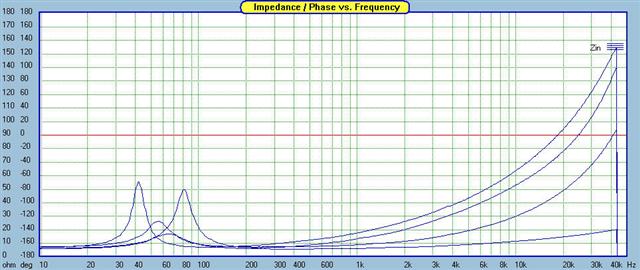

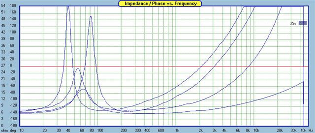

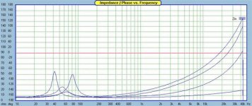

Here are two 4" and two 6"driver impedances. Other than inductance and F0 etc. What is special?tiki said:Hello,
compare the 4" to 6" wavecor drivers, you will find interesting similarities in amplitude and impedance responses.
It is not only a matter of size unfortunately.
And zoomed in. Are you referring to that little wriggles in the 1K~2K Hz range¡Hsoongsc said:

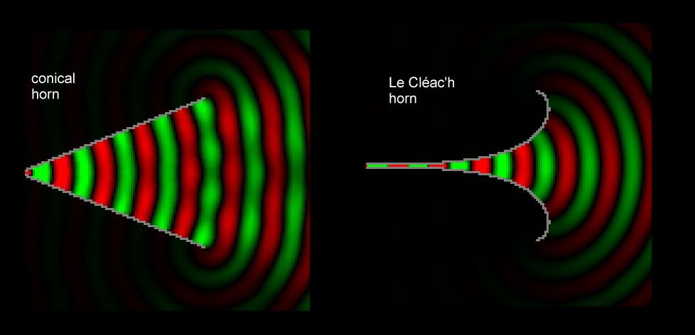

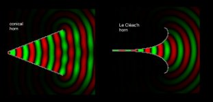

Hello Tiki,
Here is a compared wavefronts simulation between conical and Le Cléac'h horn of the same size at 1kHz.
Best regards from Paris, France
Jean-Michel Le Cléac'h
Hello Tiki,
Hello,
soongsc, yes, these little artifacts, while they are much more significant in most (serious) measurements. The bigger the driver, the lower the frequency of the artifacts. Same spiders (and surrounds) generate very similar artifacts in different drivers.

Jean-Michel,
merci beaucoup. Hmm, that looks good, indeed. I have to read a bit about these horns, because I want to realise approximately constant directivity fom 1kHz up at least. Le Cléac'h horns aren't CD, are they?
I was told to find a function for which the distribution of the speed of sound across the mouth is similar to a Gauss function, using a 2dim FFT. But my math abilities are awful. I'm not able to synthesise that.
Is the very long throat really needed?
Regards

tiki,
I think that little wriggle in the impedance curve reduces if the cone weight reduces. Also, if the spider is a progressive spider, it should also be reduced.
