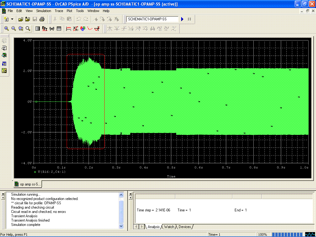

From my simulation result at high frequency (20kHz), I found something strange as two attached pics, result1 indicates overall of output signal, result2 indicates only red region in result1. I have no idea for this case. Could anyone tell me how to solve this problem?
Looks like oscillation. Think in terms of RC networks to ground
at the outputs of the chips, and throwing away some of the
gain in the chips using voltage dividers on their + inputs and
greater gain loops into their - inputs.

Although nar's suggestion does reduce the open loop gain, to eliminate the stability problem in this design requires the gain to be reduced after the differentail pair and before the opamp. This is achieved by increasing the ratio of resistance of R1:R13 and R23:R17 in your schematic (i.e. increasing the values of R1 and R23 to 10k throws away 6dB open loop gain).
