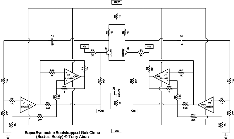

For your consideration, here is my initial attempt at implementing Nelson's circuit topology presented at the begginning of this thread. I have incorporated an additional element, which is bootstrapping the op-amps to provide greater current delivery into lower impedance loads. I have simulated it in Spice, and it appears at first glance to be stable, with the exception of signals above 200kHz.
I am hoping over the next few weeks to prototype it and see how it performs. In the meantime, any suggestions on improvements are welcome.
Terry
P.S. Sorry about the image quality, I couldn't get it too accept a larger image size.
Terry

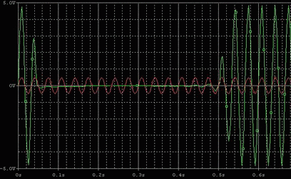

I got the results from the circuit
I tried to simulate the circuit by Pspice and found that at high frequency sinusoidal input signal (about 10k-20kHz), the result indicated me high frequency noise interfered with the input signal which I put a filter to remove it. After output signal passed that filter, that noise could be removed out from the output signal 😀. However, I found something's strange when low frequency sinusoidal signal is supplied through the circuit as below attached file.
Gencard,
Thanks for the response. I had noticed the high frequency issue, but the low frequency one I missed. I'll have to fiddle with it some more and see where it is coming from. Hmmm.......

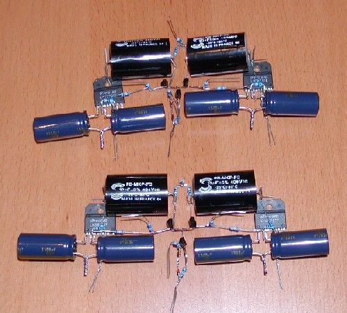

Progress, slow but certain!
Finally got around to putting something together. Have the two channels finished, now to connect up a power supply, input and output connectors.
